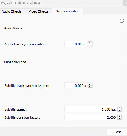

Use VLC player to find the correct delay (Tools, Track synchronization).

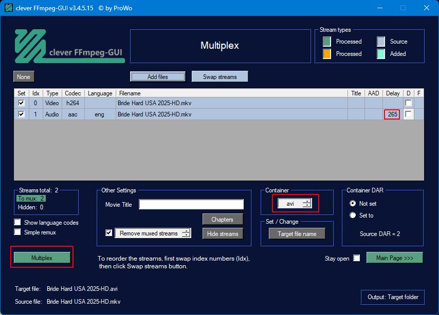

Once you have found the correct value, use clever FFmpeg-GUI to remux your AVI file with this value.
(Main page, multiplex, insert the found value in the delay column of the audiostream, set avi as container, click multiplex. Done).

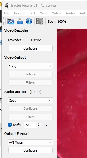

AVIDemux should do it. Use the audio "shift". Set it up like this (adjusting the shift as necessary, of course); note Video>Copy, Audio>Copy, Output Format AVIMuxer:
[Attachment 88701 - Click to enlarge]
You can only change the shift value with the video stopped ie not playing. -

I dont have a clue how to do all this at all Im a newbie I did the tools thing
[Attachment 88702 - Click to enlarge] -
Just do a File>Save. It works here.just tried -500 saved while it was paused but its still same

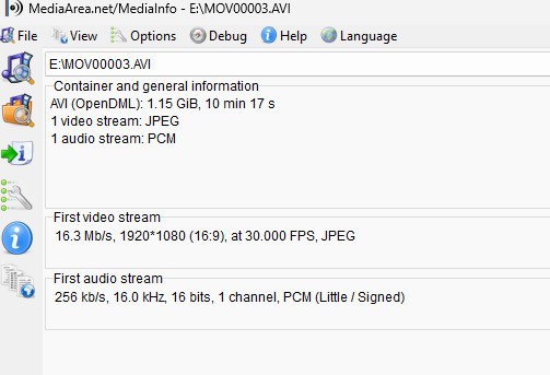

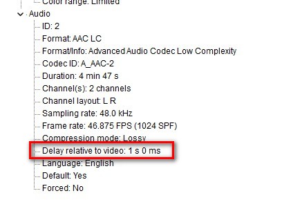

Here's the MediaInfo readout of the delay I saved in my file:
[Attachment 88704 - Click to enlarge] -
[Attachment 88705 - Click to enlarge]
its still well out of sync no differentLast edited by natty; 13th Sep 2025 at 08:31.

Well at last I have fixed it, 1st I used VLC player and the Track Synchronization by pressing K & J and kept putting a minus value, until it was where I pressed my bike horn to a friend I saw on way. in the end it was -18500 which i added to AviDemux saved movie clip and now when I passed my friend I can hear me sounding the horn.

With clever FFmpeg-GUI.
To extract the audiostream:
Load your avi, click main page, click extract streams, select the audiostream only, click extract. Done.
To add the new audiostream:
Load your avi, click main page, click muliplex. Drag your new audiostream into the datagrid.
On the left, select it, select the videostream too, deselect the original audiostream (shown in in blue).
Set avi as container, click multiplex. Done.Last edited by ProWo; 15th Sep 2025 at 07:35.
