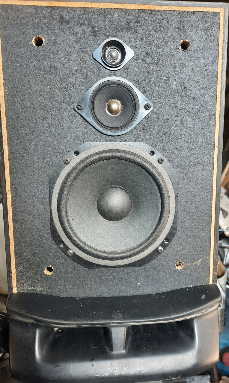

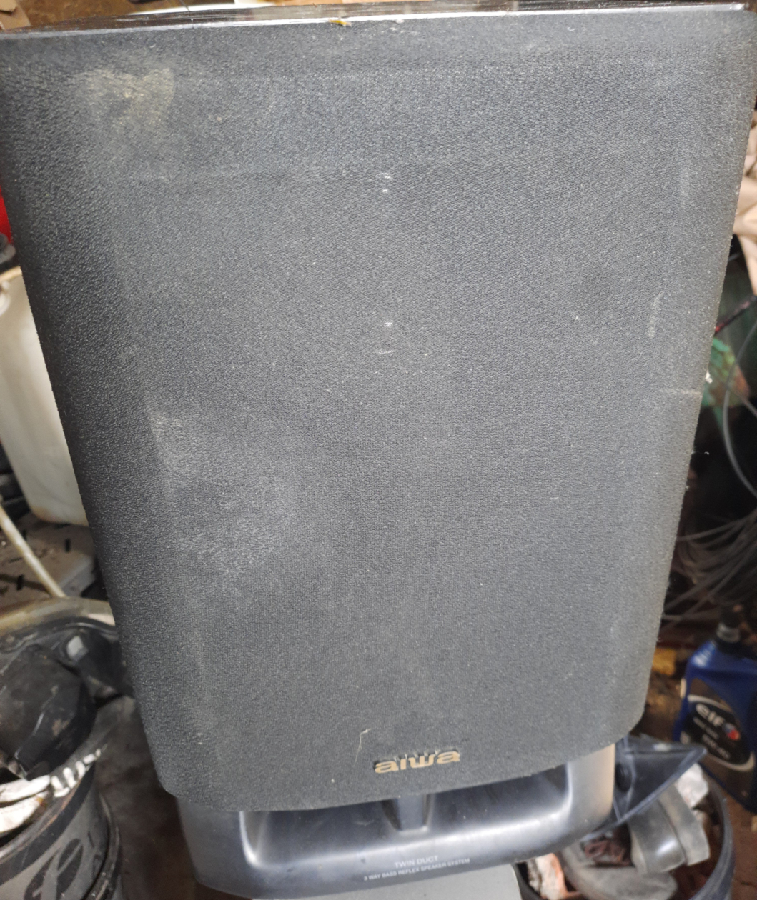

    Hi everyone
    Im trying to re-use a pair of speakers from an old AIWA System, probably making 2 portable speakers with a bluetooth/mp3/usb amplifier powered by a couple of 18650 batteries but ive been unable to find some info about the speakers, from the reference on the speaker ive found out it belonged to the AIWA z-2300 stereo system and found the following on the manual online:

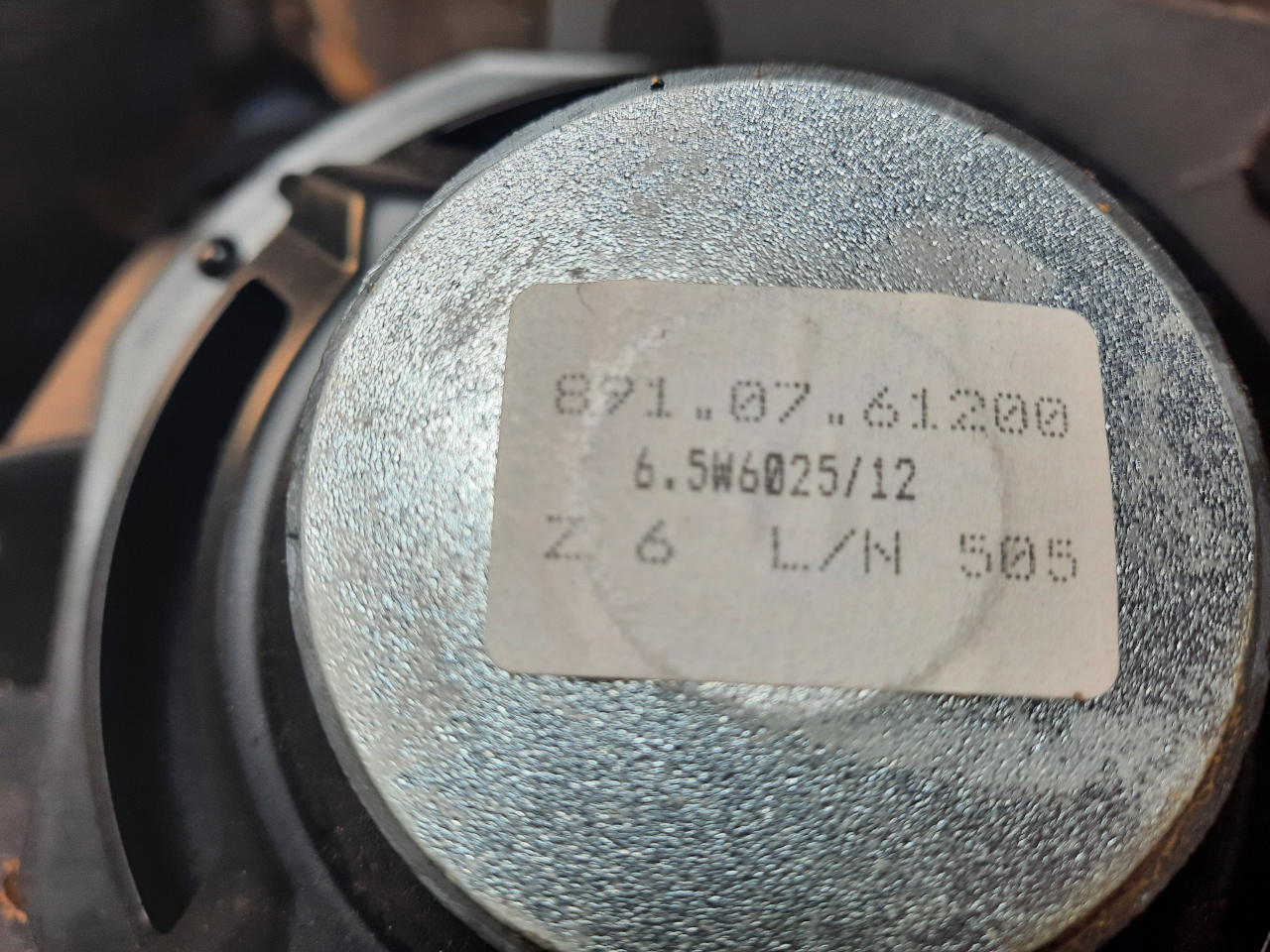

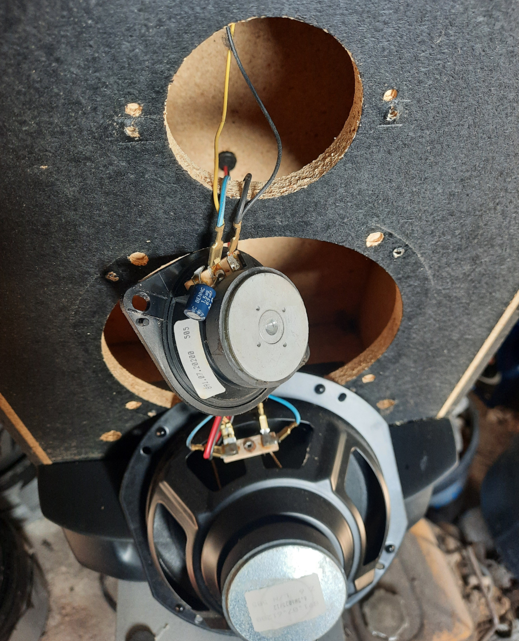

    i unscrewed the speakers and the it says 6.5w, is there a way of finding out what the "power" that the speakers accept or perhaps someone can decipher what is printed on the speaker.

  2. As per the manual
    Reference: 60 W + 60 W (6 ohms, T.H.D.
    10 %, 1 kHz)
    So each of your speakers is rated 60 Watts (8 Ohms)
    Now, you are powering up with a 18650 battery (3.7 Volts)
    Power = IV and I=V/R ==> Power = V^2/R = (3.7x3.7)/8 = 1.7 Watt
    Speakers have a minimum power input before the woofer moves.
    A supply of 3.7 volts providing 1.7 watts may not be sufficient to move those woofers.
    Even if it does play, with a current draw of 3.7/8 (~0.5Amp), your battery will quickly die.
  3. Member ricardouk's Avatar
    Mar 2005
    Portugal
    Hi Gromyko
    Thanks for your help, i was unsure because the sticker on the speaker was showing 6.5w, but that must be something else.
