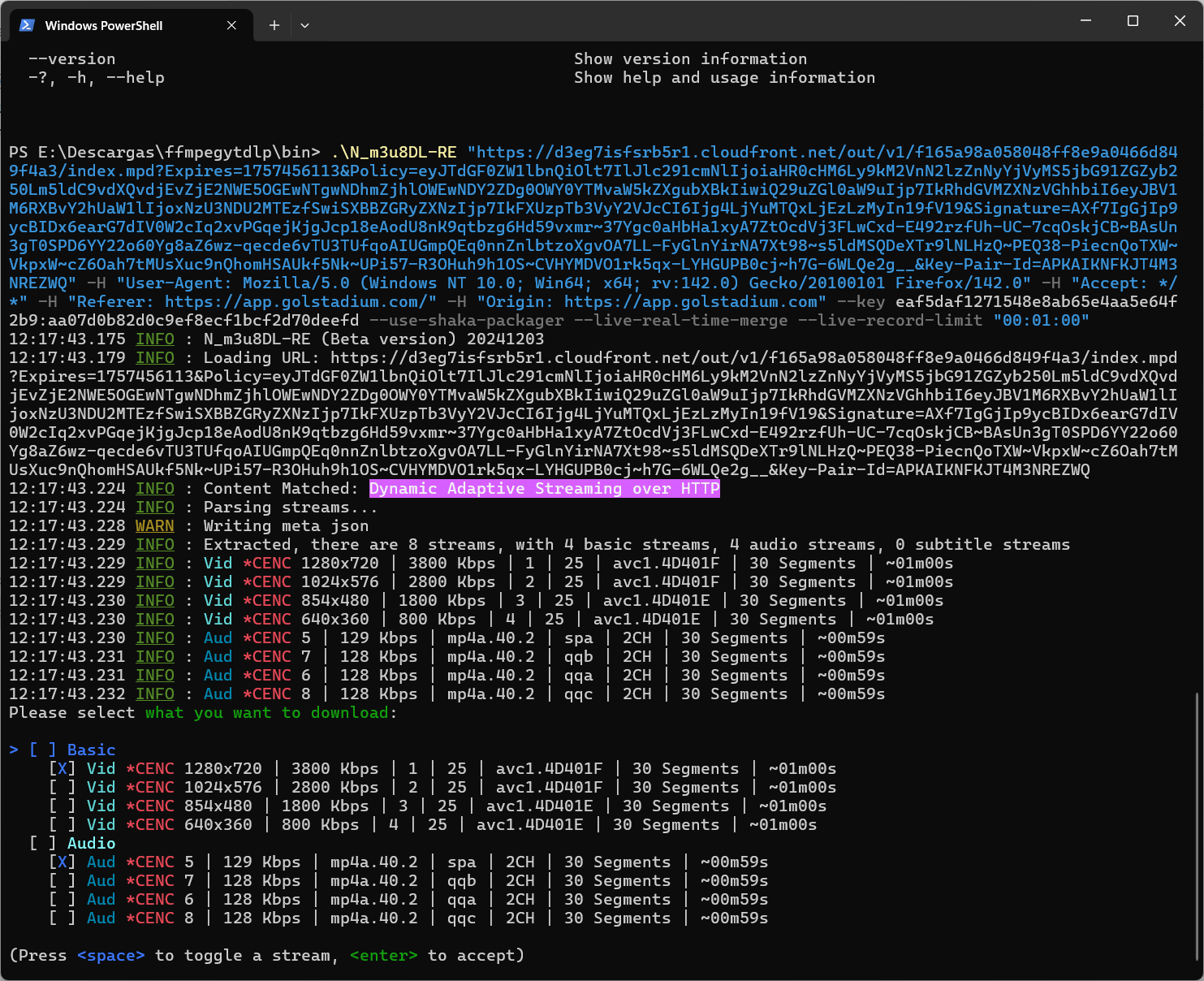

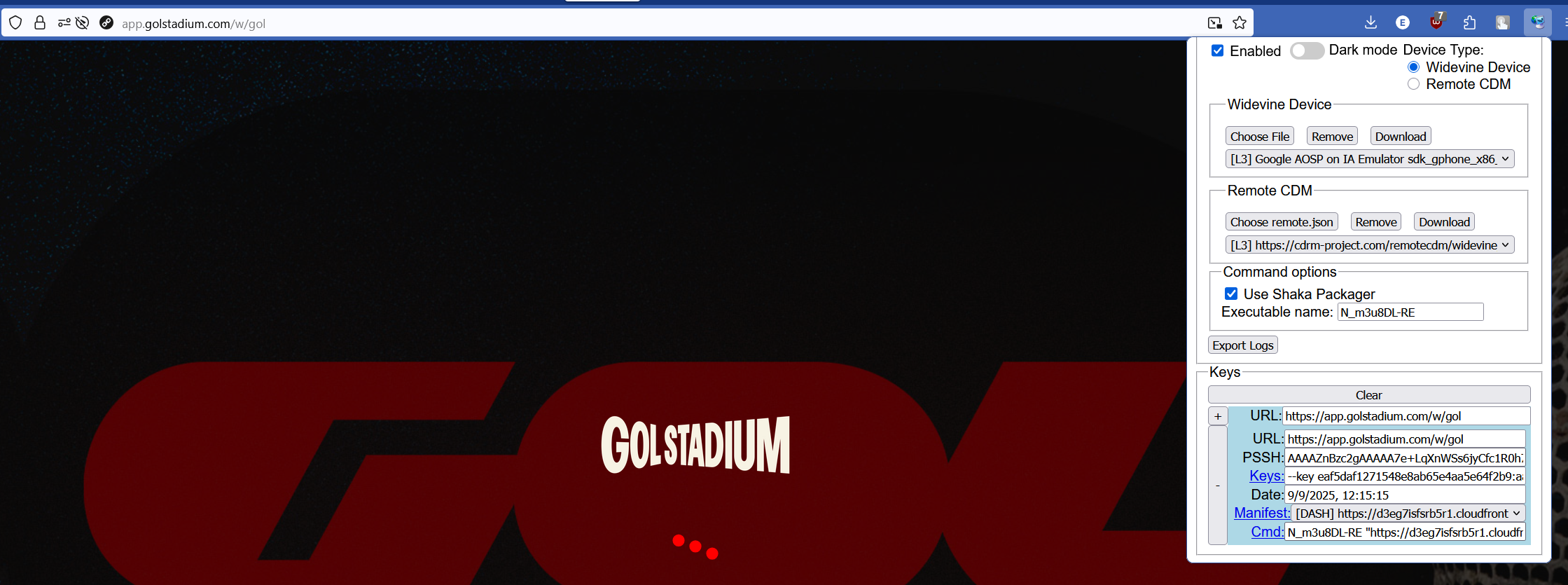

  1. Hi, i tried to download a stream from https://app.golstadium.com/w/gol with yt-dlp, but is drm protected and tried with N_m3u8DL-RE and widevineproxy2 to get the command with the key etc, i installed shaka-packager but after doing this the video doesn't play, what i have to do?
  2. Image

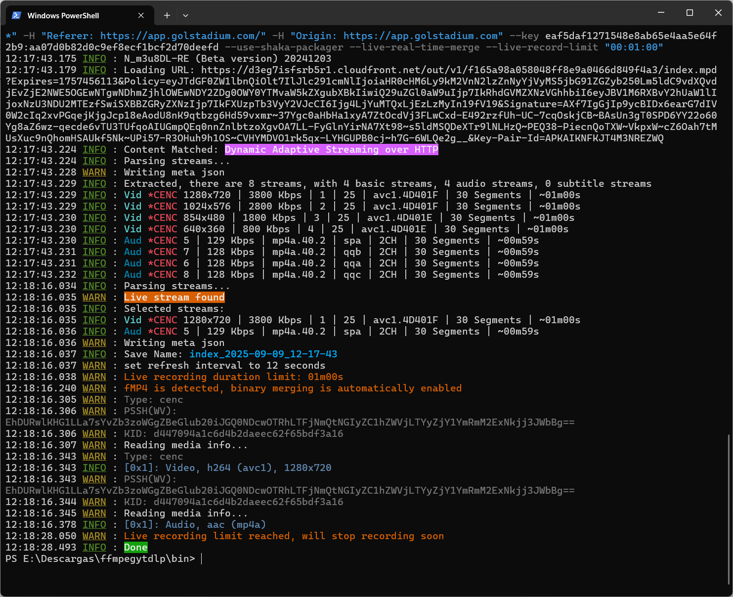

    I try to download a sample and everything seems to be ok but when i try to play the output file nothing is shown in the screen, what am i missing? i got the key from widevine proxy, is a live stream so i have to use --live-real-time-merge, no error in the screen but i don't see anything

  4. It seems you're not passing the correct keys for the stream you're selecting. If you look closely, the tool reports a KID that differs from the one you're providing via the command line.
    Select a lower resolution stream to check if it aligns with the key you're passing.
