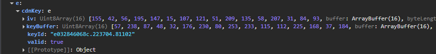

    may be useful, who knows
    [Attachment 88715 - Click to enlarge]
    {\"BlockSize\":128,\"EncryptionAlgorithm\":0,\"EncryptionMode\":1,\"IV\":\"myo4w5MPa3kz0Yc6zx9UXQ==\",\"Key\":\"Oe5XMCCw5lD96XNw4agluA==\",\"KeySize\":128,\"Kid\":\"e032846068c.223704.81102\",\"Padding\":\"None\"}

  6. Looks like IV and key buffer.
    Does it work on segment?
    I don’t think the standard methods will work in this case. Can’t say much without video url.
    discord=notaghost9997
  7. the keys @slayer36 pointed are correct.
    key_hex = "39ee573020b0e650fde97370e1a825b8"
    iv_hex = "9B2A38C3930F6B7933D1873ACF1F545D"
    we only need to decrypt the response of segments with AES CBC.
    Usually, the initial segment is not encrypted, but that is not the case here.
    I used mitm+yt-dlp a bit unusual method. I am sure there are better ways to do it.
