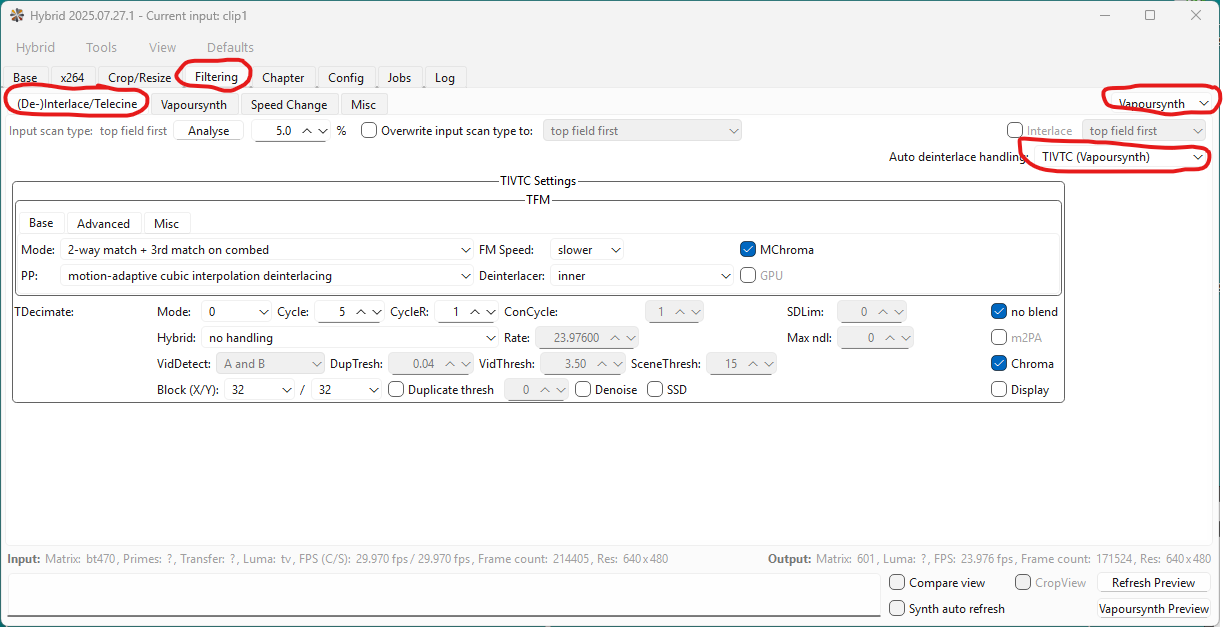

Your clip1 is telecined, so you have to IVTC (InverseTelecine) it, rather than deinterlace.
Avisynth script for IVTC, returning 23.976 fps progressive frames:
Or in Hybrid (using Vapoursynth):Code:LWLibavVideoSource("clip1.mkv") TFM().TDecimate()
[Attachment 88598 - Click to enlarge]
(For using Hybrid successfully a basic understanding of video formats, Avisynth or Vapoursynth is very helpful/a must).Last edited by Sharc; 7th Sep 2025 at 05:43.

a few side notes:
- When using Hybrid, overwrite the scan type to 'telecine', to let Hybrid know that the content is telecine and Filtering->(De-)Interlace/Telecine->TIVTC Settings->TGM->Advanced->Chroma should be enabled.
- the colors of those files seem wrong to me (more than just tv vs pc scale)
Yes, the wavy trees really seem strange,..I wonder how these have been created/ripped ....
Cu Selur
Ps.: playing around https://pastebin.com/8At6GW9NLast edited by Selur; 7th Sep 2025 at 13:02.

Do not switch to QTGMC and VFM.
If you enable VFM, QTGMC will not be used. (vfm will convert to progressive and then QTGMC can't deinterlace)
Try:- overwrite the scan type to 'telecine'
- enable Filtering->(De-)Interlace/Telecine->TIVTC Settings->TGM->Advanced->Chroma
- (optionally) enable Vinverse 2
- Vapoursynth -> Frame -> Interpolation/SVP FPS: 29.9706, Preset: medium, Tuning: animation, Overwrite Alg.: 2, Overwright Area: 100, Input type: 2d
(personally I would use RIFE instead, but use whatever you like)
