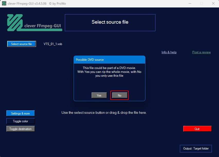

    You could try clever FFmpeg-GUI.
    You must work on the single VTS_xx_x.vobs (e.g. VTS_01_1.VOB) of your main movie.
    Start with _1.VOB (not _0.VOB), then _2.VOB aso for all vobs, one each time.
    Load the first VOB, answer NO to the question,
    [Attachment 88473 - Click to enlarge]

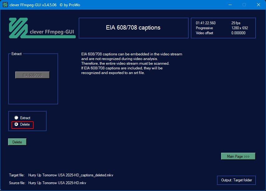

    click main page, click extract EIA 608/708 captions.
    Select Delete, click delete.
    [Attachment 88474 - Click to enlarge]
    The captions should be deleted now on the output vob.
    Play it to see, if the captions are removed.
    If so, replace the original VOB with the new created one.
