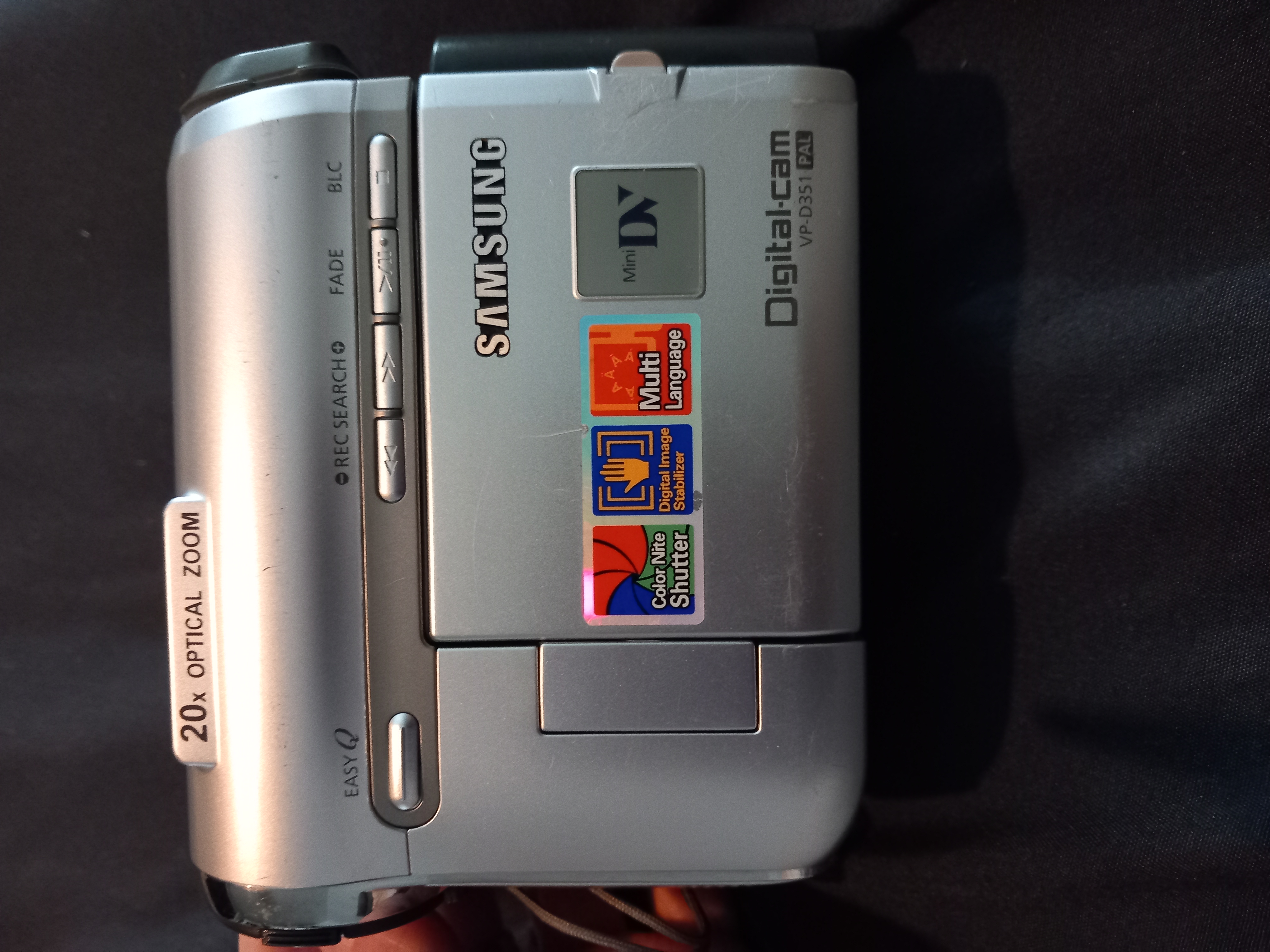

    I have an old Samsung mini dv digital cam VP-D351 PAL, when I play the tape I can hear the sound but can't view the tape.
    My question is firstly is there any way of fixing this, or is there anyway I can convert all my tapes to a computer.
    I have a few tapes with loads of old memories and would love to view them.
    Thank you.

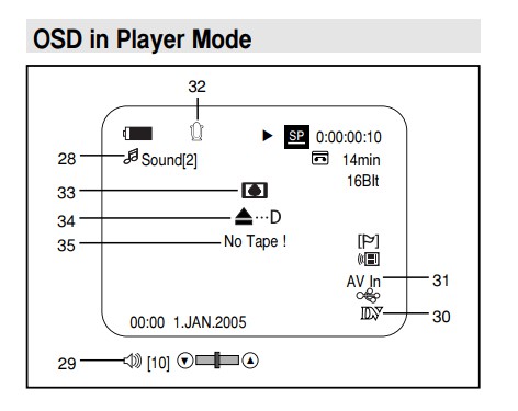

    - Is the screen actually working? Can you see any of the on-screen displays such as these:
    [Attachment 88385 - Click to enlarge]
    or is the screen blue?
    - If not, try connecting it to the VCR via the AV cable.
    If Yes, the video heads are probably very dirty. If you have a head-cleaning tape, run it in accordance with it's instructions.

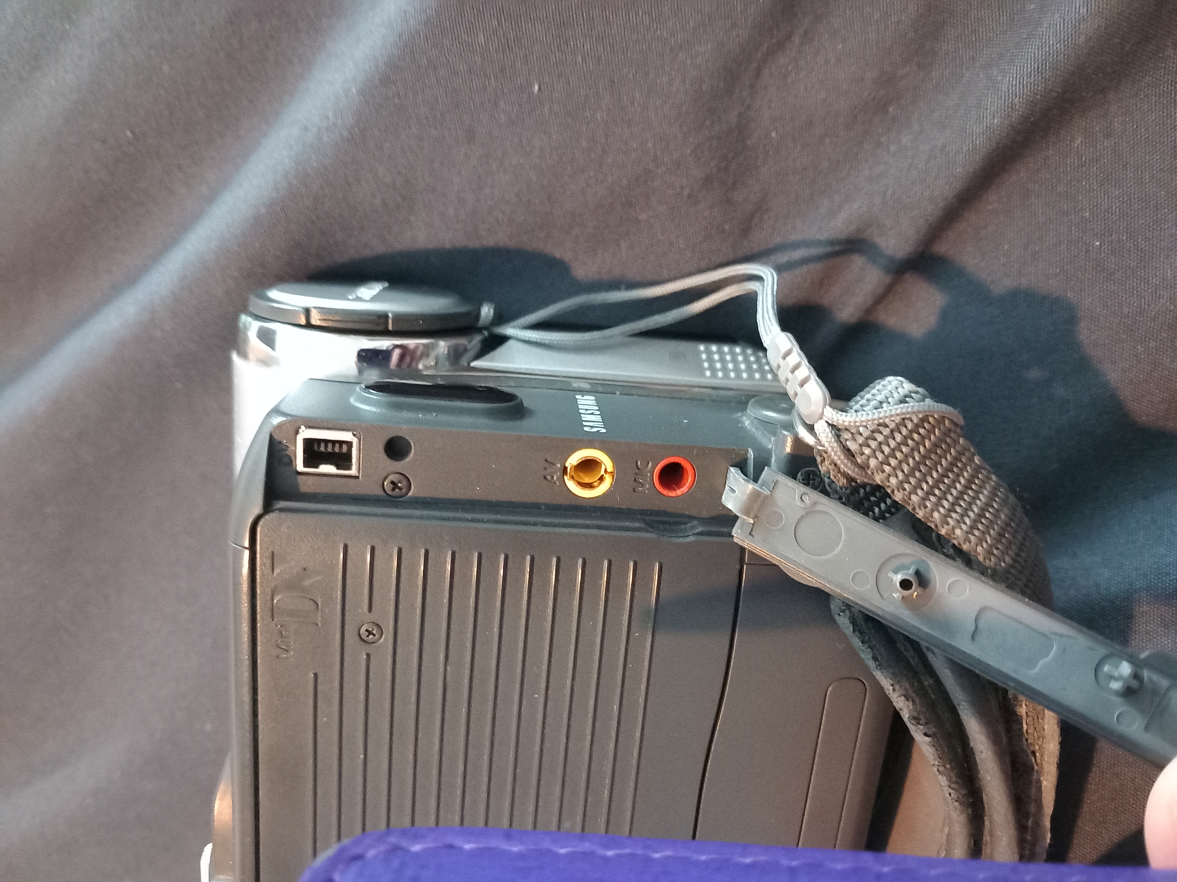

    In general, it's best to transfer MiniDV to your PC via a Firewire cable (it goes in that small rectangular socket at the top, in your first pic). But you need a Firewire socket on your PC, which is uncommon these days. It can be done using other methods though.

    Screen is white noting else on it, I can hear sound perfectly.
    Any specific firewall cable or socket? Will I get them on amazon.
    Thanks for your help
