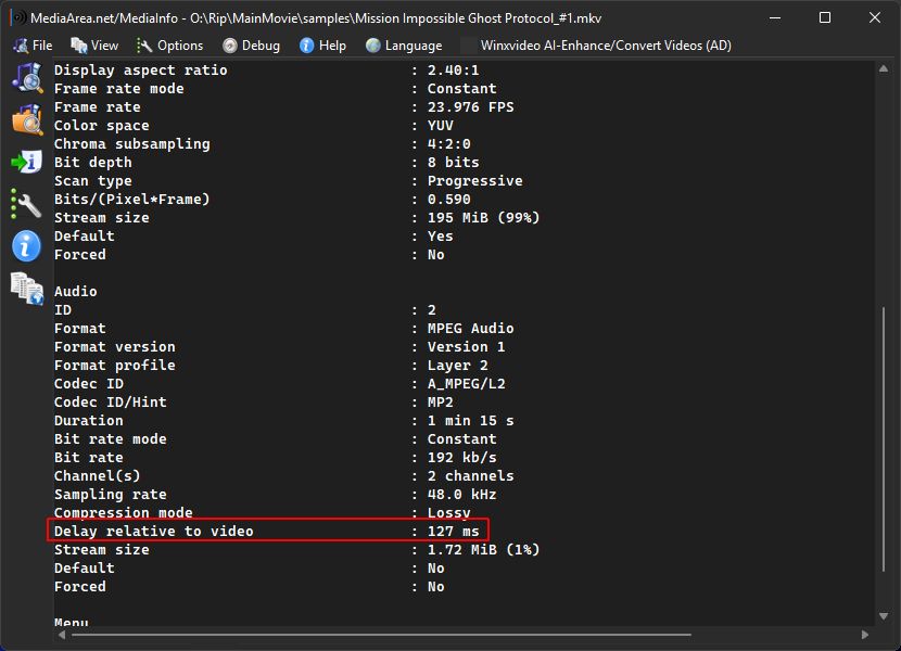

    Use mediainfo to see the original delay. Note it and mux the new created audiostreams with the same delay.
    [Attachment 88387 - Click to enlarge]
    What MediaInfo reports should be the "delay" already in the a/v file.
    Some formats do not show this.
    Audio can be either lead or lag so delay can be positive or negative.

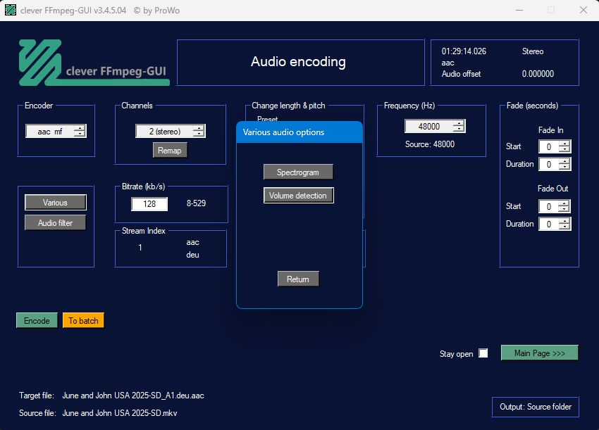

    You can use clever FFmpeg-GUI.
    Load your video, click main page, click encode audio stream.
    Click on extra, then on volume detection.

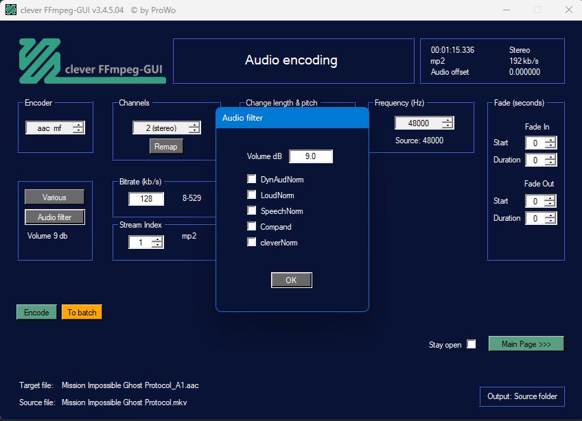

    On the left click on Audio filter.
    On the top you see the found gain in dB.
    [Attachment 88399 - Click to enlarge]
    Remember the value and cancel the field.
    Check the clevernorm filter and enter the remembered value. Click OK.

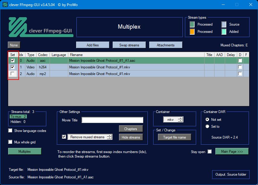

    If finished, click on multiplex.
    The new created audiostream is shown in green. Deselect the old audiostream on the left; all other streams should be selected.
    [Attachment 88400 - Click to enlarge]
    Set your container and click multiplex. Done.
    Listen at your new video and report, if the vocals are better for you.
