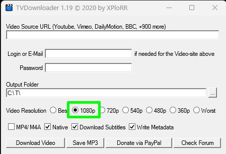

  2. Work around:
    Enter the mpd link in TVDownloader.
    select 1080, when the download cmd window starts, youtube-dl.exe checks if 1080 is available, if not it stops downloading.
    [Attachment 88353 - Click to enlarge]
