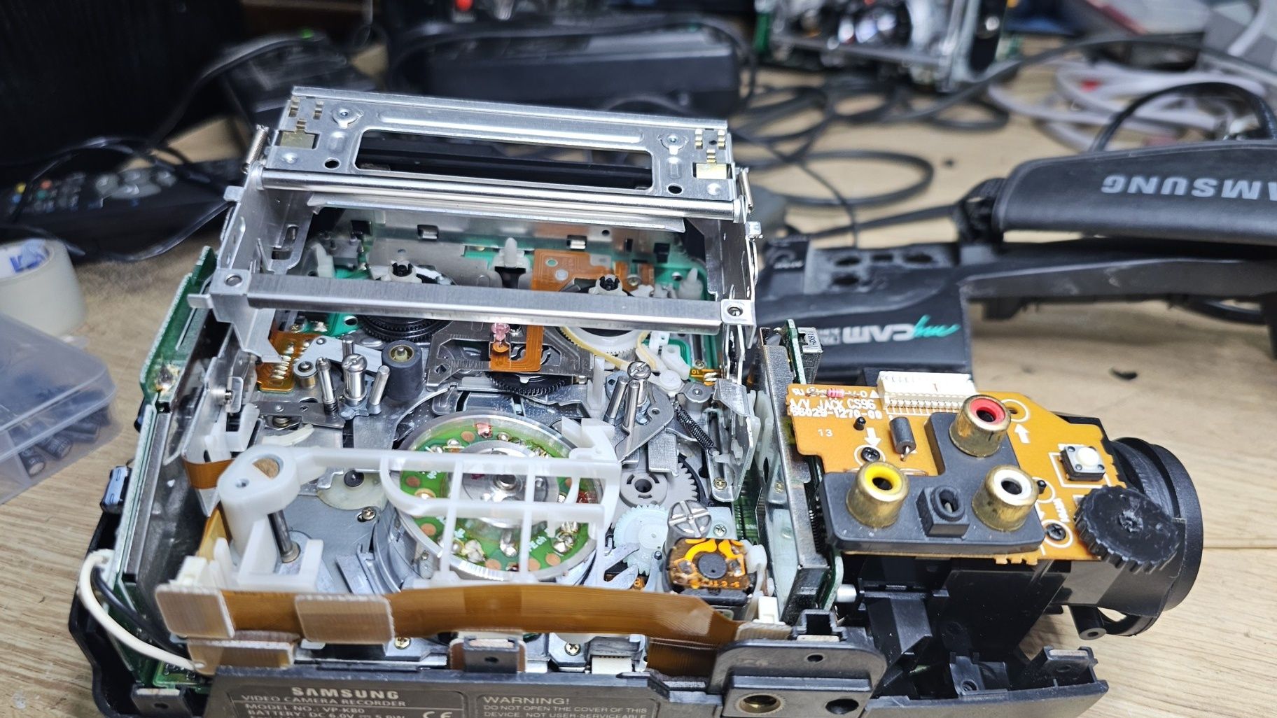

    I refer to the following video below for troubleshooting purposes:
    https://youtu.be/G5g5iHpgRLY
    Also i refer to the following video:
    https://youtu.be/urzSvV2zUkM
    My Samsung VP-K80/K85 8mm tape camcorder will not lower the tray when any tape is inserted. However, it will move the tray down with out the tape. If it is related to the switch mentioned on 1:26 of this video and it is not activated with the tape inserted, how is it then activated without the tape? The same question about the connectors mentioned on 2:00 of this video how the tray would go down without the tape and would not with the tape? In my Samsung VP-K80/K85 8mm tape camcorder the head starts to rotate when the tape is inserted and the tray is closed, but it still will not lower the tray with the tape. I could not find any photo sensors to the left and right to block the way on mentioned on 8:08 of this video. The issue I experience when the cassette is inserted and the tray is pushed closed the tray will not go down and will stay for 5 seconds and then opens. Any help is really appreciated!

    The further investigation shows that without tape, the camcorder displays the TAPE message, but when the tape is inserted and the tray is closed it is displayed the message STBY and then in a second, EJECT, and next C.EMG message:
    https://youtu.be/QSbX4GvJRX8

    Yes, I have many cassettes, but I have found such a comment on a forum called "VHS, Hi8, and DV Camcorder Enthusiasts":
    "Okay guys, Hey guys. I've been recapping this Samsung VP-K80 camera. The problem remains the same before or after recapping; it keeps ejecting the carriage with or without tape. The fault code displayed is L.EMG, and I cannot find what this error means. Thanks for the help; the problem is now solved, and I have a happy camcorder again. It turned out to be a tear in the ribbon connector junction at the bottom of the camcorder, affecting some sensors, etc. It was a bit hard to rewire, but it's working. The recapping was also a success."
    [Attachment 88378 - Click to enlarge]

    My camcorder is also keeps ejecting the carriage with tape. However, I did not have a chance to remove the covers and examine the ribbon connector junction at the bottom of the camcorder. Someone replayed to me on this issue: "Camera knows if there is a tape inserted because the tape will block the optical end sensors. If no tape installed the light from the end sensor LED will hit both end sensors so it lowers down. If a tape is present it goes through self check, which requires both the capatan motor and drum motor to spin up. If they don't start due to electrical or mechanical problems it will eject the tape. Most likely mechanical issues is grain of sand blocking a gear from turning. Electrical problems are leaking caps. If that's the issue too bad so sad toss it because it ain't worth fixing."
