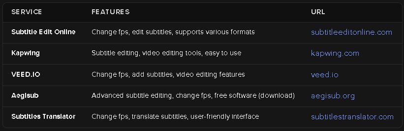

  6. @loninappleton
    If your video and audio are in sync, but your subs aren't,
    then the easiest way is to find a sub online that matches
    your video current FPS.
    Another option is to change the subtitle FPS that you have
    by using a program or an online service.
    [Attachment 88335 - Click to enlarge]
    Clever FFmpeg-GUI is also a great program to try
