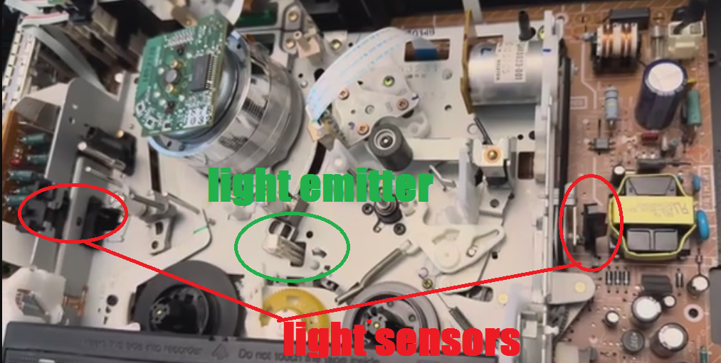

  2. Have you tried other tapes ? Before doing anything try other tapes just to make sure
    These JVC's they don't like sunlight/ lamp , just put something to cover the light sensors (right and left)
    You could check the belt below the mech, ensure it's not too loose /mushy, you'd need a brand new one if that's the case.

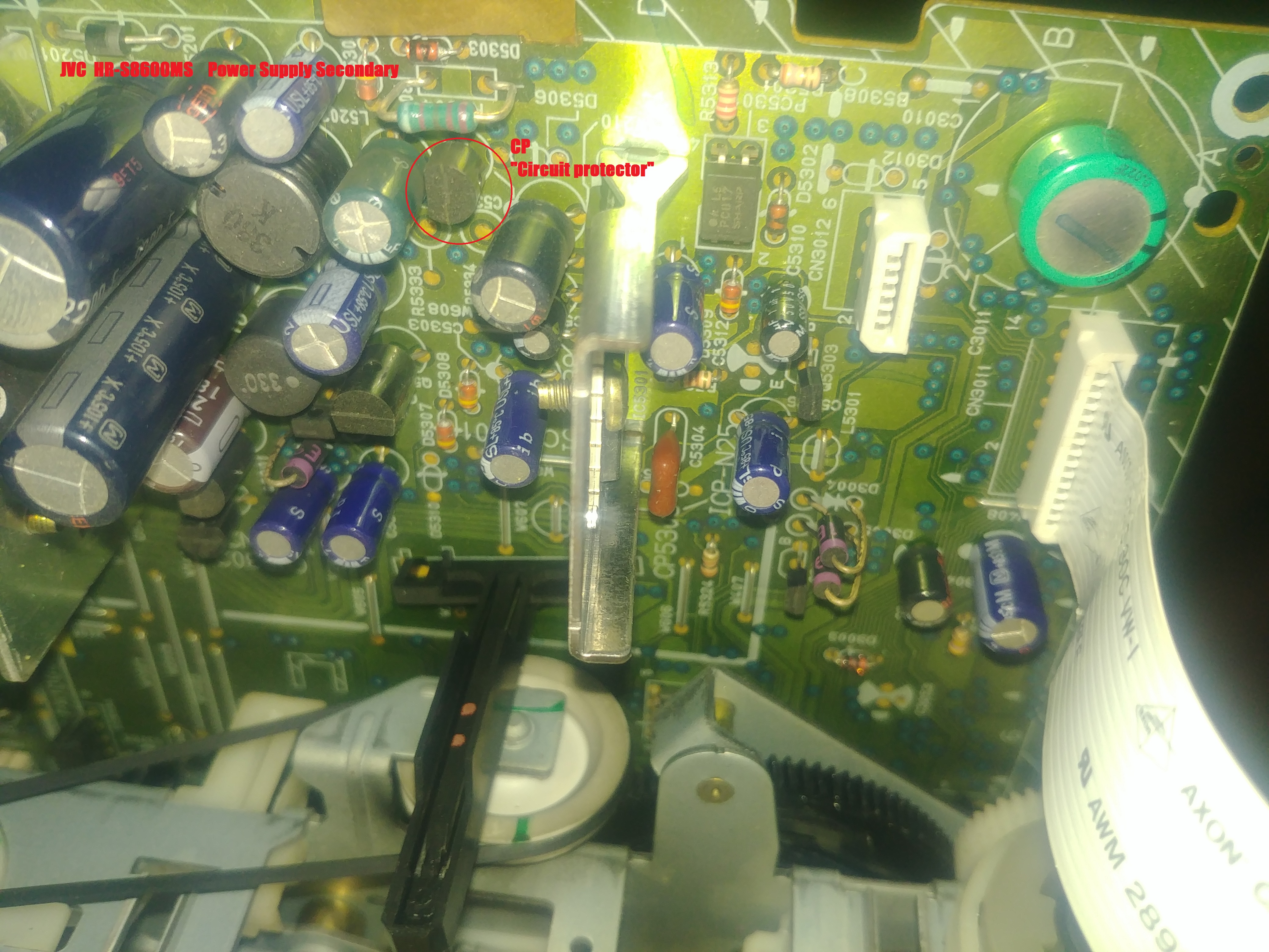

  4. Can be the 9V on the power supply (if drum really does not turn) but for now i doubt it
    Jan 2016
    Check the CP protection circuits, they are usually on the right side of the mechanism next to the power supply, I can't remember which one specifically powers up the drum motor but they are easy to test, check for voltage on both legs, if one doesn't read a voltage it's blown, You need the schematic to find them.
    Mar 2008
    This blew in my jvc many years ago. Fixed under warranty. The ticket mentioned the protection circuit,;
    I had similar symptom, drum not spinning. Never did find out where it actually was
    Thanks, I have tried other tapes and it has the same issue. I also covered the sensors with the same result.

    The drum should be rotating, so it's a power supply issue, like others said, check the circuit protector (CP) on the secondary, i think there is another outside the power supply (left side of the board). The CP's protect against over voltage, they just short.

    I've not been able to find any further info. What do they look like? Do you have a picture of one?
  12. [QUOTE=davexnet;2780736]
    Originally Posted by themaster1 View Post
    [I've not been able to find any further info. What do they look like? Do you have a picture of one?
    See attached picture. There should be a writing close to it like "CP5301" etc..on the board.
    There are at least two CP's like i said (most likely more) one in the secondary of the PSU and the other close to the PSU.

  13. The relevant CP tends to be kind of near the drum (usually to its right), oftentimes marked as "CP4001". The approx. location and designation are consistent on the (several) JVC models I know.
