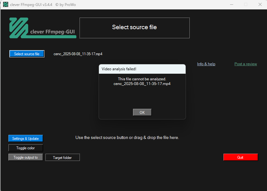

    [Attachment 88344 - Click to enlarge]
    I appreciate your input. But I think I'm gonna need someone with atom hex editing skills for this case.
    recover-mp4-to-h264 results in a 2.4 kb file size. Recommend and custom arguments in the syntax?
    Edit: It appears "--start read from position" is producing a file size congruent to the actual video file and not mere kilobytes. Will update if this leads to resolution.
    Edit 2: The outputed file is only 43 percent of the actual file size.
    Is Video Repair Tool just a glorified Untrunc-GUI with a pay wall?
