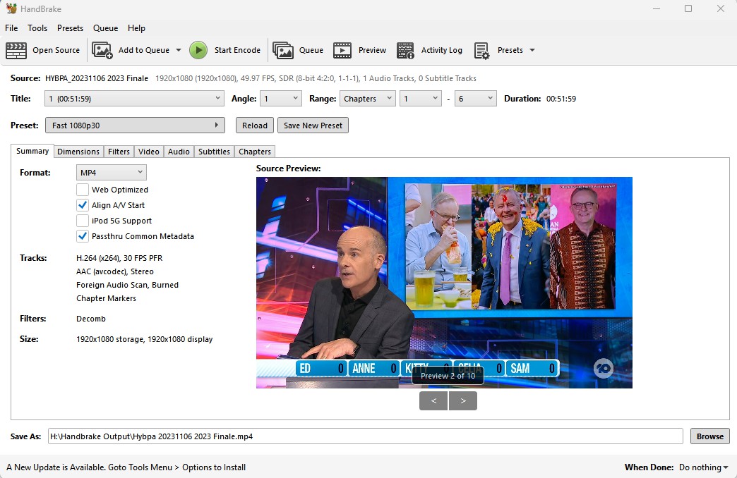

    Summary:
    [Attachment 88265 - Click to enlarge]

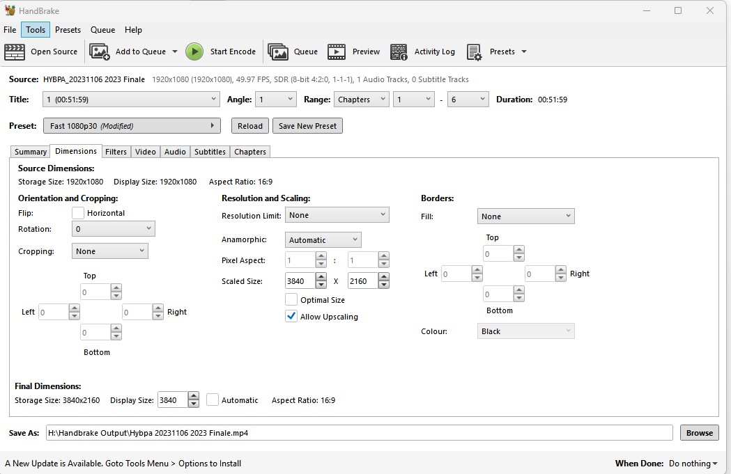

    Dimensions:
    [Attachment 88266 - Click to enlarge]

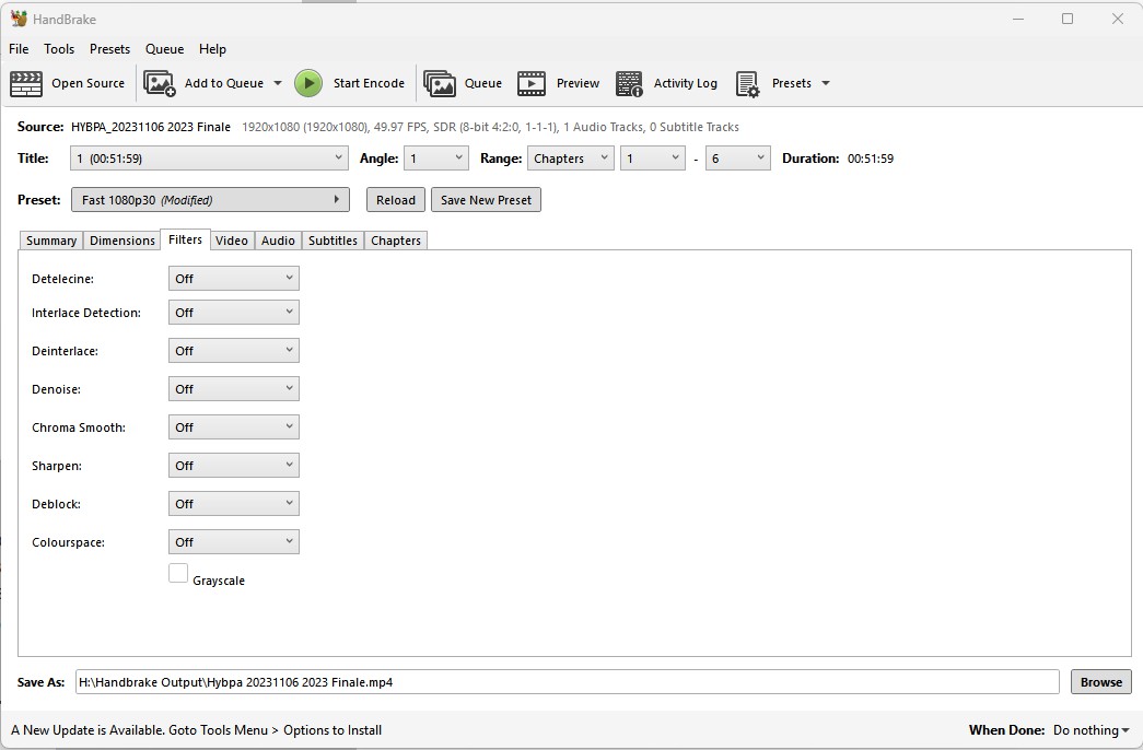

    Filters:
    [Attachment 88267 - Click to enlarge]

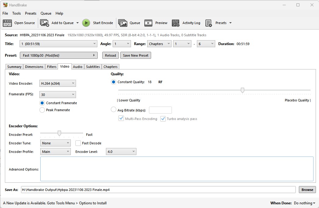

    Video:
    [Attachment 88268 - Click to enlarge]
    I've set the RF at 18, which is a reasonable quality level, but if you see lower quality, you can increase it by decreasing the RF.

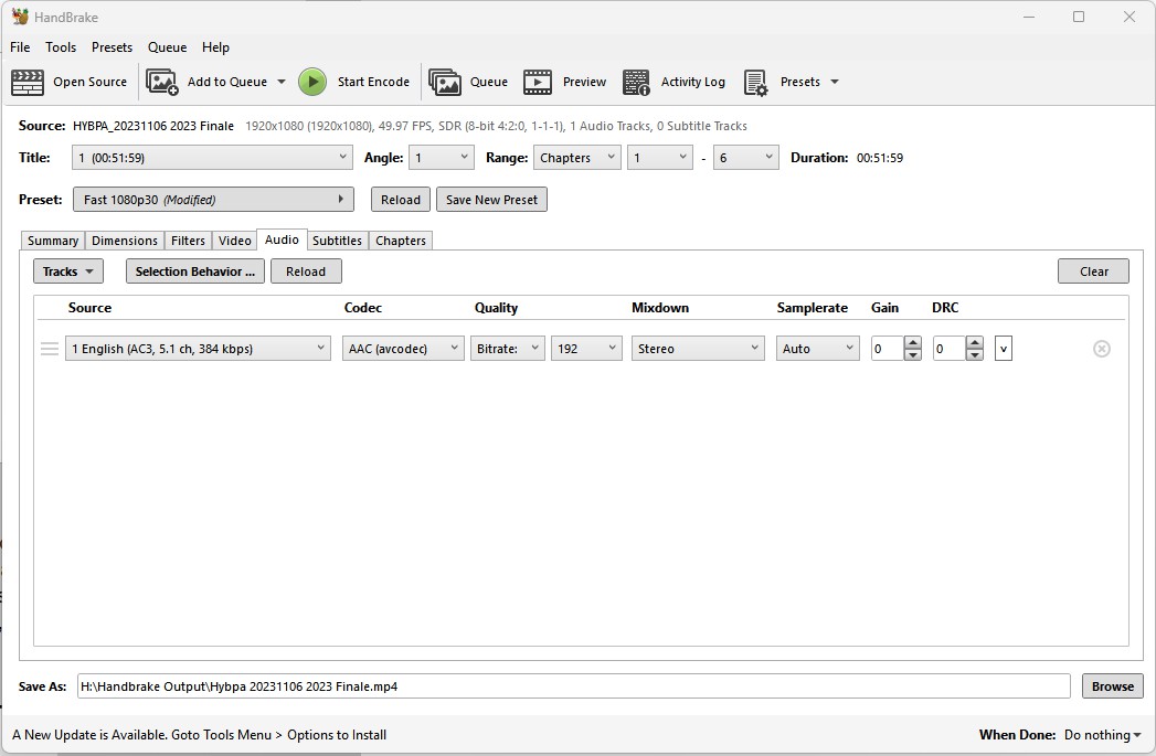

    Audio:
    [Attachment 88269 - Click to enlarge]
    Depending on your source files, you can experiment with surround audio.
