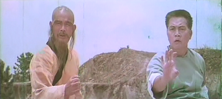

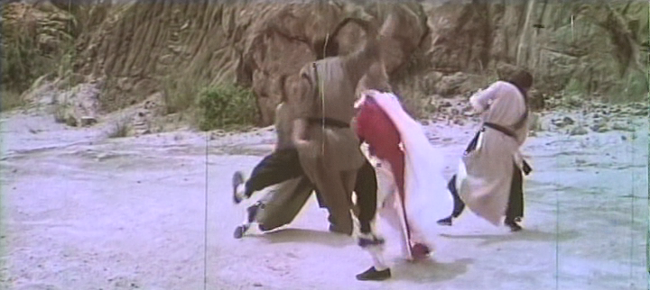

    not sure if its how you suggested but I get small artifacts appearing on fast scenes( see pic):Image
    [Attachment 88093 - Click to enlarge]
    But if I replace Line 10 on script with RemoveDirtMC(40) instead of DeSpot, I get no artifacts (see pic for comparison):Image
    [Attachment 88094 - Click to enlarge]
    Maybe my settings on filters are wrong. Any advise would be greatful.
  5. I suggested applying the filters in a different order (DeSpot+CAS+SmDegrain) and on the fields.
    So you would have to separate the fields, apply the filters, then weave the fields and apply ivtc to try what I suggested.
    You might also want to add DeScratch, a deblocking filter and SSIQ.
    Using and tweaking BM3D might also be worth a look if speed is not an issue,...

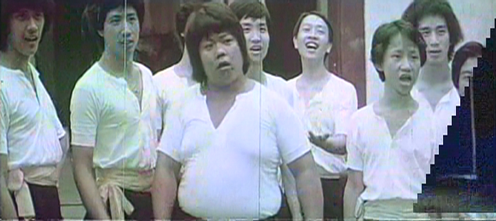

    This script improves it quite a bit but I get a weird distortion on scene change from using RemoveDirtMC (See pic below):
    [Attachment 88141 - Click to enlarge]

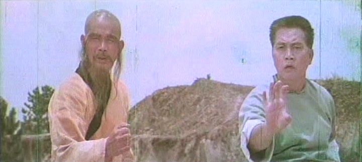

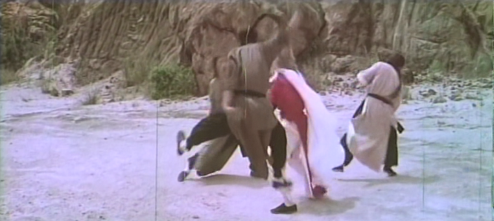

    There is improvement in image with script:
    Original:Image
    [Attachment 88142 - Click to enlarge]
    Avisynth Version: Image
    [Attachment 88143 - Click to enlarge]
    Also changed the TDecimate Cycle to 5 instead of 6 as it was giving some duplicate frames sometimes.
    Any advice would be much appreciated.
  9. a. I would recommend applying deblocking and spotless on progressive content (so after vinverse or on the fields, whatever works better).
    b. to me those lines look like something a typical case for descratch so tweaking the setting might help. Using 'mark' to see what would be filtered might help. (this only makes sense while DeScratch is the last filter used, so look at it while commenting out stuff behind it,..)
    Maybe even use multiple Descratch calls with different settings, or use different setting on different scenes.
  10. Yeah, moving Deblocking and spotless on progressive content looks better.
    Also moving RemoveDirtMC after SMDegrain, has fixed the distortion I was getting at some scene changes too.
