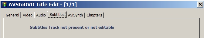

  2. You might give AVStoDVD a try,
    I have not used it's menu function much so I'm not sure if it will do what you want with the audio tracks.
    Wort a try.

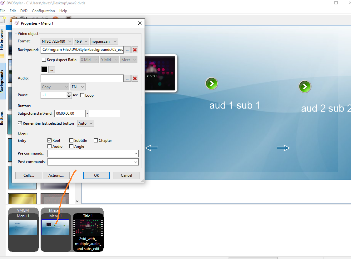

  14. @ imkira3,
    I'm trying to do what you want with DVDStyler.
    It has been a long time since I worked with DVDStyler.
    I believe I have the Languages working correctly but not the Subtitles.
    If I can get a Menu working with both Audio & Subtitles I will post some sort of "How to".
    As you probably know DVDStyler is a complicated program.
    Much of the information on the Internet is either "Not enough information" or written poorly.
    Some of it just does not work . Maybe it did for the one posting but it did not for me.
    Mar 2008

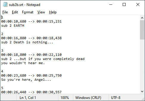

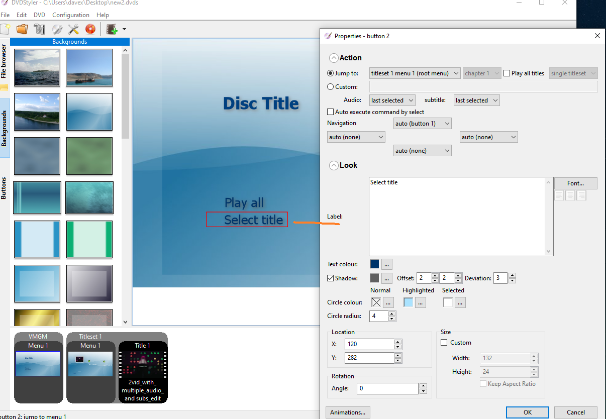

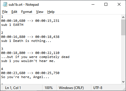

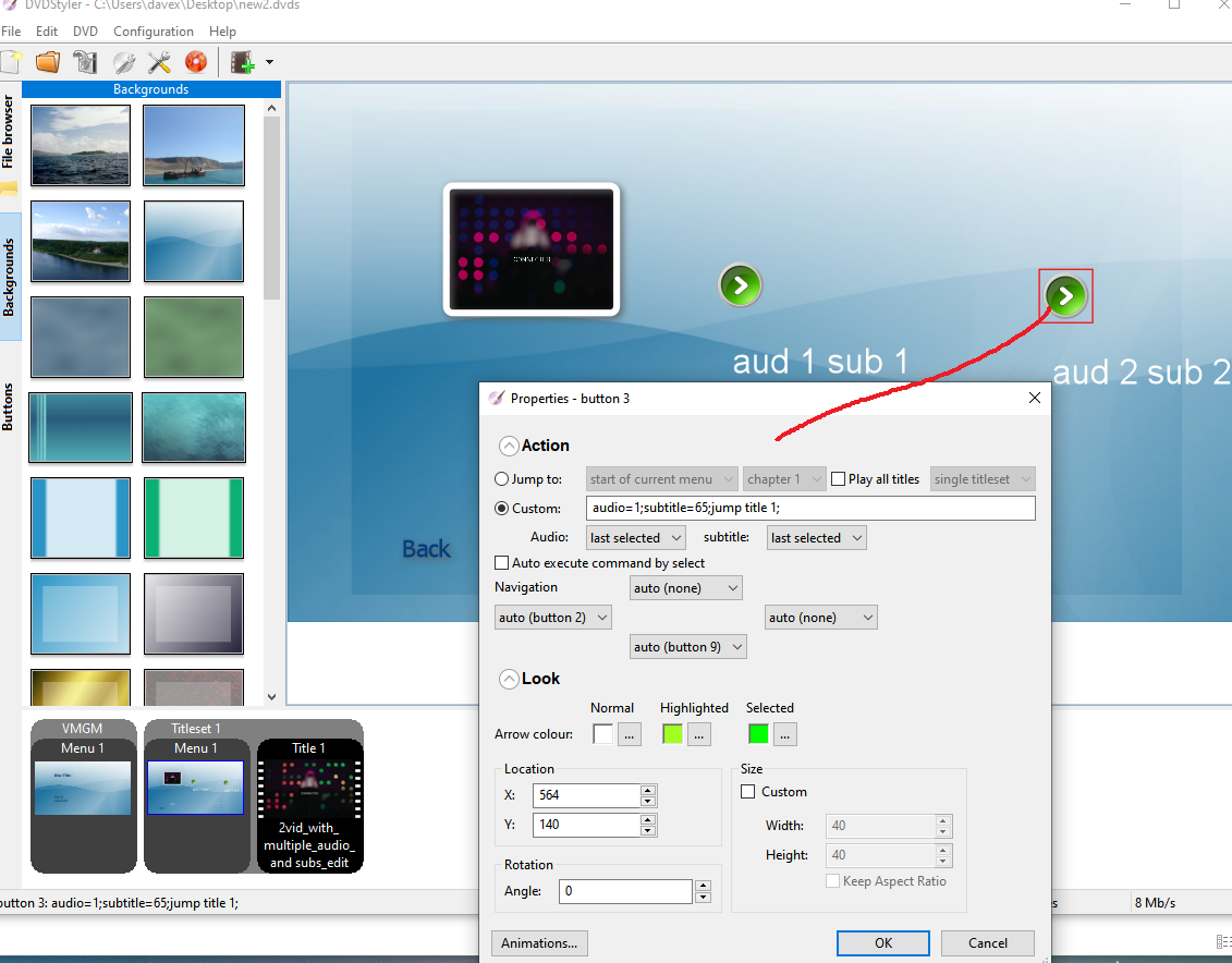

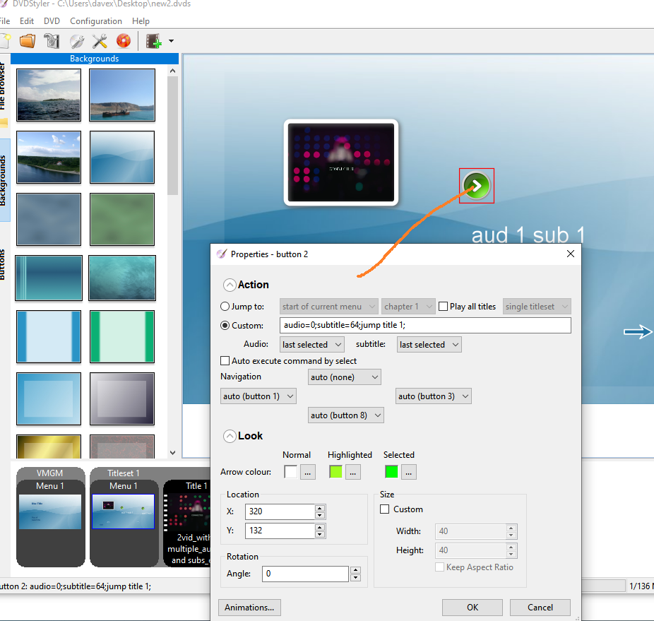

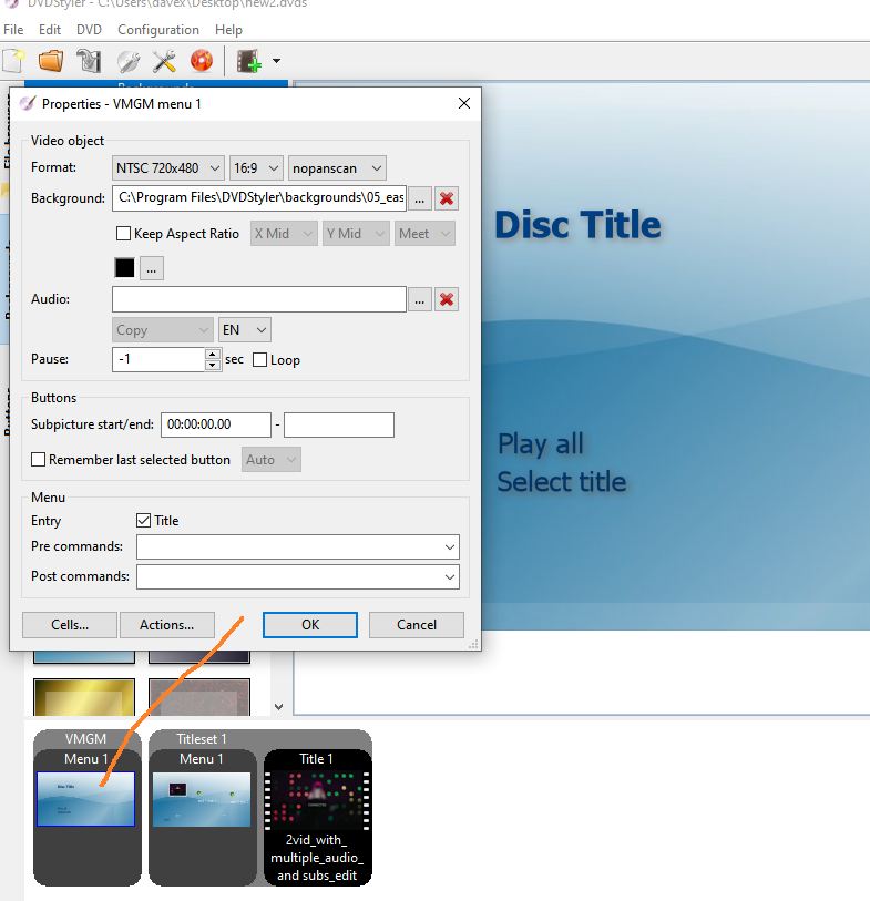

    @cholla, @imkira3, I think this is the basic functionality; but I'm a novice at DVD navigation myself -
    The subs show up at 10 seconds. One will say SUB 1 and the other will say SUB 2.
    Also two different audio tracks, first the original, the other a song by Tears For Fears ...

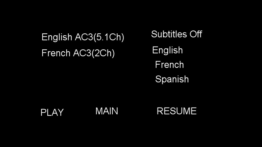

    @ davexnet,
    I downloaded & tested your video.
    The buttons you created worked as they should have.
    However this is not what the OP requested in post#1 .
    [Attachment 88273 - Click to enlarge]
    Titlewriter can create a Menu that works for most of what the OP wants.
    But not everything. The Selection (Button) text can not be edited.
    It is what Titlewriter gets from the audio/video files.
    This is what PGCEdit has for the Buttons created by Titlewriter:
    I can not figure out how to interpret it to use as DVDStyler commands.
    From Titlewriter created menu:
    Subtitle Off button:
    [51 04 00 00 BF 00 00 06] (SetSTN) Set Sub-picture stream = 63:forced ; LinkPGCN PGC 6
    English subtitle button:
    [51 04 00 00 C0 00 00 06] (SetSTN) Set Sub-picture stream = 0, on ; LinkPGCN PGC 6
    French subtitle button:
    [51 04 00 00 C1 00 00 06] (SetSTN) Set Sub-picture stream = 1, on ; LinkPGCN PGC 6
    Spanish subtitle button:
    [51 04 00 00 C2 00 00 06] (SetSTN) Set Sub-picture stream = 2, on ; LinkPGCN PGC 6
    Audio:
    English:
    [51 04 00 80 00 00 00 06] (SetSTN) Set Audio stream = 0 ; LinkPGCN PGC 6
    French:
    [51 04 00 81 00 00 00 06] (SetSTN) Set Audio stream = 1 ; LinkPGCN PGC 6
    [Attachment 88274 - Click to enlarge]

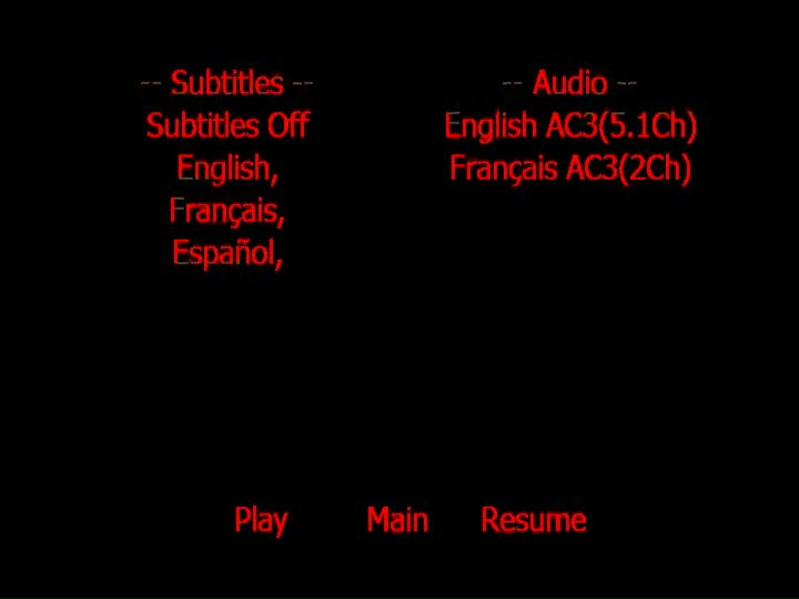

    This is the same information from PGCEdit from the DVDStyler created Menu:
    DVDStyler created menuThese buttons do not work.)
    In VLC the subtitles always show disabled when using this menu.
    [71 01 00 0F 00 04 00 0D] Set gprm(15) =(mov) 4 ; LinkTailPGC
    [71 01 00 0F 00 05 00 0D] Set gprm(15) =(mov) 5 ; LinkTailPGC
    [71 01 00 0F 00 06 00 0D] Set gprm(15) =(mov) 6 ; LinkTailPGC
    Audio:The Audio buttons work in VLC
    English:
    [71 01 00 0F 00 01 00 0D] Set gprm(15) =(mov) 1 ; LinkTailPGC
    French:
    [71 01 00 0F 00 02 00 0D] Set gprm(15) =(mov) 2 ; LinkTailPGC
    As you can see different.

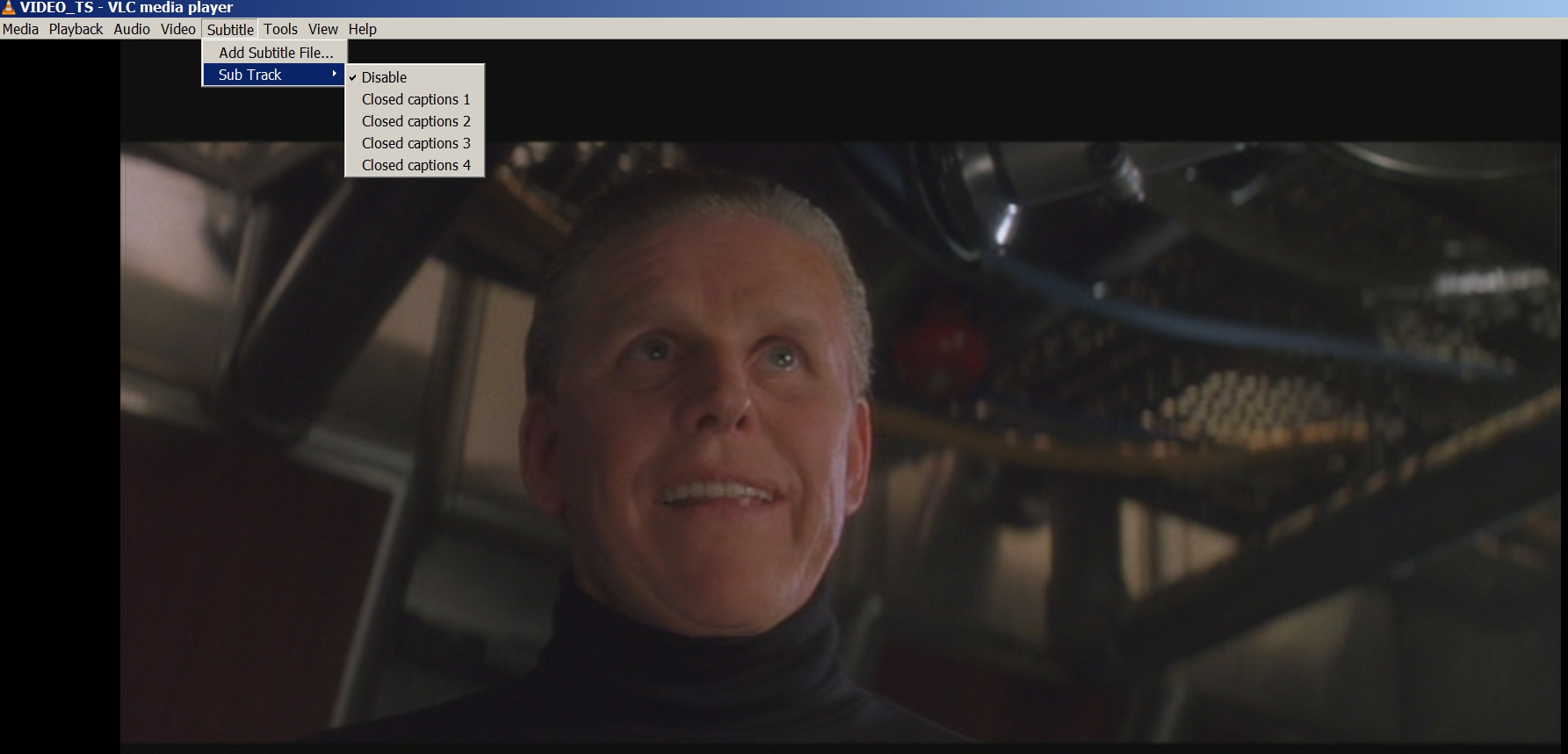

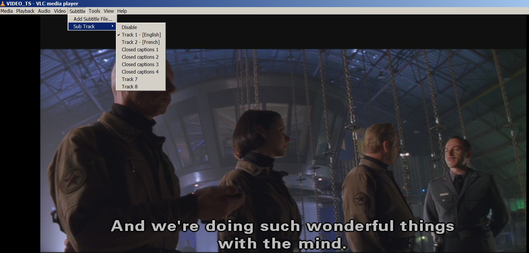

  17. @ davexnet,
    I know you do not claim to be an expert with DVDStyler & only a "novice".
    I downloaded the video you posted.
    The selections did show the video with subtitles.
    I could not tell that there was a different audio & the subtitles did not match the words in the song.
    So I tested with decrypted DVD rips from 3 different DVDs.
    These were ripped without menus.
    The results were the same.
    Before the rip was processed with DVDStyler.
    I tested them with VLC. The Subtitle pulldown shows the subtitles.
    The subtitles can be selected from there & display
    Like this:
    [Attachment 88302 - Click to enlarge]
    This is after the rip was processed with DVDStyler:
    The dropdown doesn't show any subtitles & even if I uncheck "Disable" the subtitles do not display.
    The Audio tracks made the selection correctly.
    The Subtitle tracks did not display any subtitles.

    AVStoDVD displayed this for all the DVDs I tried:
    [Attachment 88316 - Click to enlarge]
    So I now believe AVStoDVD can not use the subtitles on a DVD.
    It might is the subtitles were extracted & put back in.

  22. These are the DVDStyler small videos.
    The two AtoD videos are:
    The no menu is strait form AtoD,There are no subs.
    The one with menu I tried with DVDStyler but there are no subs .
    The DVDShrink one has the subs.
    It is close to what the OP wanted.
    The best DVDStyler would allow me to do.
    I saw no way to select a separate Audio & a separate sub & then select PLAY.
    But the menu accomplishes this in a different way.
    DVDStyler requires Audio & Subtitle tracks be selected for a button.
    The subtitle can be set to "Off' but the Audio can not.
