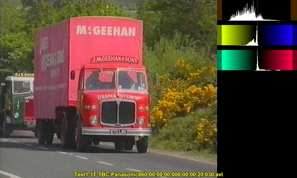

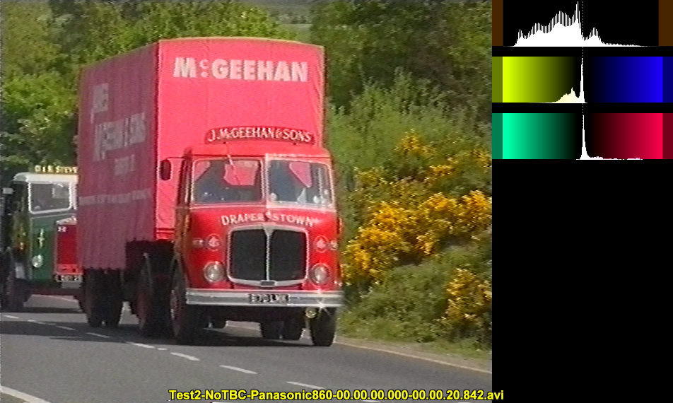

  6. I've added a few samples from a test capture on my Panasonic NV-HS860 - one with the 1T-TBC in the loop, the other with no TBC, 860 directly to capture card. Any comments on any visual impact from having the 1T-TBC in the loop?
  7. Captures & Restoration lollo's Avatar
    Jul 2018
    Italy
    Better to provide the same sequence with TBC on/off

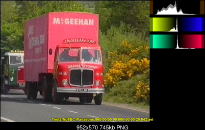

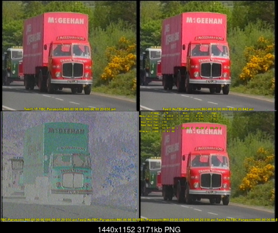

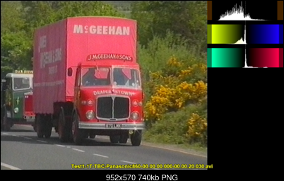

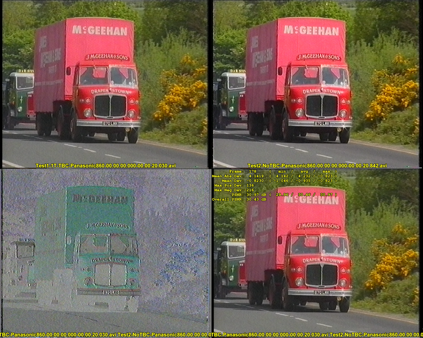

    A quick analisys on my side:
    with TBC
    • frame 1 duplicated (probably inserted by the capture card)
    • distortion (highlighted in purple): https://imgsli.com/NDA0MzQw
    • loss of details (yellow flowers on the right, among others)
    • histogram less convincing:
    Overall comparison:
    Even trying to adjusting the overall look of the TBC capture for brightness and saturation I still prefere the noTBC image: https://imgsli.com/NDA0MzQx
    However, although introducing obvious "manipulation" on the original source, an external TBC is required to clean the signal, avoiding timing errors across frames (to avoid dropped frames among other benefits).
    This is just a short sequence, so it is entirely up to you to establish if it is worth using it.
    My approach is to do not use if not necessary, and this small sequence is one significant example. YMMV!

  12. How does one go about generating that image that shows distortion levels? I'd like to be able to set up some of my own tests here.
  13. Captures & Restoration lollo's Avatar
    Jul 2018
    Italy
    Avisynth/VirtualDub:
    - open the sources and align the sequence using stackhorizontal() and trim; while there move across frames to visually check dropped/inserted frames
    - replace stackhorizontal() with interleave to better see differences in the pictures; while there eventually add crop() and histogram("levels") to assess the levels
    - eventually equalize the levels and the histograms to uniform the overall look, with colorYUV()/Tweak() or dedicated histogram matching plugins
    - copy the source frame to the keyboard (same frame of both sequnces) and past to paint (for instance) and save in png format
    - upload the images to a slider comparison site like img.sli.com; it compress to jpg, so the comparison is somehow "crushed"; other sites allow png comparison directly. You can also build your own img/video comparison tool in html (for instance) if you prefere
