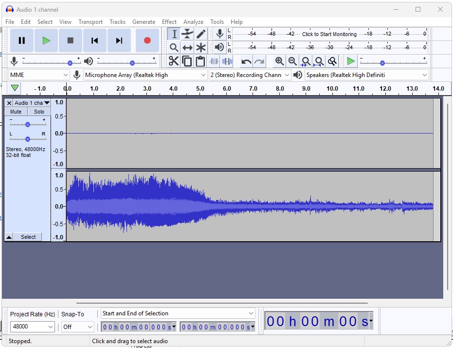

	Seems to be technically a stereo file, but it looks as if the left channel has nothing in it.
 You could make a two-channel mono file out of it
	Yes, left channel flat-line...
 [Attachment 88055 - Click to enlarge]

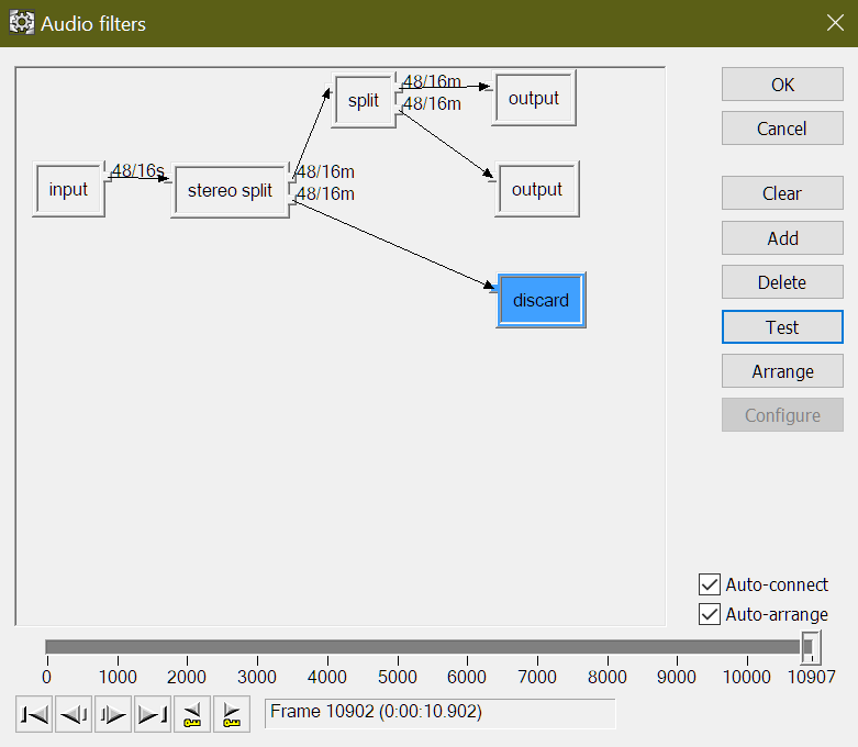

	I think you can do this in VDub using Advanced Filtering, but I haven't tested it.
 https://gcdnb.pbrd.co/images/TVQJofSz3Yv0.png?o=1

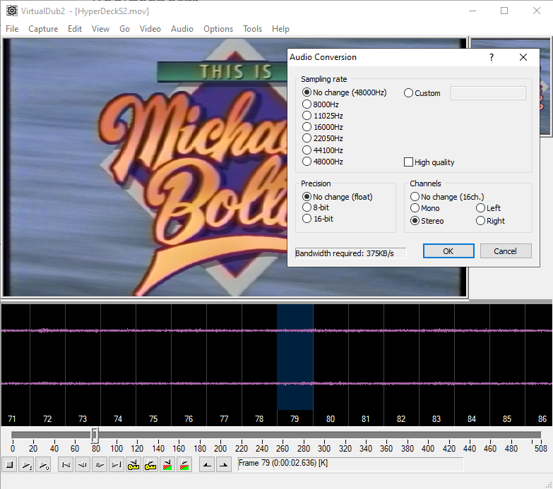

 And you don't actually need two audio channels. If you have one, it will play on both speakers anyway. And in the Audio conversion tab, just select "Left channel".Last edited by rgr; 4th Aug 2025 at 06:55.
