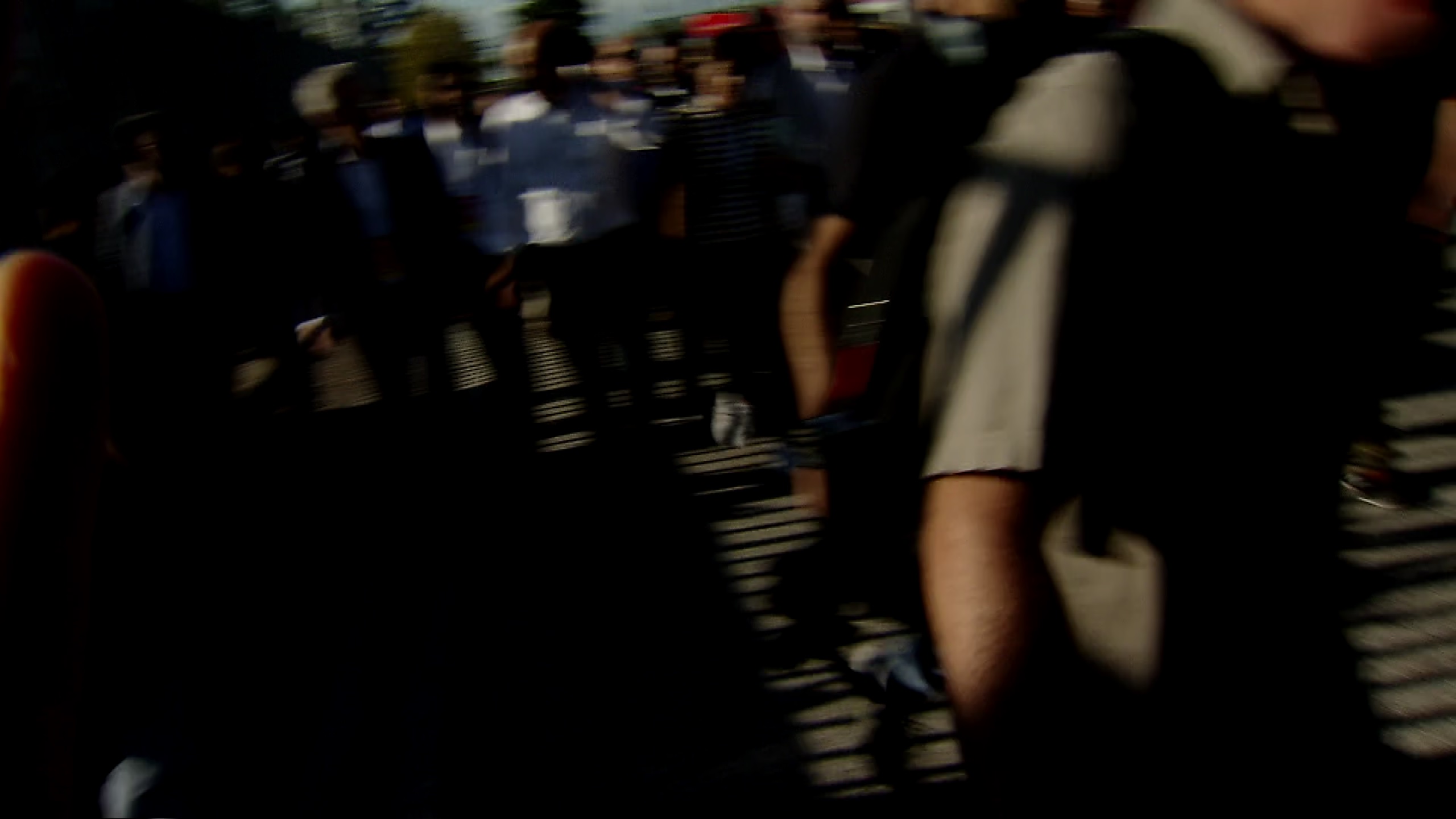

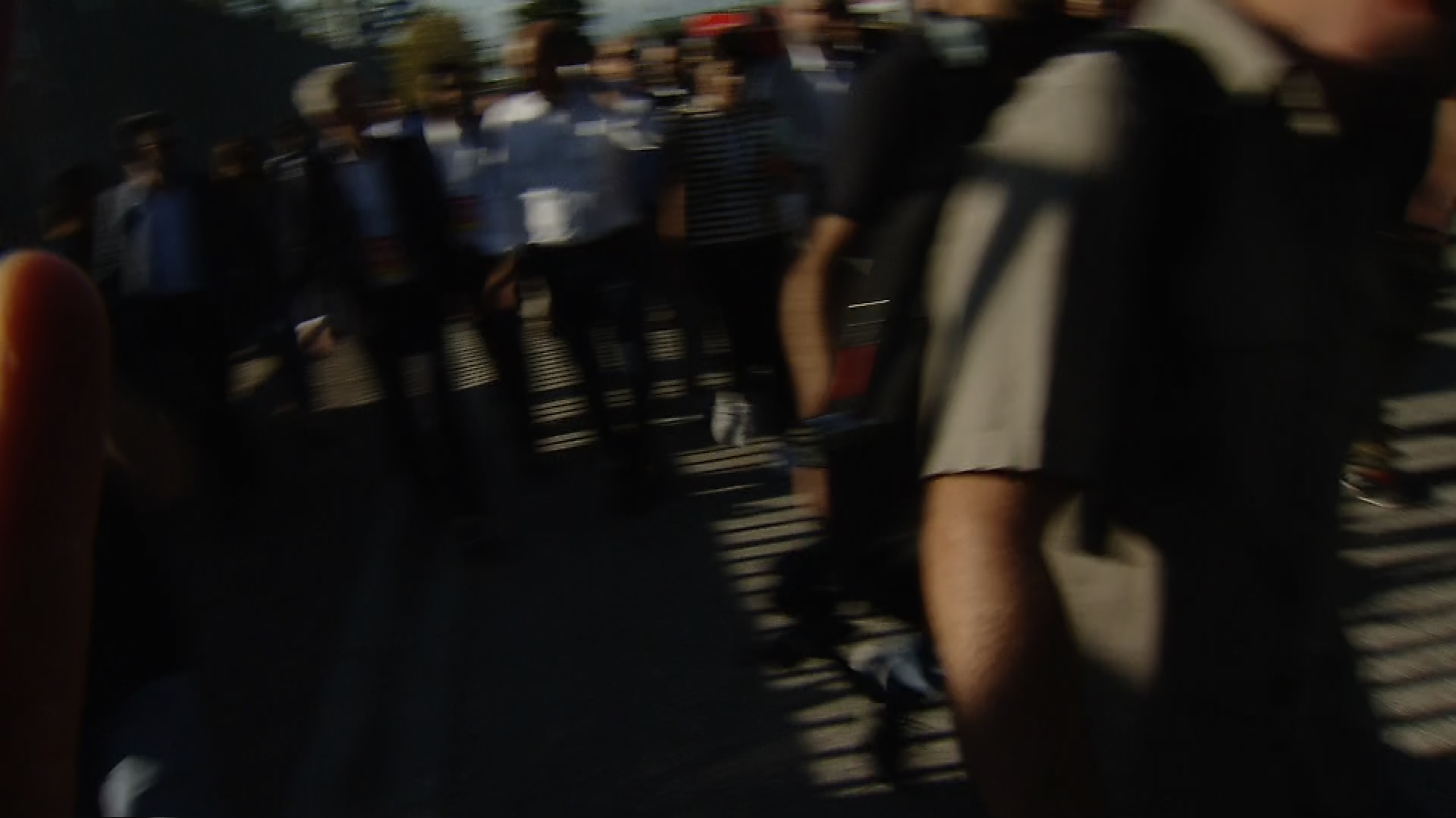

  7. in attachement the first frame of the video that I see with vlc: the 422 seems with range levels wrong
    it's not a important difference but is visible wrong.
    Comparing frame to frame in timeline with Edius they are almost exactly and I think they are coded ok (?) but I try to understand why with VLC the playback is not correct

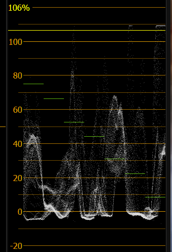

    1. Your source is marked as limited, but luma goes beyond the range. If you want a perfect copy, you don't convert the ranges. If it is to be fine (and not a 1:1 copy), then you should play with the range.

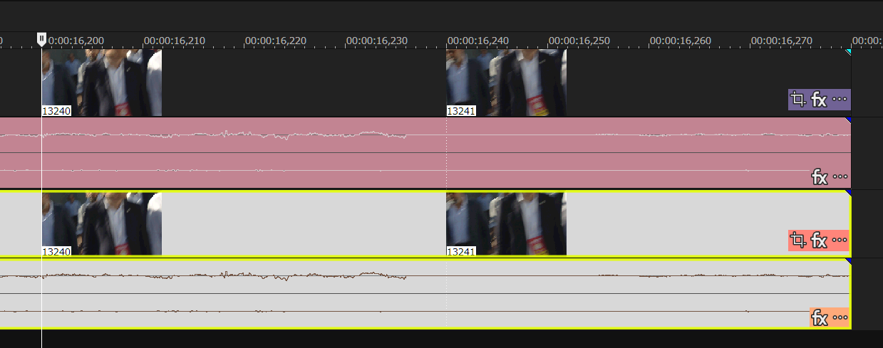

    Originally Posted by marcorocchini View Post
    ffmpeg.exe -threads 12 -y -i c:\c0021.mxf -filter_complex "[0:1] [0:2] amerge" -pix_fmt yuv422p10le -vf scale=interl=1:in_range=tv:out_range=tv -c:v libx264 -crf 28 -x264-params profile=high10 -crf 18 -flags +ildct+ilme -top 1 -an -aspect 16:9 v:\out422.mp4
    ffmpeg.exe -threads 12 -y -i c:\c0021.mxf -filter_complex "[0:1] [0:2] amerge" -pix_fmt yuv420p10le -vf scale=interl=1:in_range=tv:out_range=tv -c:v libx264 -crf 28 -x264-params profile=high10 -crf 18 -flags +ildct+ilme -top 1 -an -aspect 16:9 v:\out420.mp4
    https://www.swisstransfer.com/d/d8253104-bb67-4d51-85b6-83f5ef101dc5
    I upload the 2 different encoding: vlc seems to show a bad result on out422.mp4 like a levels range error. But both files imported in Edius seems ok
    so I cannot understand exactly where is the problem
    I checked in Vegas -- both videos have the correct colors and the audio is synced.
    Apart from the fact that they exceed the limits, of course.
