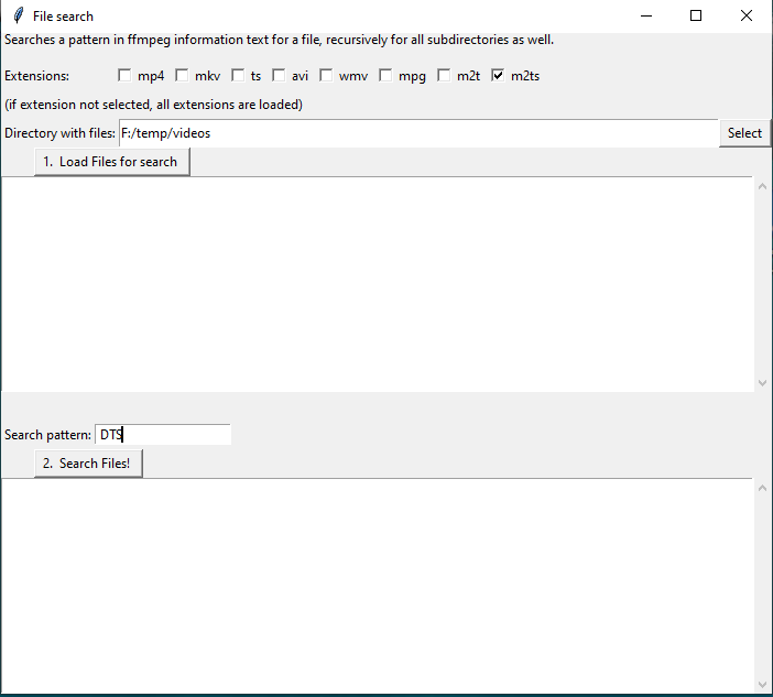

  13. some crude gui version how to get a pattern from a ffmpeg info readings
    [Attachment 88034 - Click to enlarge]
    do not forget to include spaces (before or after a pattern) to exclude not desired hits
    search pattern gui in zip
    send me a link to collect $100 thru pm , thanks
  14. @videoAI I would like to thank you for your script. The solution is very elegant.
    Believe it or not, but before Cornucopia posted on the 29, I had a solution script (Similar to yours but using dos cmd ... sed and grep). Took me a while to figure out that 2>&1 is required for the ffmpeg output. I was about to post my solution when I reread what the OP had written. No where was mentioned please, appreciate or thanks. So I did not post my solution.
    I have stopped trying to help people who show no appreciation while feeling entitled. Hard to believe that this person has 400 posts.
    Anyway, I just wish to thank you for your post. Great job.
