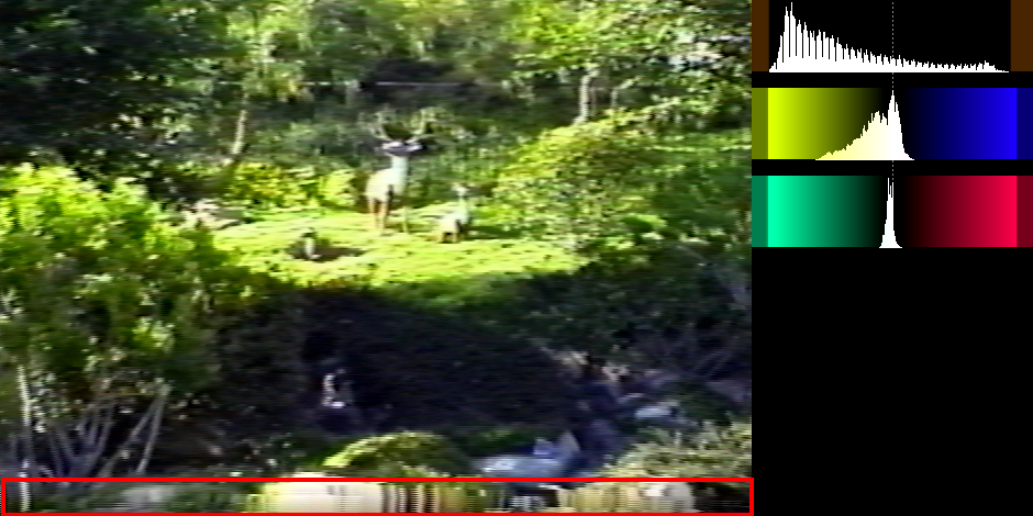

    Here is the JVC going into the s-video of the black magic. Black magic said 8bit avi
    https://files.videohelp.com/u/139455/JVC%20into%20black%20magic%20s-vid.avi
  16. Originally Posted by Riker0007 View Post
    This looks correct from a capture point of view: YUV 4:2:2 interlaced BFF, 29.97fps. (Blackmagic seems to capture NTSC with 486 lines).
    There are however some glitches at the bottom of some of the frames (too much for head switching garbage I think). Maybe this is baked into the tape and not related to the capturing process. Not sure. Is this from an edited/dubbed tape?
    (Sidenote: The luma histogram has regular gaps. Probably due to the luma expansion by the capture SW to fill the 16....235 range.)

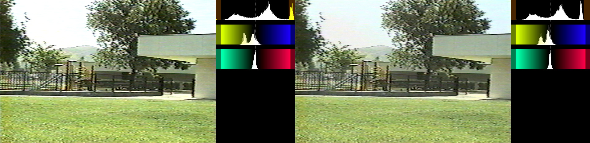

    Your capture's a bit bright. Here's a basic histogram showing the overbright at the top (in the brown, "no-go" area). The sky is the issue, which can be fixed before capture by lowering the Contrast.
    [Attachment 88361 - Click to enlarge]
    Open up your Proc Amp controls and play the tape, then lower the Contrast so you can see the blue sky. Keep the Brightness down so the blacks are still pretty dark ie not greyish or washed out. You basically want dark but not black and bright but not white.

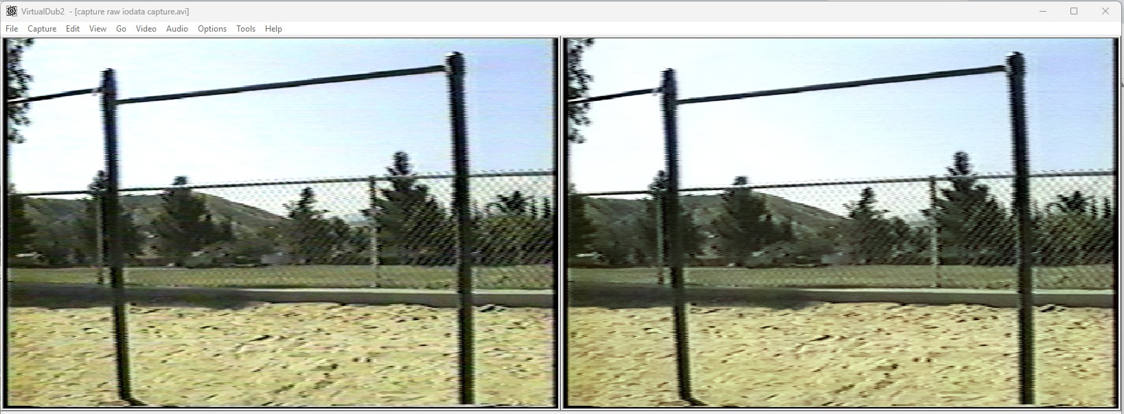

    I don't know if FFMpeg has it, but VDub2 has a great filter "Camcorder Color Denoise" which gets rid of a lot of the colour splodges. They aren't as obvious in your MOV, but are still there. Here's your capture with the CCD filter applied to the right side:
    [Attachment 88362 - Click to enlarge]
    VDub2 will output ProRes.

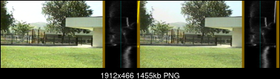

    In accordance to my recommendation here https://forum.videohelp.com/threads/418254-Info-Hauppauge-USB-Live-2-capturable-range#post2780716 the capture is fine, because is in the capturable range of the card (1-254), whith no crush of the blacks nor clips of the white (no accumulation, except maybe few pixels at Y=1 in the fence).
    If required to shrink to 16-235 range, a simple AviSynth command
    levels(1,1.0,254,16,235,coring=false,dither=true)
    is enough
