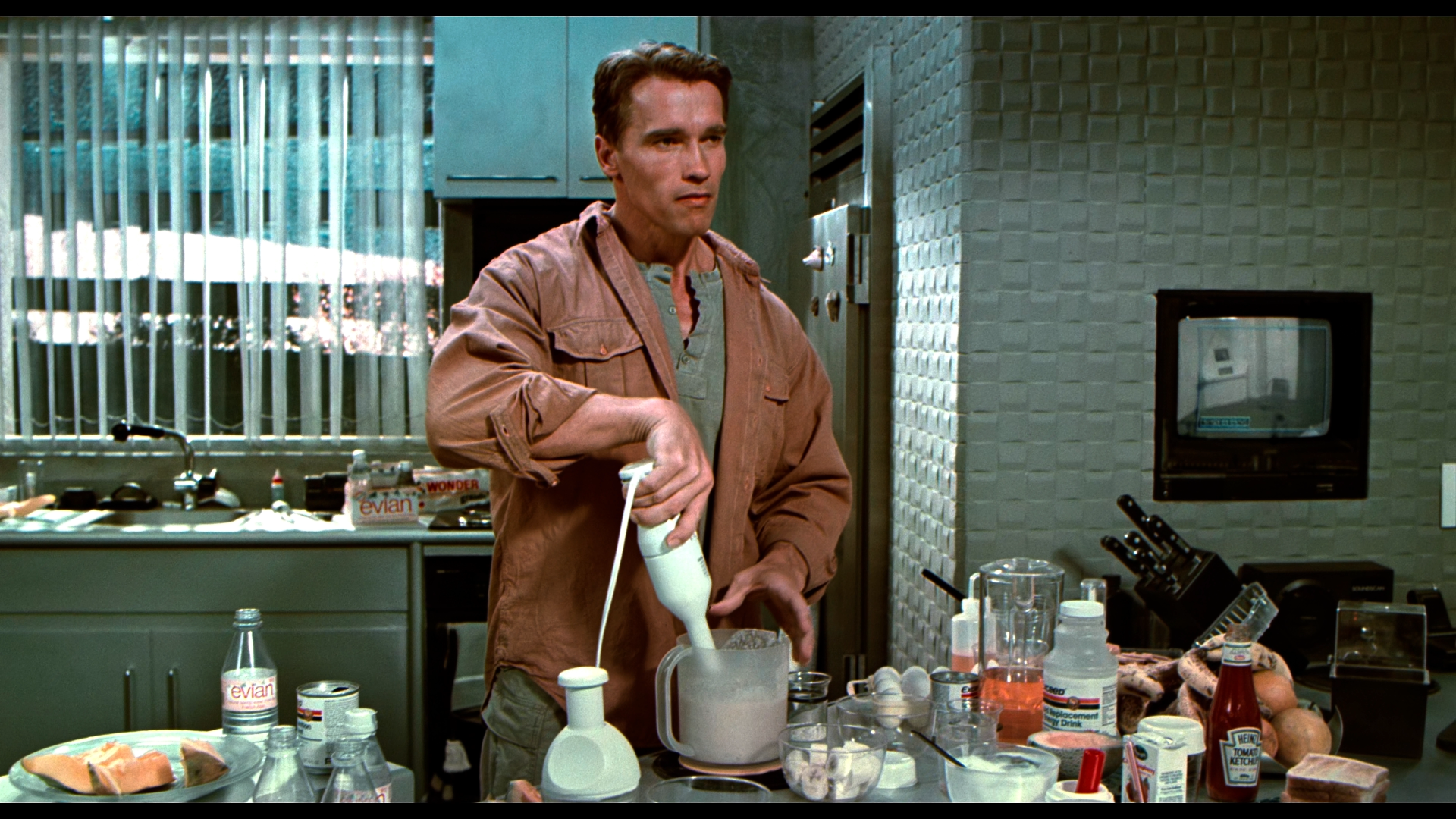

  1. I have a picture here (uploaded). Look on his shoulder, there is a red line. How can i remove that? So i mean what is this called? Ringing? I tried HQDering and it did not help anything. So i guess its not ringing. Also i tired DeHalo_Alpha, but it does also not work. Anyone has an idea?

  2. Looks like slight color channel misalignment
    one way to treat it
    mergechroma(awarpsharp2(depth=6))
  3. i tried it with aWarpSharp2 in Hybrid with Planes "chroma only" and a thick on "chroma" and it did not work (vapoursynth).
    I tried it with chromashiftSP in hybrid. It goes away, when i use Y=2, but then it also appear red lines on other objects (in the other direction). When i use Y=0.5 it does somehow not mess up too much but also fix the red line above a bit. But it is no real fix, more a workaround.

  4. I don't use hybrid (selur can help) but the equivalent in vapoursynth using awarpsharp2 port would look like

  5. Ahh, so it is basically not possible to fix the red line "globally" without handmade segments? Because i mean this is only an example, so if i want to fix all red lines, i would have to hand-fix thousands of frames by hand ? Would it work, if you do not use trim function or would it then mess up on other objects like on my try?
    If someone knows about hybrid: Can i use muvsfunc in hybrid? Is there any Option to "globally" remove this "chromatic abberation" without messing up other details? Because "handmade" frame by frame fixing is to much time consuming. Then i would have a year, till im done.

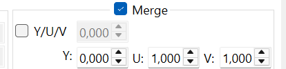

    About the mergechroma: Hybrid also has 'Merge'-options which allow you to weight YUV channels.
    [Attachment 88060 - Click to enlarge]
    Using Y:0,Y:1,V:1 will replace the chroma planes of the input with the filtered output.
    Thus you would get code like:
    clipMerge = core.warp.AWarpSharp2(clip=clipMerge, blur=2, depth=6)
    clip = core.std.Merge(clip,clipMerge,[0, 1, 1]) # merge filtered and unfiltered by plane
    So, no need to use muvsfunc.MergeChroma, but like I wrote you can use it using a custom section.

  7. SSIQ does seem to help: https://imgsli.com/NDAzMTk2
  8. Originally Posted by Platos View Post
    That relatively low depth setting for awarpsharp2 is unlikely to mess up other frames ; ie. you could probably use it globally without trim. It's easy to preview and check before you encode, and you can change the settings
    Conversely, shifting the chroma 1 direction on every frame is ALWAYS going to mess up "good" frames. The difference is the chroma alignment is guided by the luma for those default awarpsharp2 settings, so the adjustment is per frame guided by the higher resolution 1920x1080 Y channel. The chroma channels are only 960x540 for 4:2:0

    And about intendet effect: On another version it has not that strong red lines, so i think it is not thaaat intendet. But the other version is worse on other things so...
