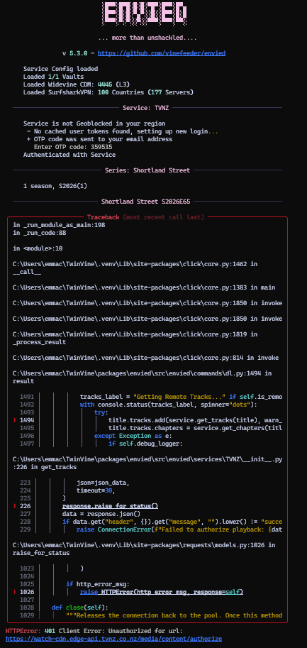

Hi everyone,
I'm hoping someone has run into this before because I'm completely stuck.
I'm trying to download an episode of Shortland Street on TVNZ. The authentication flow appears to work correctly:
OTP is sent and accepted.
Authentication succeeds.
However, as soon as playback authorization is requested, the call to:
watch-cdn.edge-api.tvnz.co.nz/media/content/authorize
returns a 401 Unauthorized (see screenshot).
I've already tried:
clearing all cached tokens and logging in again;
using the latest version (v5.3.0);
verifying that authentication completes successfully.
Since metadata retrieval works, I assume the login itself isn't the issue. It seems the authorize request is either missing something or TVNZ has changed the playback authorization flow.
Has anyone looked at TVNZ recently or knows what might be required now?
Any help would be greatly appreciated, I've been stuck on this for days
[Attachment 93044 - Click to enlarge] -
have you try update tvnz service?
Code:────────────────────────────── Service: TVNZ ─────────────────────────────── Service is not Geoblocked in your region + Using cached user tokens + Using cached session tokens Authenticated with Service ───────────────────────── Series: Shortland Street ───────────────────────── 1 seasons, S2026(65) ──────────────────────── Shortland Street S2026E65 ───────────────────────── Cached 1 Key to 3/3 Vaults 1 Video └── [H.264, SDR] | en | 1920x1080 @ 4000 kb/s, 25.000 FPS ⠋ ━━━━━━━━━━━━━━━━━━━━━━━━╺━━━━━━━━━━━━━━━ • 00:40 • DASH 6.1 MB/s 1 Audio └── [DD+] | en | 5.1 | 384 kb/s ⠋ ━━━━━━━━━━━━━━━━╺━━━━━━━━━━━━━━━━━━━━━━━ • 01:29 • DASH 6.4 MB/s 2 Chapters ├── 00:00:00.000 └── 00:23:00.000 | Credits Widevine(AAAAXHBzc2gAAAAA7e+LqXnWSs6jyCfc1R0h7QAAADwIARIQ2MNYqx5KT...) └── d8c358ab1e4a4df49771c985e6466276:699719d4d2cb70ae7fb664aab35d6f28* -

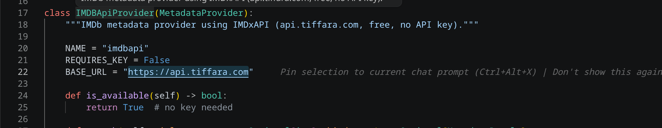

For those of you getting imdb api error in unshackle version 4.0
https://files.videohelp.com/u/33133/__init__.py
Replace file in \unshackle\unshackle\core\providers
rename original in case __init__.py_ or whatever -

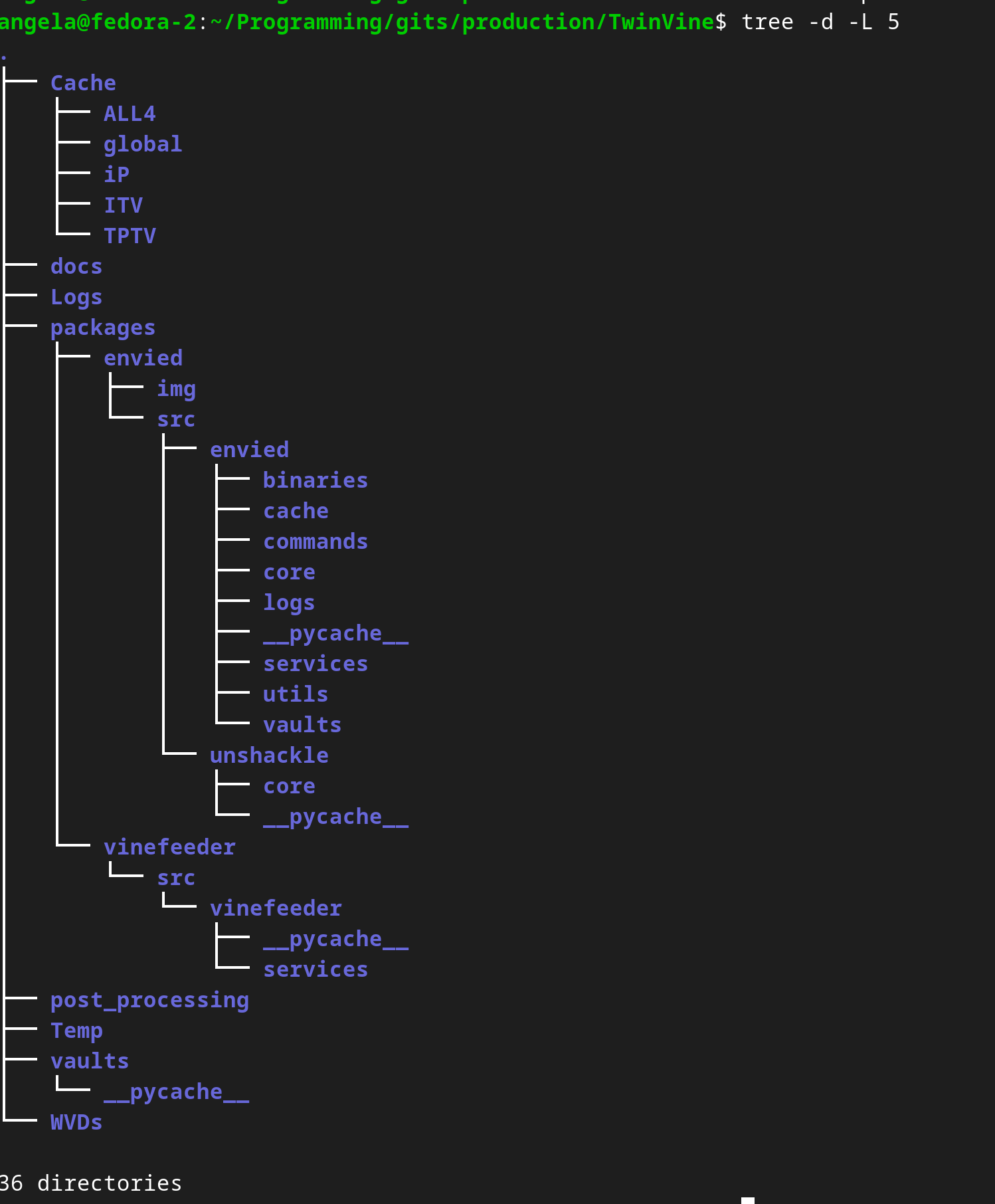

It is not.
It is simply the way TwinVine is set up in its numerous pyproject.tomls to handle the two packages of TwinVine; envied, (being an unshackle fork) and vinefeeder being a graphical search front end. https://github.com/vinefeeder/Twinvine
[Attachment 93047 - Click to enlarge]
(Probably best not to spout about things you don't understand.)Last edited by A_n_g_e_l_a; 15th Jul 2026 at 03:56.

There is a new link now.
Twinvine has been corrected for a few days but the correction is still working its way down to unshackle users.
find ushackle/unshackle/core/providers/imdbapi.py and edit the link to the new value shown highlighted below.
