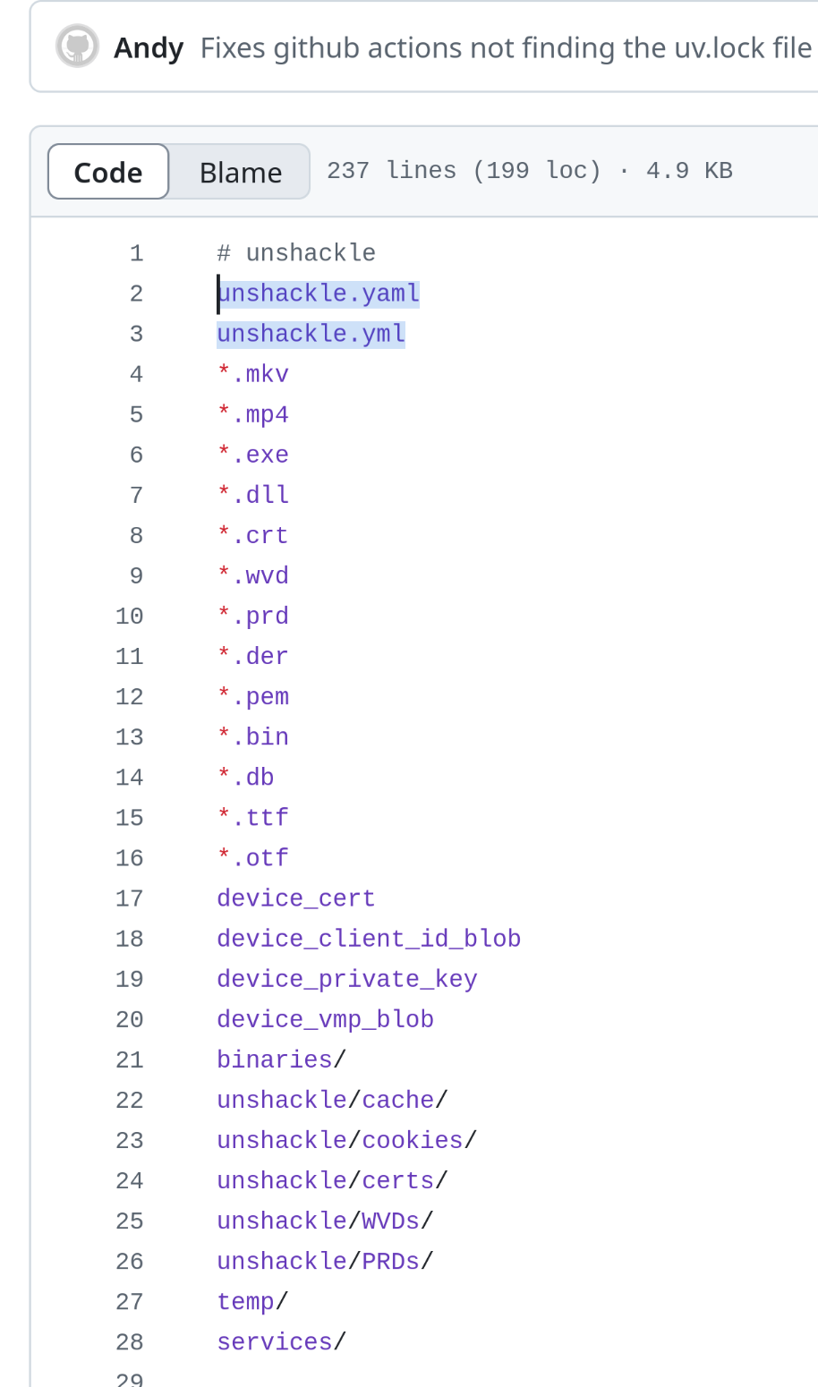

    That is an error caused by you and Git is trying to protect you against yourself. You have made some changes in the unshackle folder and git refuses the update as it would over-write your change. Ask chatGPT how to get out of the mess. Or just remove your unshackle folder and clone a new unshackle from git. I would save your unshackle.yaml first though as the new clone will over-write everything.
    That as another good point about devine - it never updated -so nothing ever got overwritten!
    I just asked chatGPT about updating but keep a local file as is. - I was thinking of unshackle/unshackle.yaml
    And got this helpful reply https://chatgpt.com/share/687f665f-6138-800e-bbae-d63bc301fff6 looks like assume unchanged is the best option.
     git update-index --assume-unchanged unshackle/unshackle.yaml

    Thanks, I'm tagging the dev @ImSp4rky
    Best solution would be for ImSp4rky to rename the 'unshackle.yaml' to something like 'example-unshackle.yaml' on their GitHub repository so that git doesn't detect the conflict when you attempt to pull?
  21. Originally Posted by PunchDrunkL0ve View Post
    And make everyone change its name before use? if you offer to answer all the questions like "how do I rename the file?" or "where does it go now I've renamed it? or my install doesn't have unshackle.yaml - what should I do?"

    Yeah, but I had to re-copy services/ and an HTTAPI.py file into unshackle/vaults because I had made a fresh clone, and that's apart from the yaml. It is not good!
    There is a .gitignore on gihub for unshackle with this:
    [Attachment 87905 - Click to enlarge]
    It probably needs the unshackle.yaml path changing to unshackle/unshackle.yaml

  27. Originally Posted by phased View Post
    Good catch
