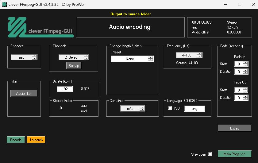

    Why not use a modern FFmpeg GUI like Clever FFmpeg .. which gives you access to AAC, AAC MF, opus, & Vorbis to name a few.
    [Attachment 87953 - Click to enlarge]
