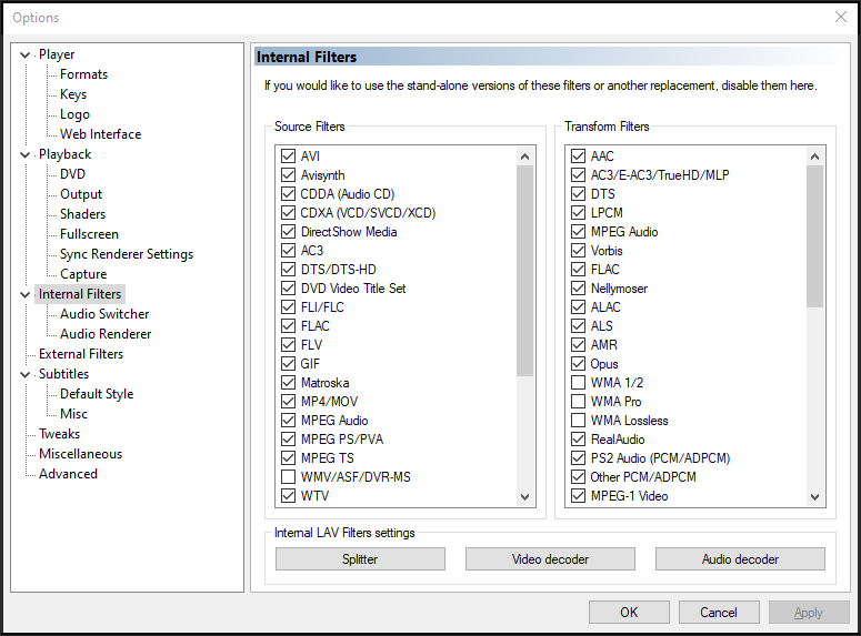

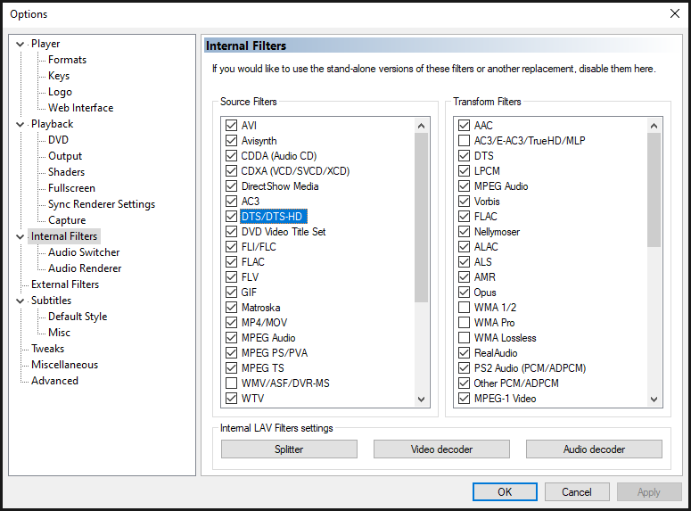

    - Configure MPC-HC to not use internal filters for EAC-3:
    For this I'm unsure on which ones to turn off. Under Source filters there is no filter for E-AC3 only AC-3. Under Transform filters there is a filter named AC3-/EAC-3/TrueHD/MLP. Do any of these need to be turned off?
    [Attachment 87833 - Click to enlarge]
    Additionally under Options > Internal Filters > Audio decoder in MPC-HC Bitstreaming is turned on for everything except E-AC3.

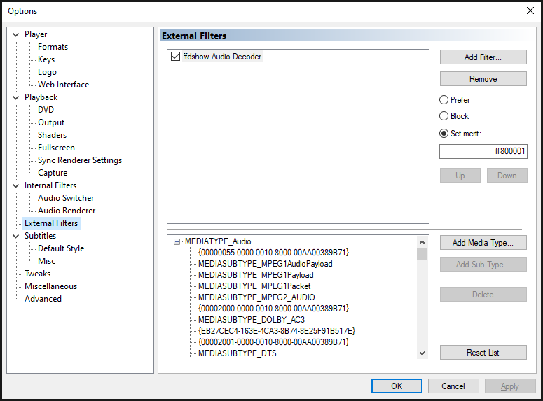

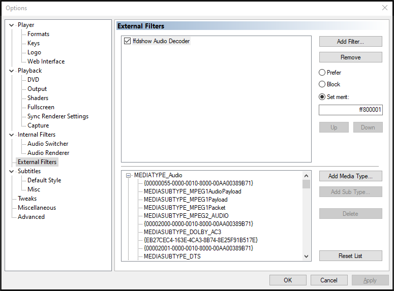

    - Add the ffdshow audio filter to the external filters in MPC-HC.
    The audio related ffdshow filters I can see in here are ffdshow Audio Decoder and ffdshow Audio Processor. I'm not sure if I should add the audio decoder or the audio processor for this. I'm guessing it might be the decoder though as the settings for ffdshow audio open in the ffdshow audio configuration. Under the media types the defaults are selected.
    [Attachment 87831 - Click to enlarge]

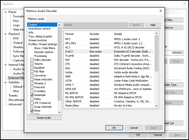

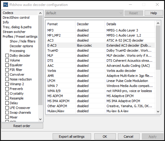

    Under Codecs all formats are set to disabled except E-AC3 which is set to libavcodec.
    [Attachment 87829 - Click to enlarge]

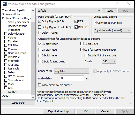

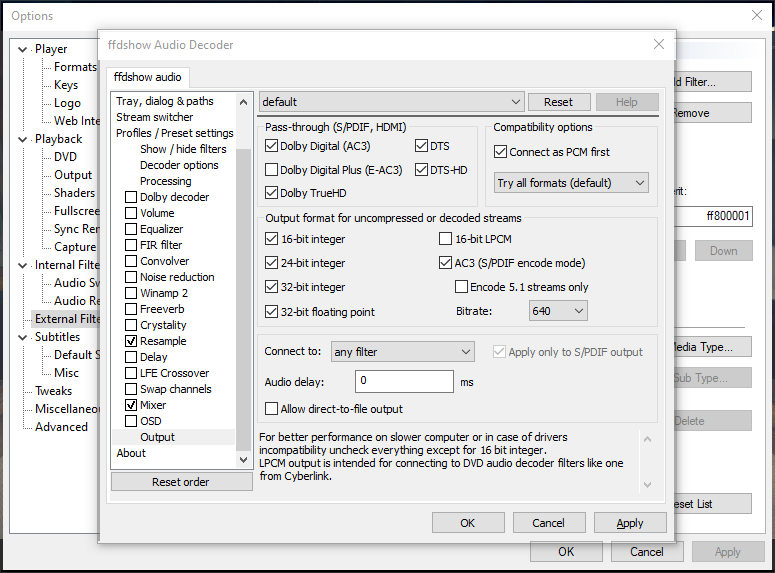

    Under Output > Pass-Through has AC3, TrueHD, DTS and DTS-HD selected but E-AC3 is not selected. Under Output > Output format for uncompressed or decoded streams the following options are selected: 16-bit intger, AC3 (S/PDIF encode mode) is selected and Encode 5.1 streams only is selected.
    [Attachment 87830 - Click to enlarge]

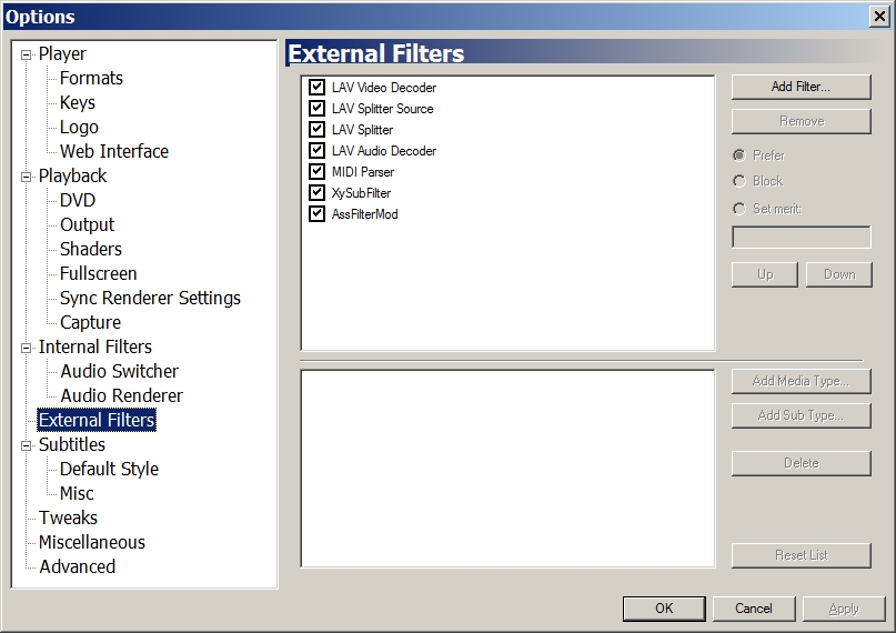

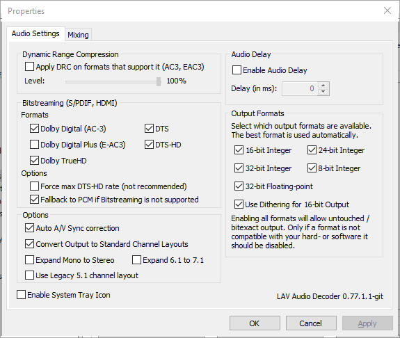

    Setting up with LAV filters MPC-HC looks like this:
    [Attachment 87834 - Click to enlarge]
    You won't need the bottom 3 as they are for other formats.
    All the Internal filters should be unchecked except for CDDA.

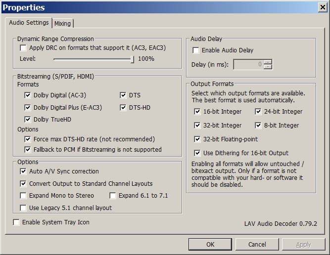

    The Audio Decoder is set like this:
    [Attachment 87835 - Click to enlarge]

    AC3/E-AC3/TrueHD/MLP unchecked under Internal Filters > Transform filters in MPC-HC settings:
    [Attachment 87836 - Click to enlarge]
    ffdshow Audio Decoder added into external filters in MPC-HC settings. Media types are left as default:
    [Attachment 87837 - Click to enlarge]
    E-AC3 set to libavcodec under ffdshow Audio Decoder config > Codecs. All other formats set to disabled.
    [Attachment 87838 - Click to enlarge]

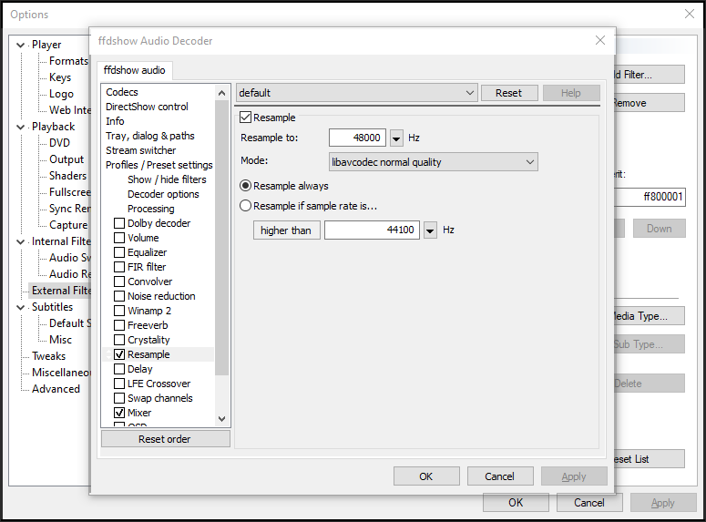

    Resample turned on and set to 48000hz
    [Attachment 87839 - Click to enlarge]

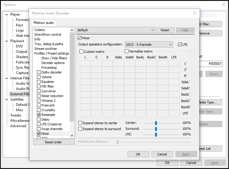

    Mixer turned on, output configuration set to 3/0/2 and LFE turned on:
    [Attachment 87840 - Click to enlarge]
    Under Output, pass-through turned on for everything except E-AC3 and AC3 was turned on under 'Output format for uncompressed or decoded streams' I left the bitrate set to the maximum of 640 to minimise any generational quality loss.
    [Attachment 87841 - Click to enlarge]
    After configuring as per above and testing the E-AC3 streams get converted to AC3 and everything else is passed through.
