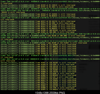

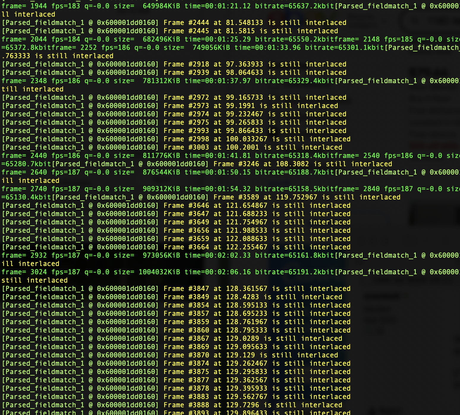

    Also, when I actually run the deinterlace script, I get a lot of "Frame is still interlaced" messages. Is that normal? Guessing it might be on the frames that are basically progressive segmented frames (ie no motion between two fields on the same frame, which then basically gives a progressive frame)?

  9. It might "normal" ; it depends on the source
    This means is after the fieldmatch filter, ffmpeg is still detecting combing, and in that command above yadif is used to deinterlace only those indicated frames
    A perfect telecine on a clean source should have no combing after field matching. You should get zero warnings
    But you often don't have "perfect" with broadcast - things are edited breaking cadences (e.g. commercial edits) , noise /compression with interlaced encoding can cause artifacts detected as combing but they might not be (false positives). Too many false positives is not ideal , because that means ffmpeg will be deinterlacing more frames, thus degrading the quality of those frames.
    Also other semi-common types of things can cause false positives, such as horizontal patterns - eg. window blinds. If those get detected you will get aliasing because of the deinterlacing applied
    Sometimes you might have to adjust the threshold for combing detection. If the threshold is too high, you might miss a combed frame and that looks bad too.
