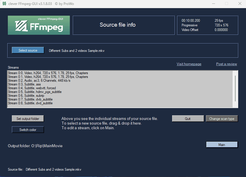

    If you want to burn in the subtitle (ever on), you have to re-encode the videostream.
    This can be done too with clever FFmpeg-GUI.
    See the tutorial:
    [Attachment 87808 - Click to enlarge]
    To test it, you could encode a short sample, g.e. 5 minutes.

    I've tried a lot, but I can't seem to get it working. I have the latest version, 3.4.3, and your example is 3.1.8.03. There's a difference in the menu, and that's making it difficult. I select MP4, but the conversion still returns MKV. I'm doing something wrong, but where?

    Okay, I'll give you step-by-step instructions.
    1) Start the app and drag your video.
    2) Click main page.
    3) Click encode video stream (you'll change the video stream only, all other streams remains untouched).
    4) Select x264 (avc) as encoder, leave all other settings as they are.
    5) Click various.
    6) Check the Burn in subtitle checkbox; if they are embedded subtitles in your video, source video is selected, but you can also use an extern subtitle.
    7) Select the subtitle you want to burn in and click OK. (You'll see a green S before target file).
    8) Click encode. Wait until is finished.
    9) Click multiplex; all streams are checked on the left. The new encoded video stream is shown in green.
    10) Deselect (on the left) the blue video stream and all subtitle streams.
    11) Select your container (mkv or mp4 recommended) and click multiplex. Wait until is finished.
    12) You will find your new video with hardcoded (burn in) subtitles in your destination folder.
