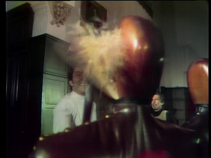

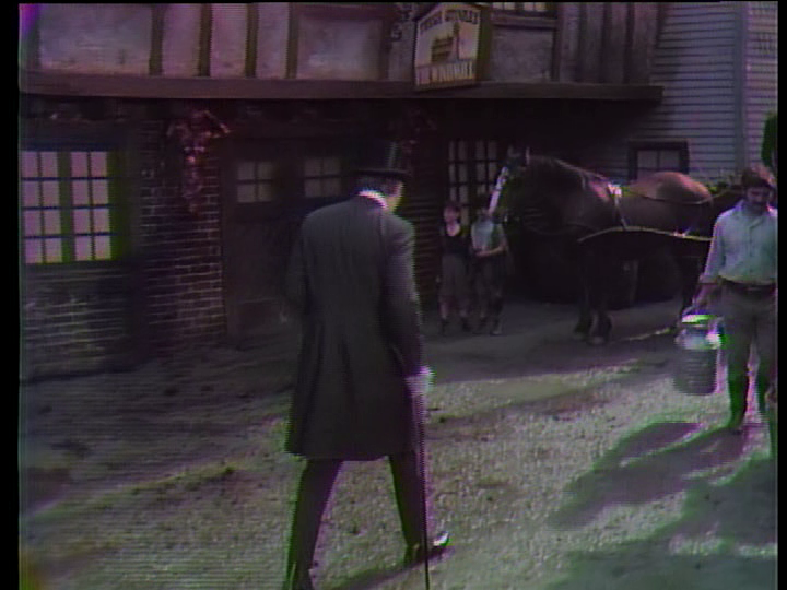

    Hello, I've been experimenting with cleaning/restoring various LD rips and LD transfers to DVD titles like "The Strange Case of Dr. Jekyll and Mr. Hyde (1968)" and "The Day Of The Triffids (1962)". Are these telecined?
    I'm wondering if its possible to accomplish the same process/possibly even better than:
    https://openmodeldb.info/models/2x-Pooh-V4
    with either Staxrip, or Hybrid?
    I have both installed, and I have pretty much every addon for Staxrip installed, and I have quite a few installed for Hybrid. I'm not an expert at either program but I've experimented with both, and have had pretty good results with both, but I know the community would know alot more than me about this subject.
    I have both on LD, but I don't have any player ATM to transfer them myself, so I've been resorting to buying the inferior transfers of the various DVD releases of those titles. The sources are either interlaced, or "mixed" because at times it appears deinterlaced, and at other times interlaced.
    anyway to clean those dotcrawl/chroma bleeding/rainbow more efficiently than QTGMC+DeRainbow+DotkillT? I've researched and am interested in "TComb" (or something better?) and was wondering if anyone had any experience using that for this type of purpose. Thank you

  2. you would need to share a sample of your source for others to judge whether a source is interlaced/telecined/field-shifted/progressive or something else,..
  3. That clip is not telecined.
    Bobbing the content, there is real change when going through it frame-by-frame (checked first 50 frames). => content is interlaced.
    Cu Selur
    Ps.: SSIQ+BiFrost help with the rainbow artifacts. (some of the red borders are still present, but over all way better)
