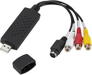

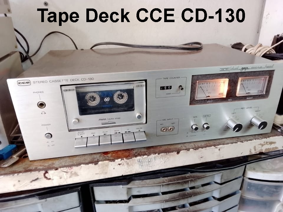

    I need help on how to capture in the best way using AudaCity, this tape deck and this capture card. I left an example of a tape capture from 1991. So, did I something wrong?
    I know that over the years the tape loses magnetism, there are also problems with fungus that damage the tape, so I want the best suggestion on how to capture in the best way using AudaCity. Thanks
    [Attachment 87721 - Click to enlarge]
    [Attachment 87722 - Click to enlarge]
    [Attachment 87723 - Click to enlarge]

    The right channel sounds OK but the left channel is weak and muffled. Are the heads in your cassette deck clean? Do you know how to clean the heads? The capstan and pinch roller should also be clean.

    Thanks man. Yes, before I noticed that the sound was very muffled, I cleaned the head using a paper towel and isopropyl, did I do it right? After that a certain amount of fungi, dirty came off, and the sound became clearer. I'll take a closer look and see what needs cleaning more. What are your suggestions?
    NOTE: I had already done the cleaning when I sent this little bit of the audio here
    This tape has a damaged part, perhaps the left one, fungi have degraded it over the years. I also don't know if it is a copy but I suspect it is.

    Isopropyl is fine. A cotton bud, also known as a Q Tip, is easier than a paper towel. Take your time. Dont press too hard on the head while cleaning or it may become misaligned.
    If the central head is worn it's easier for dirt to collect in the part where the left channel is read. Unless you have very good close eyesight, I'd use strong reading glasses or a magnifier to see the head and the dirt clearly.
    Fungus can be cleaned from tapes but it can be a little tricky to do.

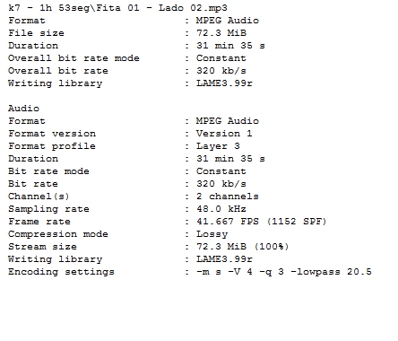

  6. I hear nonlinear distortions - sounds like source was distorted (radio recording?) also seem it is heavily compressed... I would try to demagnetize PB head and other parts of transport.
    I'm quite surprised with overall low amount of noise and spectral characteristic - seem there no noise over 10kHz - it looks like some dehiss/denoise algorithm was applied - it can be responsible for muffled sound too.
    Not sure how you captured recording attached but i recommend using sound/audio card with Line input - it should provide better results than dedicated video capture solution.
    If your goal is further sound processing then i recommend recording to PCM not lossy compressed audio format.

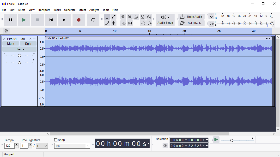

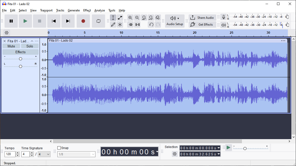

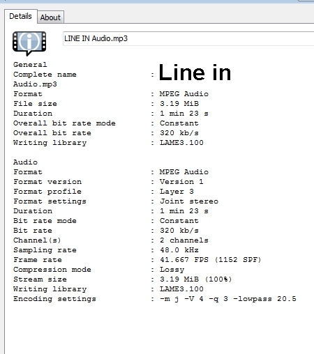

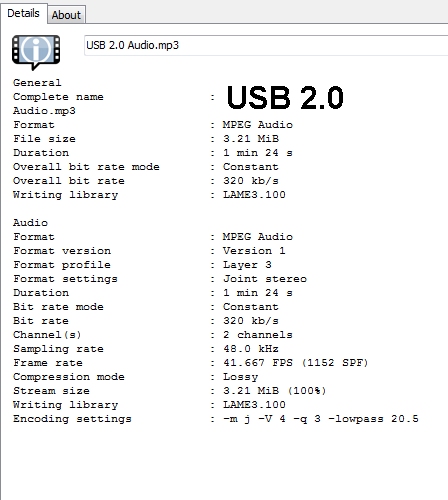

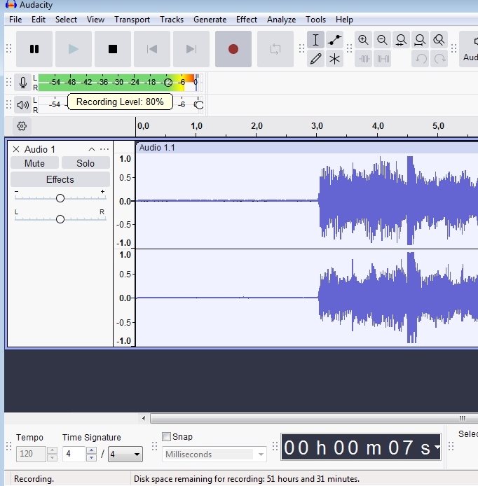

    Hello. So, I did new tests capturing with the computer's ''line in audio'' and comparing it with the previous USB. I no longer have the same tape as before, but I have this one with this song.
    I think I did something wrong when capturing via line in, maybe because I left the line in audio input at 80%?? What would be ideal? But in AudaCity I left the microphone level at 80% for both captures.
    Looking for the best configuration with your help. Thanks.

  9. Line in should deliver best quality (USB audio card with line in input perhaps even better) , MP3 is lossy compression format, audio signal level should be set to point when there is no clipping (analog signal can't be higher than so called 0dBFS - in practice you should provide some headroom for unexpected high signal levels - 6..12 dB is fine).

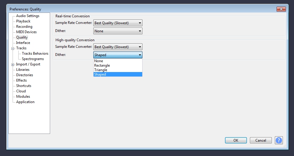

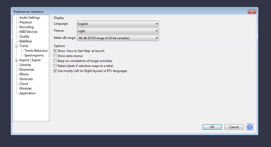

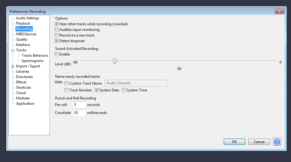

    Thanks guys. I think I understand everything, just one more thing... What should I select or not select in these parts?

  14. I would not change anything - personally i would spent some time to find loudest part and set level to maximize signal with some safe headroom (6dB headroom should be fine) - if possible try to record 24..32 bit audio (not sure what are capabilities of your HW). Probably there is no sense to go over 48kHz sampling.
    Your image shows clipping, which is distortion you added by setting the record level too high. Turn it down. You should never see chopped-off peaks in the waveform.
    The cassette program in the first file you posted is monaural even though you are playing and capturing in stereo. The player is not tracking the left channel very well, so I would keep only the right channel and turn it into a mono audio file.
    No, there is more to this. The playback meters are showing a very strong but possibly inaudible signal even before the music starts. This is eating up the headroom and causing the clipping. Something else wrong here.

    Could it be a defect in the player head of this device, because it is not capturing the left audio well?
    If it's a defect? How to check?

    Maybe the tape deck isn't working 100%, of course it's an old one, so I wouldn't be surprised if something isn't right. Is there some kind of test I can do to determine the actual condition of the audio head?
    Jun 2024
    Perth, Western Australia
    I dont know what is causing it but all uploaded files have the problem. The audio head may have a problem but it's not causing this problem. Could you try another cassette deck, or buy a USB audio cassette converter? Ideally a stereo sound card or USB interface for a computer.

    I doubt the tape is causing this particular problem. Can you find a technician to test your cassette deck?
  24. ALL tape decks that have not been used for years (in some cases for 20-30years) NEED to be serviced. First make sure the deck is 100% functional and then you'll get a more adequate help.

    It sounds like mistracking to me. In other words, the head is not lining up perfectly with the recorded track. This is a screwdriver adjustment of azimuth and possibly head height. Doesn't necessarily mean there is anything "wrong" with your deck . . . it could be a variation in alignment of the recording machine, or perhaps the tape's shape has become distorted.
