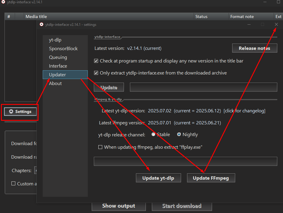

  5. Originally Posted by Obo View Post
    Nitpicks (SCNR )
    - to be clear (if it isn't anyway): for ErrorFlynn/ytdlp-interface you'll also need a yt-dlp "installation": the yt-dlp.exe file from @cholla's link. And: you should keep that version up-to-date for YT downloads.
    Is already installed but you need to update

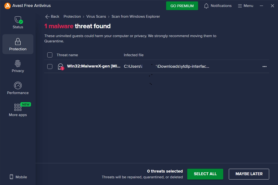

  8. @ Goku73,
    The download from the link has a virus detected by Avast: Wln32:MalwareX-gen MlSC
    Is this a false positive ?
    Also is this program for 64-bit only ?

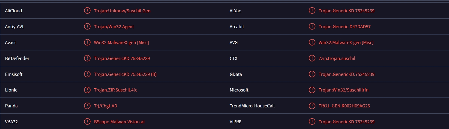

  13. Originally Posted by Goku73 View Post
    From this page? https://github.com/ErrorFlynn/ytdlp-interface
    There are two links on this page for 64 and 32 bits, and I haven't seen anyone complaining about any viruses.
    The link https://github.com/ErrorFlynn/ytdlp-interface is OK.
    Then I select "latest" under "Releases".
    It goes to version v2.14.1.
    I select this link: https://github.com/ErrorFlynn/ytdlp-interface/releases/download/v2.14.1/ytdlp-interface_x86.7z
    I have 32-bit Windows 7.
    I save the download to my Downoads folder.
    This is what Avast detects:
    [Attachment 87710 - Click to enlarge]
    This is a scan at VirusTotal website:
    [Attachment 87711 - Click to enlarge]

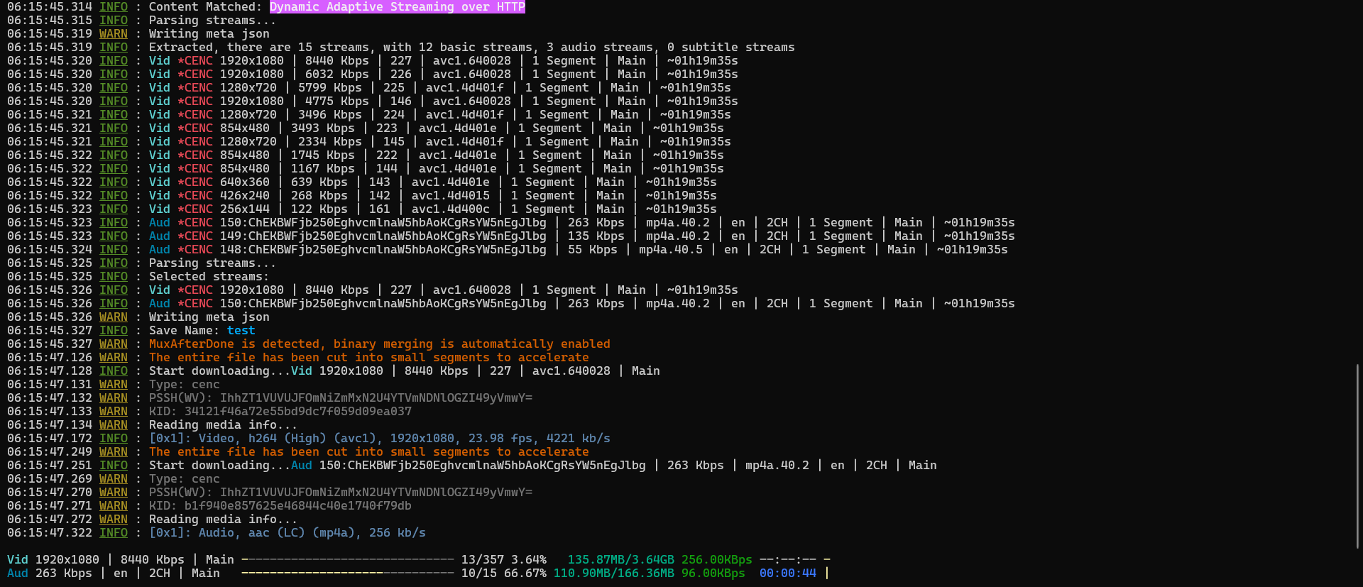

  17. Originally Posted by cholla View Post
    @ slayer36,
    No I do not want this video.
    I got it from this topic:
    https://forum.videohelp.com/threads/418412-Help-with-Geoblocked-Free-Youtube-Video
    The OP wanted it. I tested it & got the DRM warning.
    Another forum member cedric8528 was able to download it somehow & uploaded it for the OP.
    I just posted it as an example since you asked.
    oh, thanks for informing, i just started downloading the video
    [Attachment 87718 - Click to enlarge]
