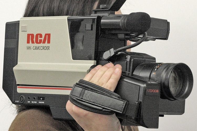

    Originally Posted by cholla View Post
    That being said I would not compare the RCA VHS camcorder to any of the above cameras.
    I wish I had taken it back to where I bought it for refund.
    It was the RCA camcorder I wish I had taken back NOT the FUJI.
    I thew it away long ago.
    This is what the RCA I had looked like:
    [Attachment 87775 - Click to enlarge]
    What a ripper. I had a Panasonic that was almost that big; the VTR part was extra, hanging off the other shoulder!
    The levels in "clip" probably are a bit high. Whether that's caused by the DVD process or the tape remains to be seen.
