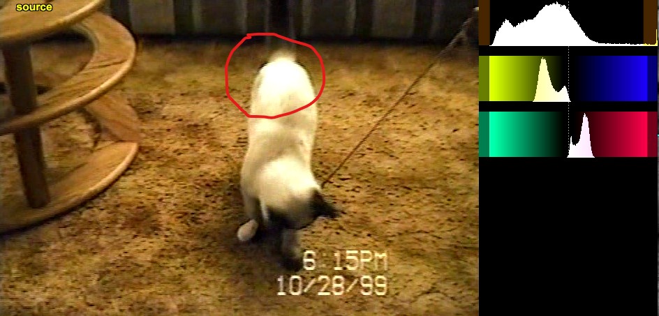

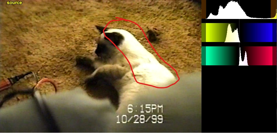

  14. Originally Posted by lordsmurf View Post
    Originally Posted by cholla View Post
    I will see if I can find something.
    I look forward to it.
    Here are 2 I did yesterday & today.
    The PetDub.vob is from a RCA VHS camcorder I had at the time.
    The VHS tape is from 1999.
    The T2.vob is from a commercial VHS tape.
    I did use a Grex to remove the Macrovision.
    The VCR combo unit used a Magnavox ZV450MW8 (To Play the VHS tape).
    The DVR recording unit a Magnavox H2160MW9.
    First to the HDD & from there dubbed to DVD.
    Clips done with FFMPEG.
  15. The PET has badly blown out and clipped brights, loosing all details in the cat's fur.
    Not sure whether it is like this from the videocam or from the digitization process.
    Otherwise with the typical mpeg2 DVD recorder artefacts.
    The Terminator is half-D1 (352x480) telecined film.

  16. @Sharc,
    The cat is very close to the same on the VHS & if anything the DVD looks a bit better.
    Also the VHS video was made in 1999.
    The half-D1 is the way the Magnavox records.

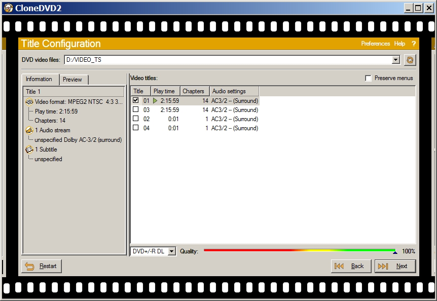

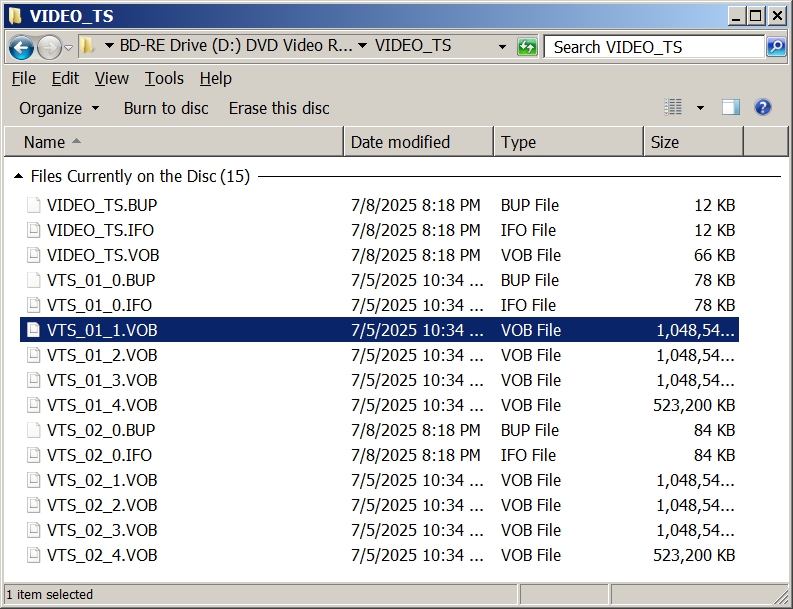

    Actually there are a double set of the same on the recording.
    If I'm suppose to merge them or DVD players merge them.
    I have never checked this I usually just use one of the vob sets.
    This is what it looks like in Windows Explorer:
    [Attachment 87762 - Click to enlarge]
    This is in CloneDVD2
    [Attachment 87763 - Click to enlarge]

  21. @cholla: It should be no problem to merge the .VOBs of your DVD structure into one file (per title) using MakeMKV, or Avidemux, for example.
    We are getting off topic I am afraid .....

  22. @ Sharc,
    I now do not believe merging the vobs will help.
    This still produce two videos that are the same.It would just be on a single vob.
