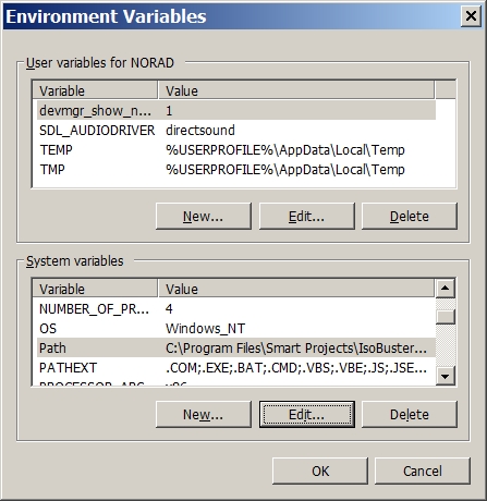

  11. Originally Posted by Ygramul View Post
    Thanks again. I now realize that I can't possibly avoid copying the .exes to the input folder. It looks like that was the culprit all along. Now everything works fine. I can just change the number of seconds to trim and it's nice and fast
    @ Ygramul,
    It is working for you this way. So you might want to leave everything as you have it.
    This is to inform on how I have this on my Windows 7 32-bit.
    There is only one .exe in my C:\Program Files\MediaInfo\MediaInfo_CLI. It is: MediaInfo.exe
    I have ffmpeg.exe & ffprobe.exe in this folder: C:\Program Files\ffmpeg\bin
    I have this location in Environment Variables.
    Select the button on the lower right.
    [Attachment 87697 - Click to enlarge]

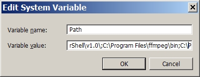

    Highlight Path & select Edit.
    [Attachment 87698 - Click to enlarge]
    In Edit add: C:\Program Files\ffmpeg\bin;
    Be sure to use the semicolon at the end.
    Then select OK , OK , & OK again.

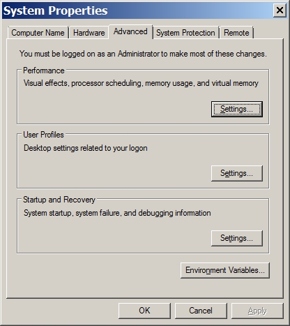

    [Attachment 87699 - Click to enlarge]
    This is why my OS finds ffmpeg.exe & ffprobe.exe with this part of davexnet's batch script.Post# 25
    set ffmpeg_path1=ffmpeg.exe
    set ffprobe_path1=ffprobe.exe
