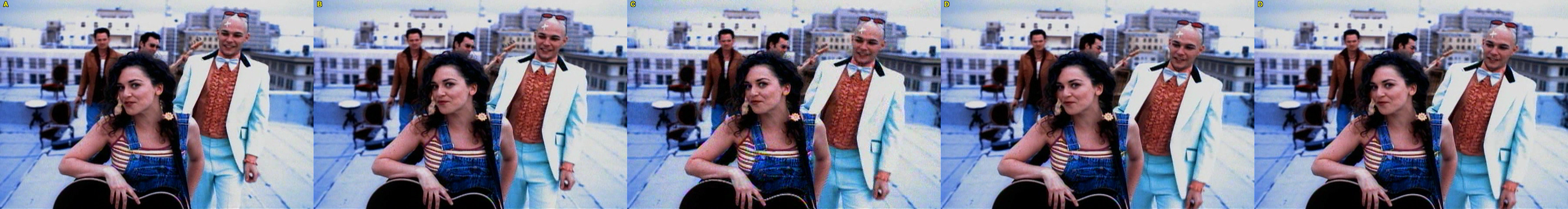

    Sure, I can go through the process in a bit more detail. So what we start with is a sequence such as this:
    We've got a clean frame "A", then another "B", but then what follows are a pair of blended frames. I've marked these as "B+C" and "C+D". The last frame is again clean, "D". So we need to extract frame "C", which currently only exists as a "ghost" in the blended frames. Srestore() has a post-processing mode for this purpose and that is actually all we need, since the video is not interlaced.
    Srestore(omode="pp2")

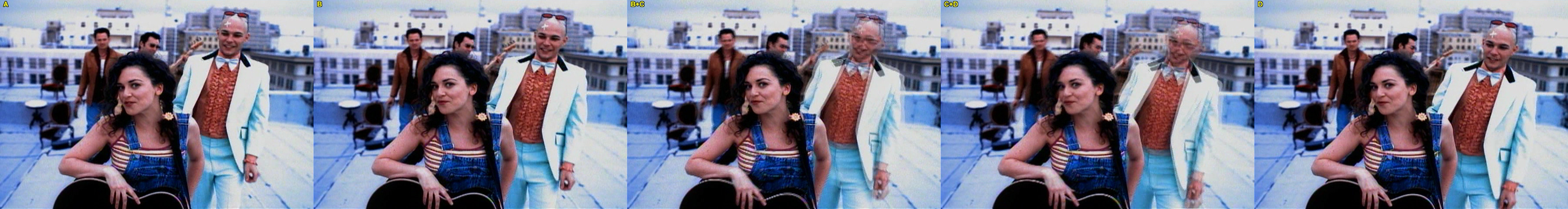

    You can try the other modes also and see what looks best. After running that bit of script we now have the following sequence:
    Frame "C" has been extracted from the blended frames with some clever substraction using the clean "B" and "D" frames for reference. Observe for example the man's left hand as it approaches the bottom of the frame.
    All that remains is to remove one of the now duplicated "D" frames to achieve smooth motion. TDecimate() is good for this purpose:
    TDecimate(cycleR=1, cycle=5)
    The parameters instruct the filter to remove one frame out of every five and it will automatically pick one that most appears to be a duplicate. This brings the frame rate down to 4/5 of the original, i.e. from 29.97 to 23.976.
