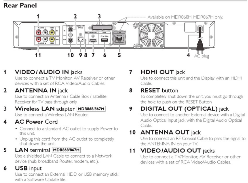

  10. Does the Magnavox MDR867H/F7 have a "factory reset" method?
    My Magnavox DVR's have menu reset.
    Then inside the DVR there is a black button microswitch reset.
    Then on some units you use the "control" buttons on the DVR to do a factory reset.
    I'm not sure with your Magnavox MDR867H/F7 as I did not dig that deep in the manual.
    Unplugging the DVR may help.
    Leave it unplugged for at least 15 minutes.
    I found this:
    #8 it a reset button.
    [Attachment 87545 - Click to enlarge]
    Jun 2025
    Cary, NC
    I'm gonna stay away from opening the DVR up. I don't see any control buttons. I have tried the reset on the back but that didn't work. thanks again.
  12. After looking closer at the manual.
    The reset is the button accessible from the rear panel.
    So no need to open your DVR.
    I wish mine was like that.
    The "control"buttons are the Play,FF,RR,Channel up & down & Power.
    These are not what are used on your DVR as far as I can tell.
    On some units these bring up a "Hidden" service menu.
    I guess the next step would be to contact support for the Remote Control manufacturer.
    You never posted a model number for the remote.
    Universal remotes usually have a factory reset method.
