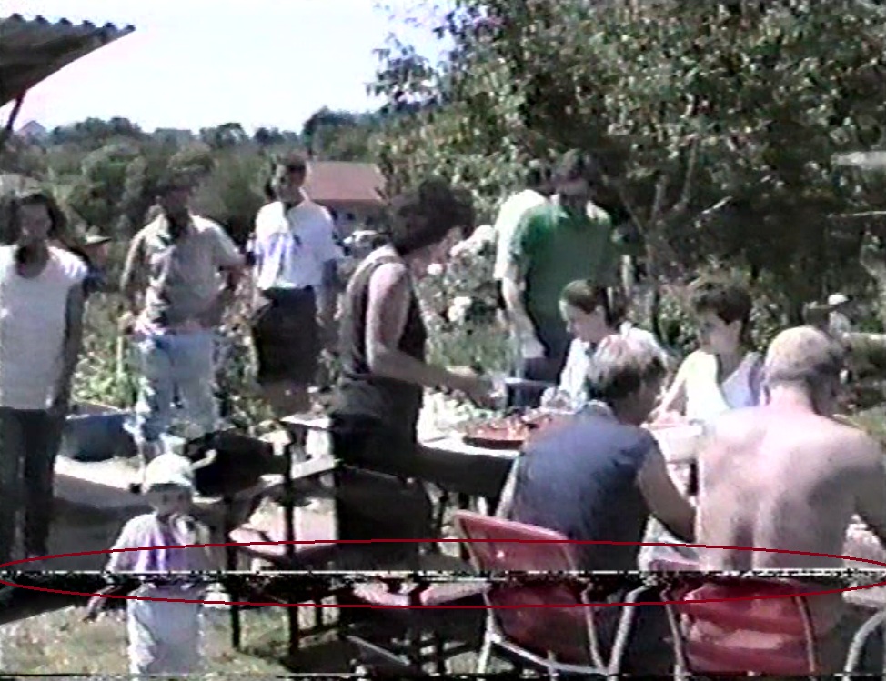

  4. I think full time TBC would fix this problem
    [Attachment 87465 - Click to enlarge]
  5. I'm not a TBC expert so I could be wrong, but I think those artifacts are not time-base errors. I say that because everything on the same horizontal line as the artifact is intact and not shifted to the right.

    I'm not entirely sure a frame TBC would fix those line streaks, highly unlikely. If you don't have any frame drops or inserted, no audio drift, you're good to go. Those are probably baked in the recordings.
  7. No frame drop. Could be that is baked like that because tape is 35 years old. So you think there is no need for me buying frame TBC don't mean because of this tape, generally speaking.

    You could just recapture the problematic parts several times and compare the captures.
    If the same problems appear on the the same spots it is indeed "baked in" on the recording.
    And then if your ES10 can not can clean it up not much else can do any better i think.

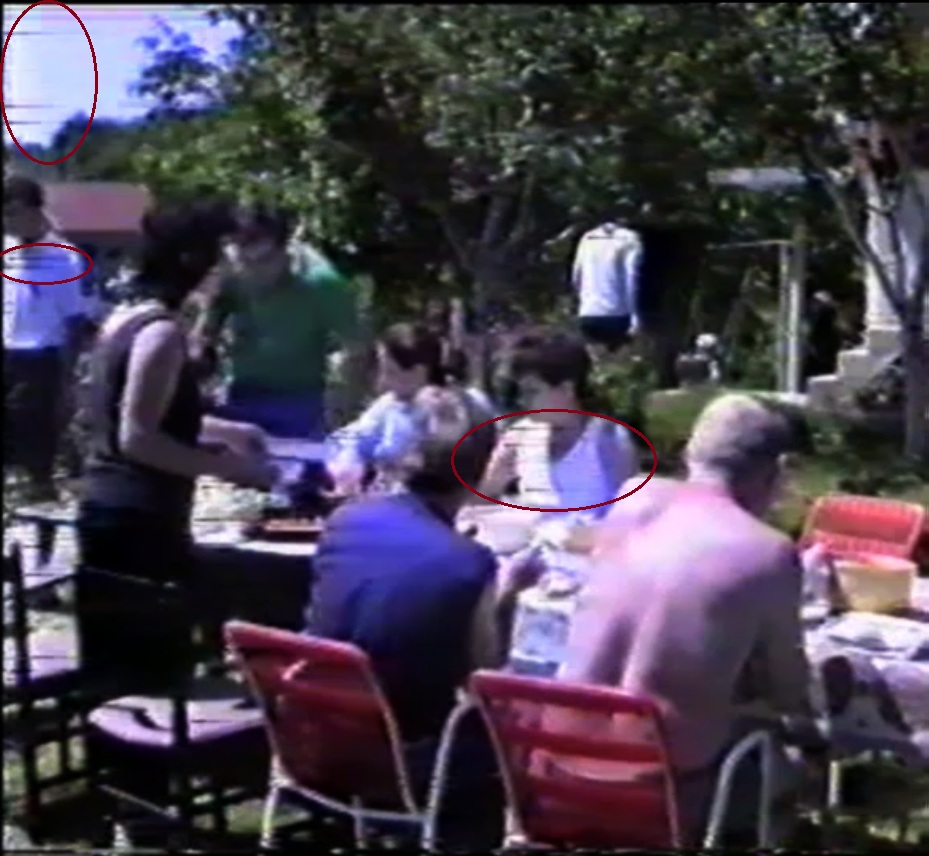

  11. I tried now same tape on my V8000 vcr and there are almost no lines. On JVC's there are a lot of them all over the place. I always try tape in few vcr's to check the quality. It don't have a rule, sometimes V8000 play bad quality tapes better sometimes both JVC does.

    Black streaks in white spots usually RF clipping, this happens for example with S-VHS recordings played on a regular VHS due to limited bandwidth in the processing circuitry or bigger video head gap, If one VCR plays it batter than the other it could indicate head wear or failing electronic components.

    Believe me I serviced all of them, all electronic is good and serviced, heads are clean and have no problem on all my vcr's.
    So I don't know really what the deal is here, all other tapes play without any problem just this one is doing this. But now from time to time on this tape when capturing on V8000 vcr, I got this lines for like half seconds random, sometimes thin sometimes a little thicker but I noticed them on JVC's capturing also, so it must be tape problem, maybe full-time TBC would fix that lines that pops from time to time.
    [Attachment 87466 - Click to enlarge]
  15. Black streaks on high contrast transitions I associate with either dirty or worn heads at the time of the recording or playback. Full line horizontal static or distortion is typically a line dropout and they'll look different from one VCR model to another as there is some significant variability in dropout compensation between VCR models, many of which aren't that good at concealing them. Lastly, it could be the tape itself has a small crease in it, though usually if that is the case, the same area of distortion will persist for many frames instead of just a single frame.
    If it is really random, so not on the same spots and same time, you could do multiple captures and edit/join the correct parts together?
  17. Have you played around with the tracking control on the tape(s) that exhibit the problem?

    I didn't. I just capture it with V8000 vcr and it looks very good comparing it to JVC's caputre. So that few lines that pop from time to time are on tape because I rewatch the tape and they pop on every time on same place. So I guess it's worn old tape problem, maybe TBC could fix it but I don't have one so I don't know.

    All other tapes play nice on my JVCs without any lines or problems so could be that camera which recorded that video was already bad, but some vcr's are better in reading those bad recorded tapes, some are struggling to reproduce it correctly.
    I also noticed when camcorders or vcr's have misaligned heads and you record something with them and try to reproduce on various vcr's every single one of them will reproduce it differently. Some will have problems like my JVC's some like my Panasonic will reproduce it with minor interference or non interference at all.

  19. For this single critical tape I would probably take the best capture (from V8000) and try to fix this dropout/tracking error in post (filtering maybe, or replace the bad frame(s) by adjacent good frames, or substitute the bad frame(s) by motion interpolated frames. You can find examples and scripts for similar fixes the forum, or over at doom9.
    P.S. And it is no surprise IMO that different VCRs will handle misaligned recordings differently. This is probably the reason why some recommend to play the tapes with the same device as it was recorded - at least in such "misaligned" case.

    Don't keep your hopes up, A TBC will not fix that kind of problem, I'm 99% sure. If you want to drop several hundreds dollars on TBC for other purposes that's fine.
    I would also check the ground brush for the head drum, When you remove the stator you should see a spring in a hole in the brass ring and a tiny steel ball at the bottom. This may not fix your problematic tape but may address some other static issues.

    Ok, thanks for the tip, that's what I thought too.
    But if that's the problem it would appear on other tapes too, it only appear on this one.
