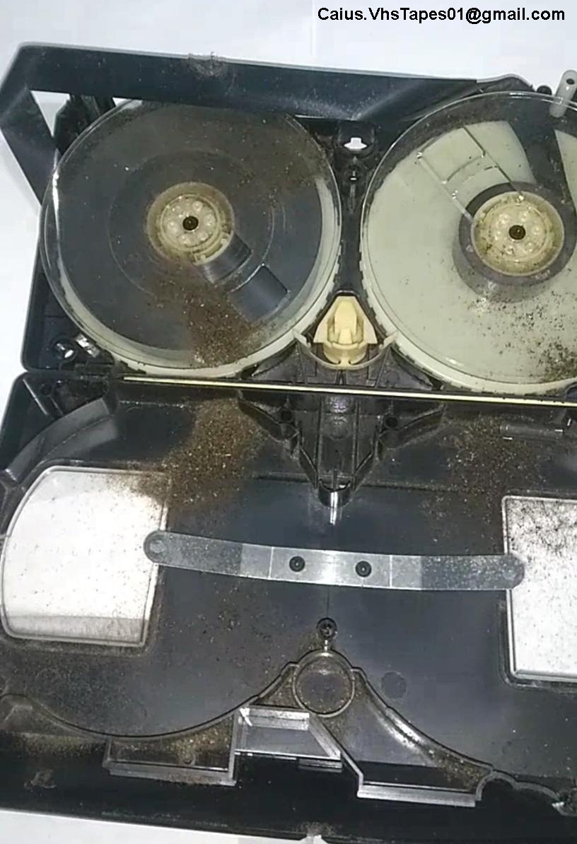

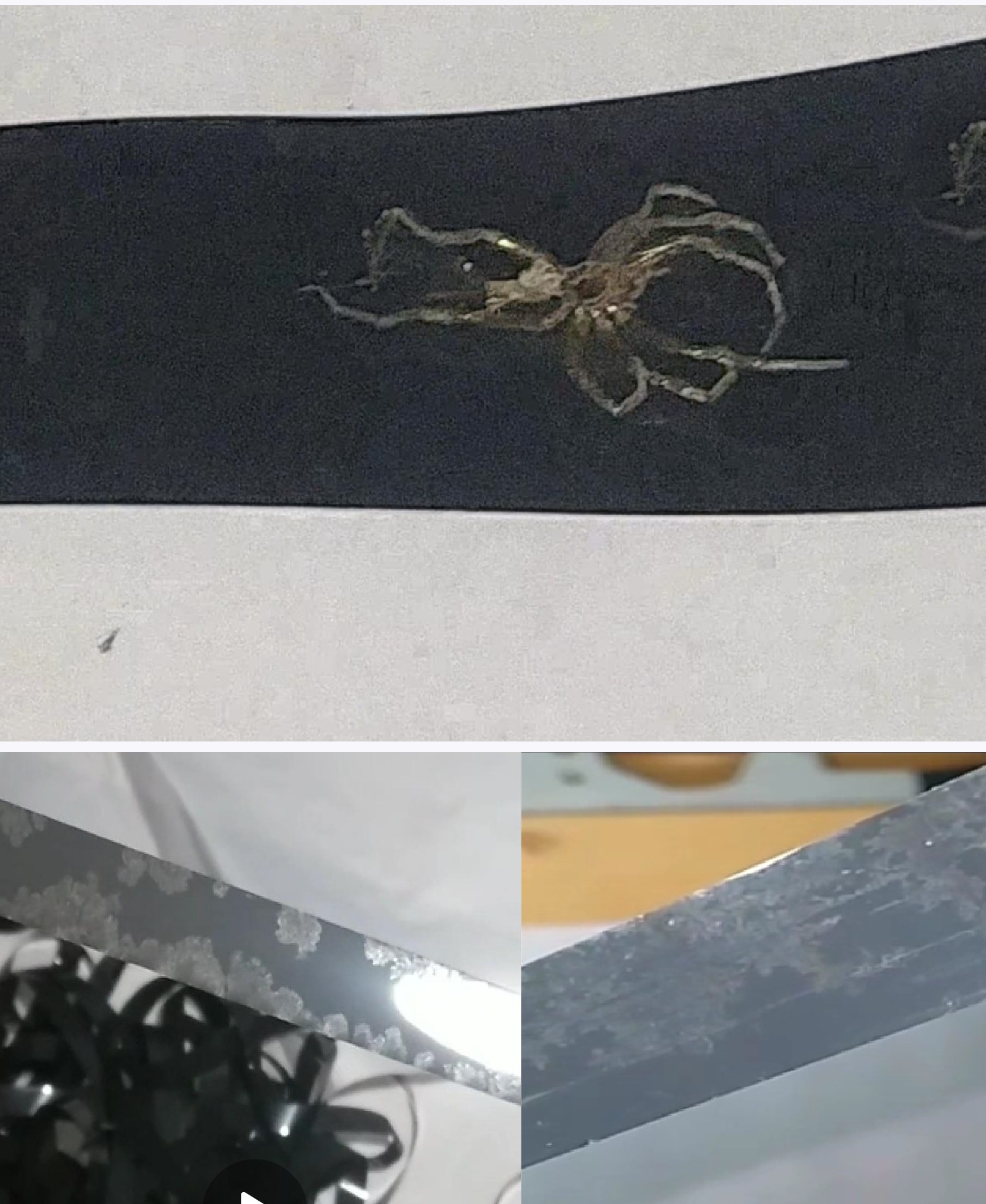

No, although I have found some tapes with parts missing from the edges, they were certainly eaten by certain insects. (An example on a pic) Maybe other larger species that ate not only the mold but also pieces of the tape, but 99% of them only eat the mold and leave this chemical spread across the magnetic tape. I even took a part of a tape like that to a chemistry lab, where they told me that this slime which penetrated the tape it's chemicals from insects, which certainly release when they are feeding on the mold. When I do the restoration, where these stains were, the carbon is corroded by a few %.
Here's an example: all this dirt is the decomposition of dead insects, which spent years and years there making cocoons and feeding on the mold.
[Attachment 87478 - Click to enlarge]
[Attachment 87477 - Click to enlarge]Last edited by Litaiff; 18th Jun 2025 at 08:39.
What a mess. Obviously the eaten edges can't be restored. It's now an expert cleaning task before attempting play back of what remains. Cleaning the debris from inside the shell is probably a lot easier than cleaning the fragile tape. The eroded edges may also damage VCR rotating heads as they catch on the edges at high speed. It might be worth emailing Peter Brothers at Specs Bros.

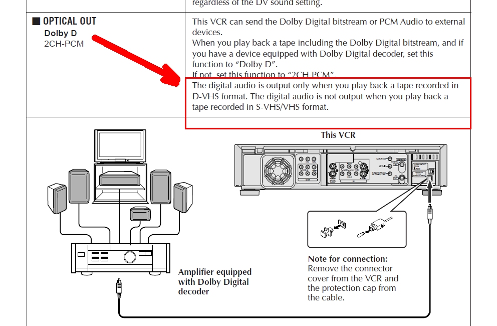

This same device has a digital audio output option, I even have the cable, but the capture cards I use do not have these inputs.

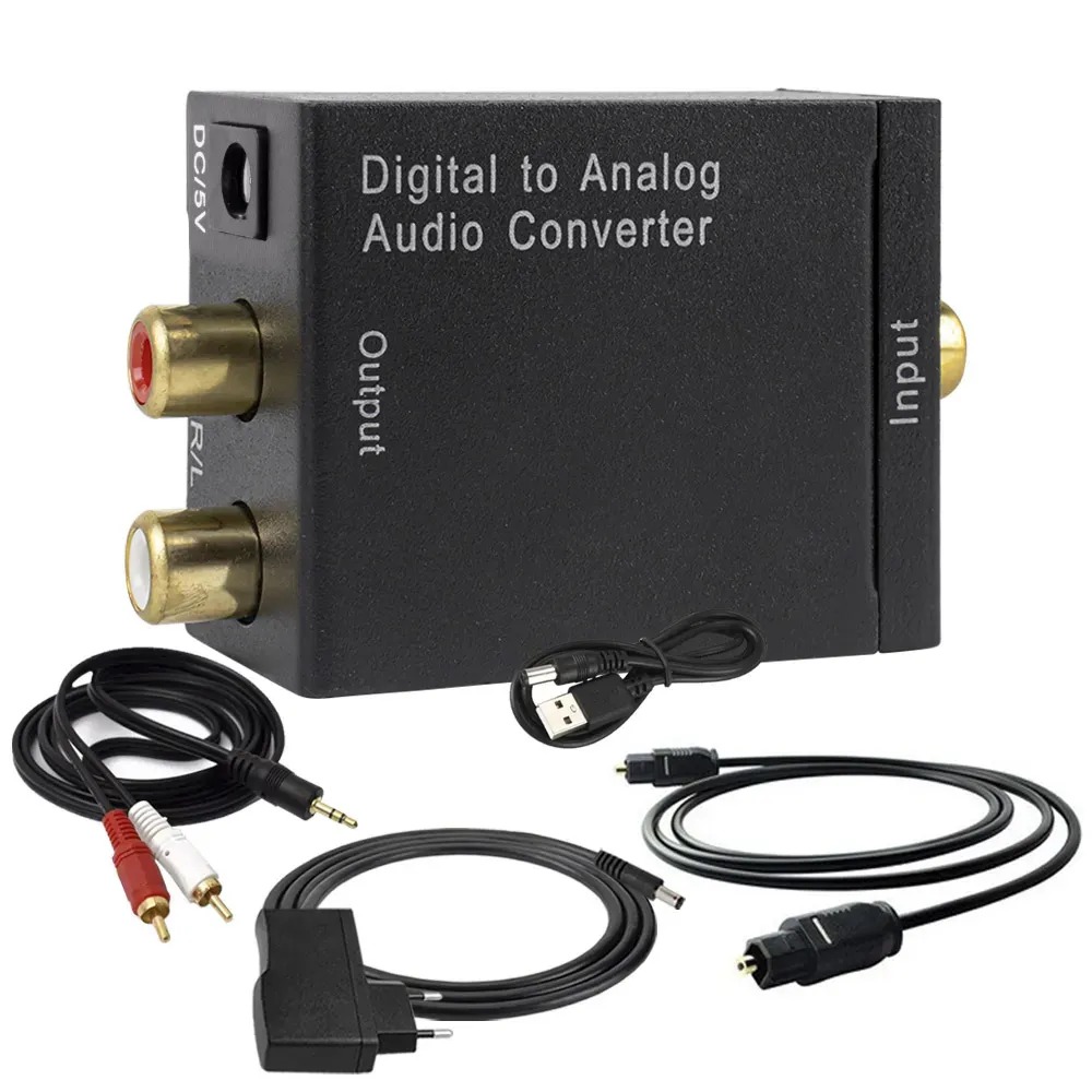

Would it work with this converter and maybe solve the problem?

I just tested the optical to analog audio converter, well, it didn't work. But I learned a lesson: ''Read the manual first!!'' That's why it didn't work.
[Attachment 87681 - Click to enlarge]
Well, someone here should have warned me sooner, but this converter should come in handy one day.
