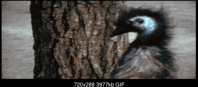

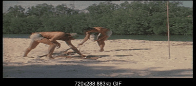

    Originally Posted by franciscola View Post
    I still have some questions regarding PAL though, particularly the malcolm-sample I've attached, which is part of a group of 60 or so videos. There are clearly jaggies present but I can't tell if it's interlaced, telecined, or just a poor job by the publisher of converting interlaced/telecined to progressive.
    The second PAL video labeled timeless-sample I believe is progressive but labeled as interlaced for DVD compliance, correct?
    Analizing the fields both videos are "progressive" (PsF), i.e. the two fields are from the same moment in time.
    The first suffers of a horizontal distortion in one of the field (look to the pole on the rigth; bad master, bad A/D conversion, who knows) giving an overall dirty picture when the frames are built.

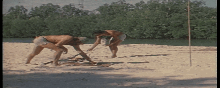

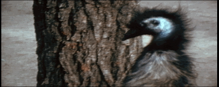

  19. The Malcolm is a bit odd: It is progressive video (PsF) but with an insane skew/wiggle between the odd and even fields.
    The horizontal wiggle can be reduced using
    ffmpeg -i "malcolm-sample.mkv" -c:a aac -c:v libx264 -crf 18 -vf "bwdif=mode=0:parity=tff:deint=interlaced, format=yuv420p, setsar=12/11" "malcolm_out.mp4"
    There is still some vertical jitter though .... maybe someone else has a better fix using ffmpeg.
  20. Originally Posted by Sharc View Post
    Thank you for all your invaluable help on this. I have a printout of the thread and will be referring to it until I completely grasp recognizing telecined video. I've done a ton of testing on numerous videos so far and the fieldmatch filter has worked great, so I'm probably close to getting started on the full collection.
    Regarding the Malcolm video, luckily this sample is part of probably the worst film in the set in terms of quality (both audio and video). It's almost 50 years old and was only published in Germany because the Australian rights seem to be muddy, so it may be the best they had, though your fix makes for a big improvement already.
