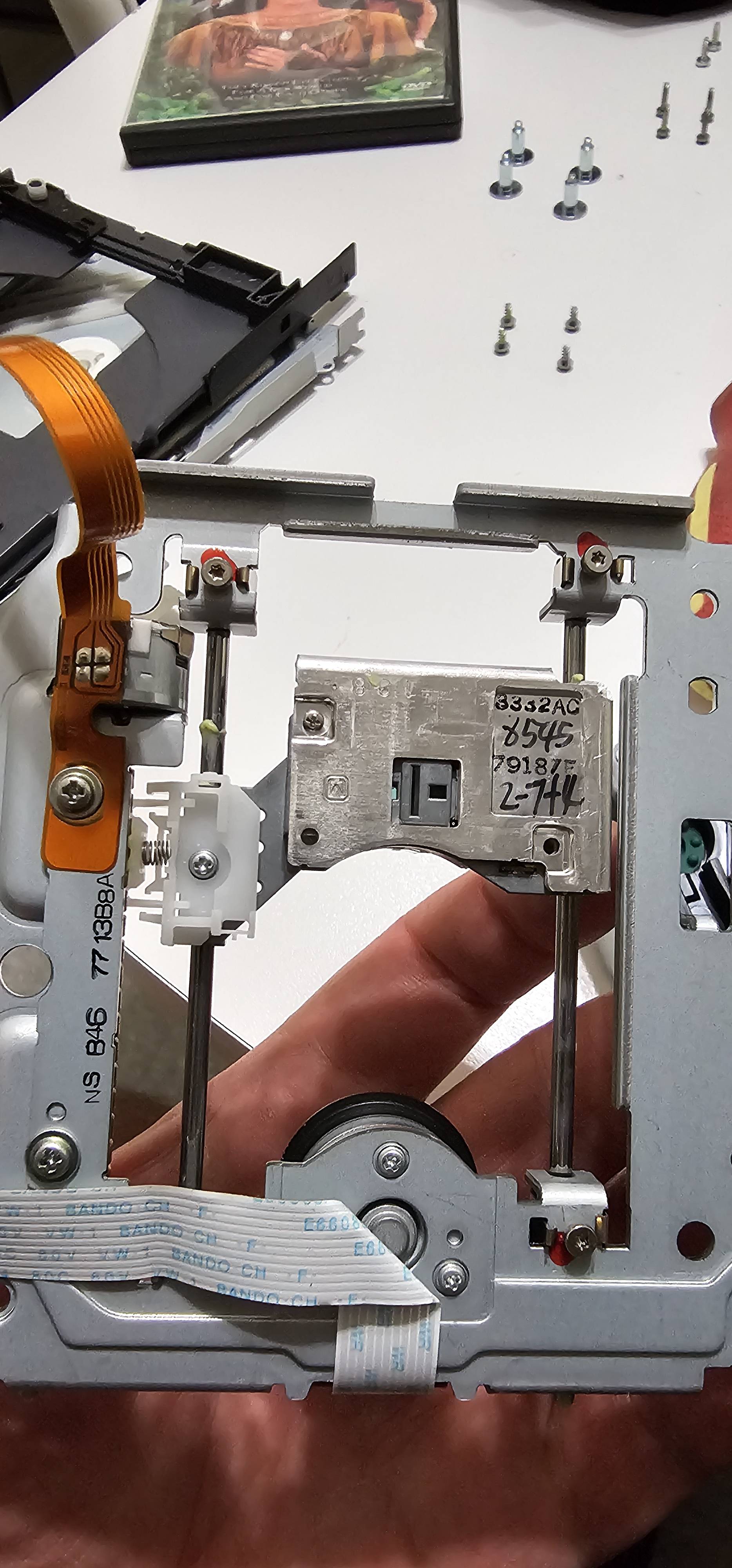

    I understand, but I would have liked to be able to repair mine if possible.Is there a way to get another laser?
    [Attachment 87388 - Click to enlarge]

    I changed the laser, the laser light comes on but the motor turns for a few seconds, restarts 3 to 4 times like that. Then to write noread. And if there is no DVD in it, it says no disc. Do you have an adjustment to make on the laser when replacing it? If I do the Ch Up and Eject and Rec code, the SERV mode is on board and if I write 6.5 it indicates NO 04. On the internet it seems to be mentioned as a chip or PCB problem but I don't see any swollen capacitor.
