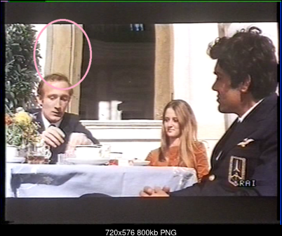

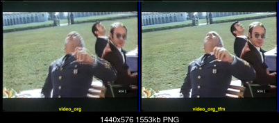

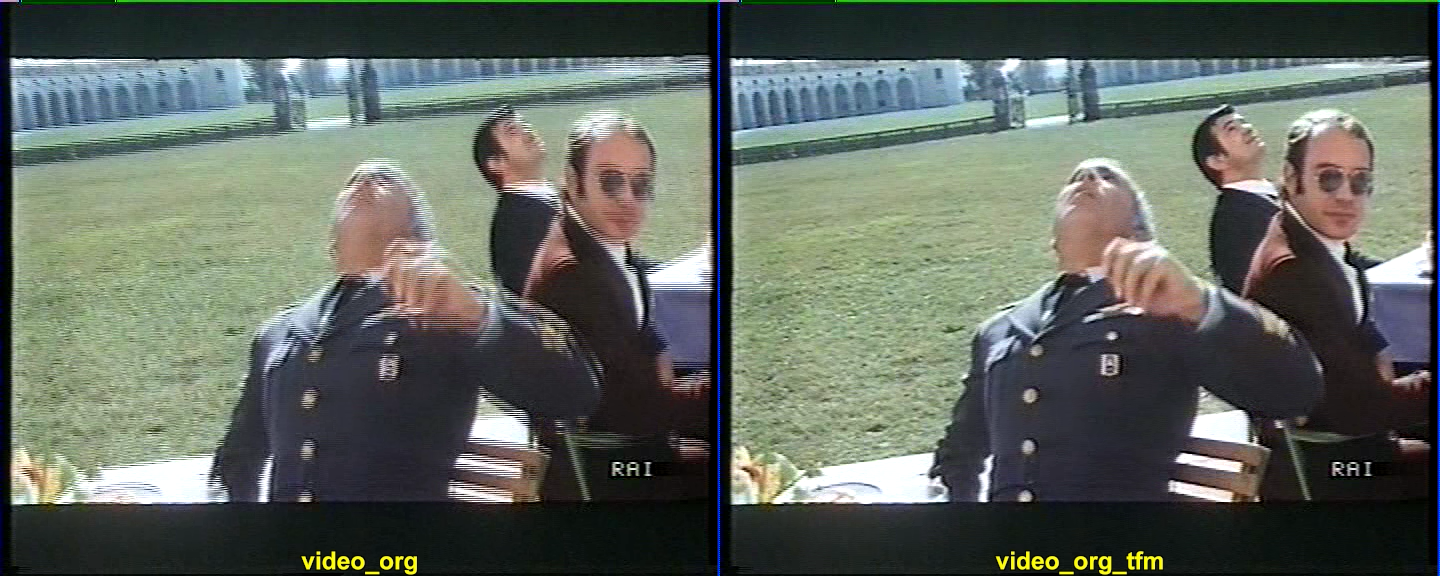

    The fields are PsF, but with a phase-shift. I fixed them with TFM(order=1, mode=0, PP=0, slow=2, field=1), no post-processing of residual combed frames of needed. I did not check all frame in details, so if you find some you can adjuste the TFM parameters or use QTGCM as Selur properly suggested:

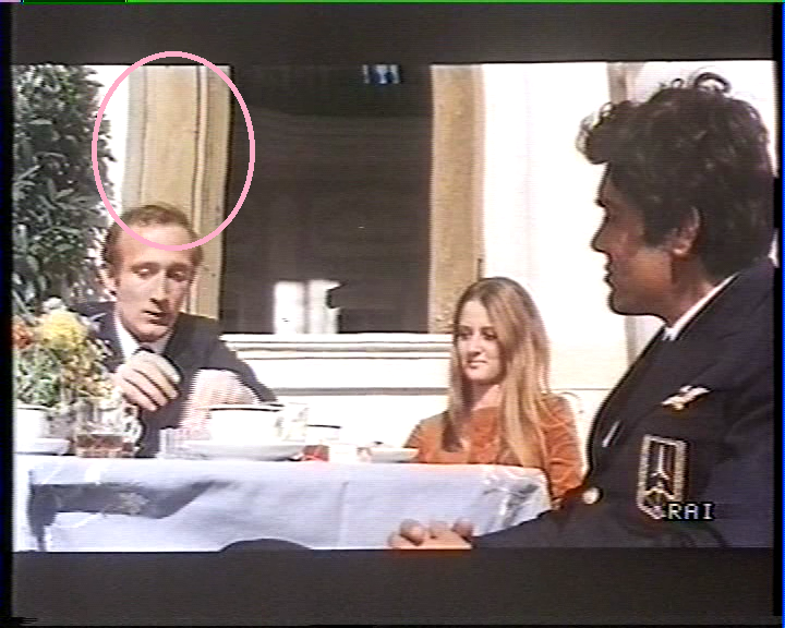

    The capture suffers of line time errors, because probably no TBC has been used:

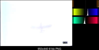

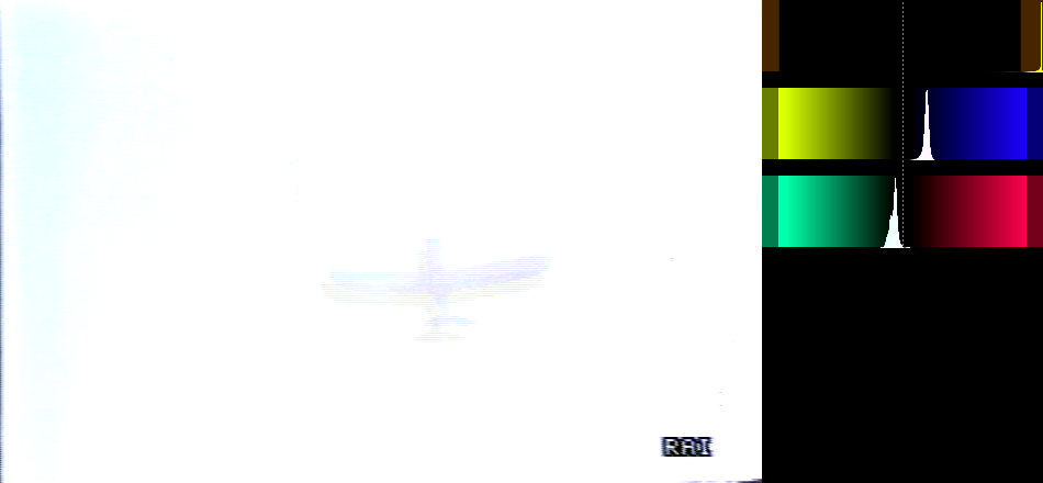

    The capture suffers of clipping in the whites, because probably no level control has been used:

    	trim_end=0
    video_org_trim=video_org.trim(trim_start,trim_end)
    # cropping
    	crop_left=14	# | rimozione esatta delle bande nere sinistra, sopra, destra e del disturbo sotto
    	crop_top=62	# | 720-(14+12)x576-(62+74)=694x440
    	crop_right=12
    	crop_bottom=74
    video_org_trim_crop=video_org_trim.crop(crop_left,crop_top,-crop_right,-crop_bottom)
    # TFM
    video_org_tfm=video_org_trim_crop.AssumeTFF().TFM(order=1, mode=0, PP=0, slow=2, field=1) #.TFM(order=1, mode=0, PP=0, slow=2, field=1, display=true)
    #eval("video_org_tfm")
    #stackhorizontal(\
    #subtitle(video_org,"video_org",size=28,align=2),\
    #subtitle(video_org_tfm,"video_org_tfm",size=28,align=2)\
    ### denoising
    denoised=video_org_tfm.TemporalDegrain2(degrainTR=3)
    ### sharpening
    sharpened=denoised.LSFmod(defaults="slow")
    ### adding borders
    restored=sharpened.addborders(crop_left,crop_top,crop_right,crop_bottom)
    return(restored)
