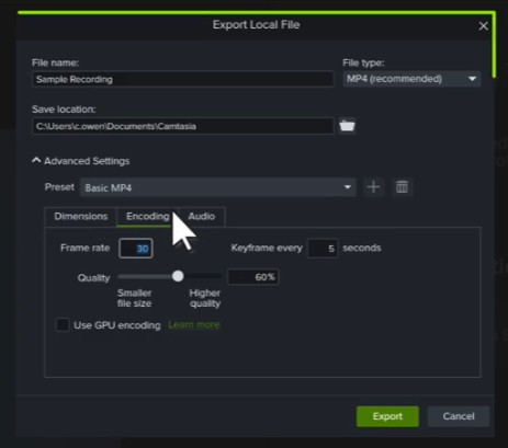

    @A941, have a look at this Camtasia tute:
    https://www.techsmith.com/learn/tutorials/camtasia/export-share/
    In particular, note the "quality" setting in the Advanced options:
    [Attachment 87312 - Click to enlarge]
    Reduce the quality to achieve the file size you want.
