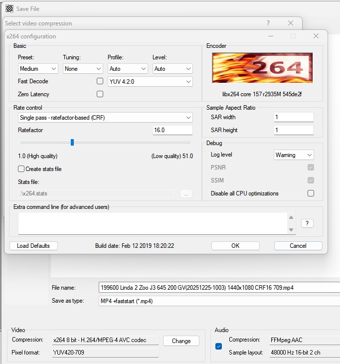

    Interesting. I'm getting L4.2 for both CRF 16 and 8000kbps at 1440x1080:
    General
    General
    Complete name                            : I:\Linda\Exports\199600 Linda 2 Zoo J3 645 200 GV(20251225-1003) 1440x1080 CRF16 709.mp4

  9. Originally Posted by Alwyn View Post
    Your x264 preset was probably much lower (medium or slow?) than the OP's. See for example the number of ref frames (4 vs 16!).
    The OP appears to be on the 'veryslow' trip
    May 2005
    Australia-PAL Land
    I use the default: Medium.

  11. Notes on device compatibility:
    Some HW DVD/Bluray players/TVs even reject to play L4.2. Maximum is often L4.1. Also, for .mp4 container the only audio accepted is AAC, and for .mkv container mp3/DolbyDigital/DTS. Similar, maximum framerate for 1440x1080 is 30fps rather than 50 or 60fps to be compliant with L4.1.
    Pretty much wild west with surprises. The manuals should tell. These devices are made to play DVD and bluray discs first hand.
