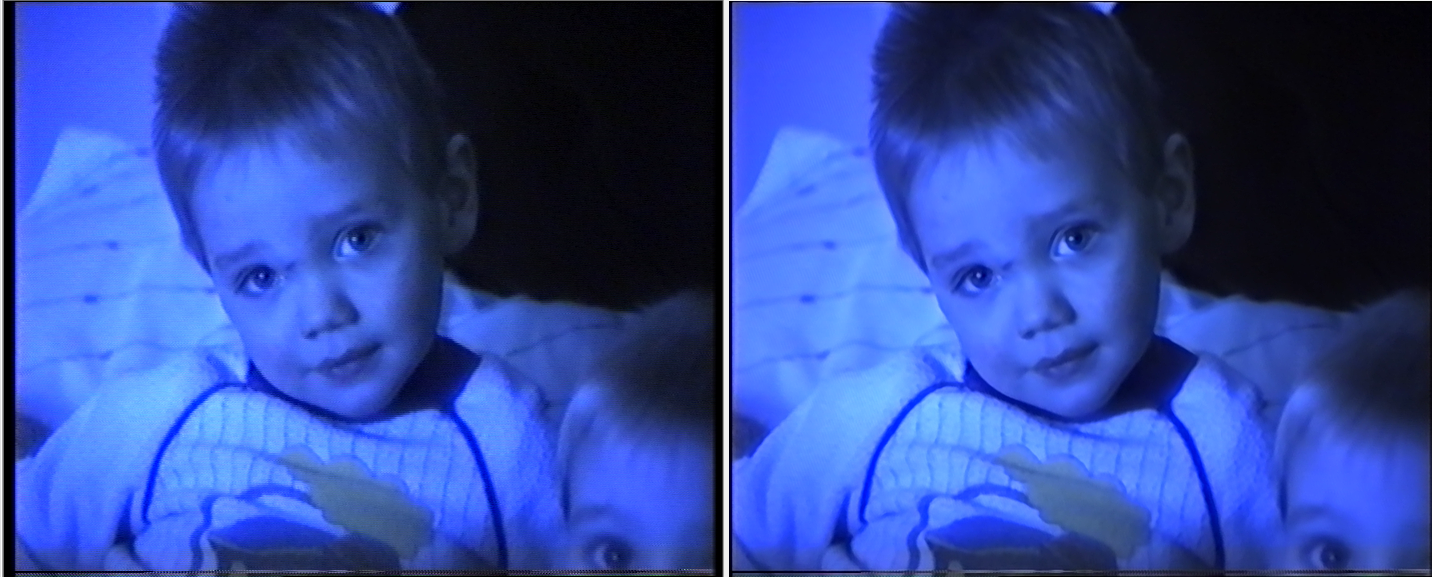

    And this is the comparison so far. Captured video on left (screenshot from VDub), and screenshot from AVSPmod on right after running my script (I temporarily commented out the upscale for this screenshot). How's it looking to you guys? Good detail/denoising/sharpness etc.?
    If you zoom in/go close to your screen, you'll see that the processing has introduced these diagonal coloured lines for some reason (look at the child's right arm and pillow) - what could this be? Just a natural part of QTGMC? (they are gone if I comment out QTGMC, but obviously I still want to perform deinterlacing). Closest I can get to replicating it is playing the original capture in VLC and turning on 'Linear' deinterlacing which gives similar diagonal lines.

    Noted about screenshots (not that it matters much for this comparison).
    Ignore the blue hue please - it's exactly the same on the tape itself. The rest of the video is fine, it's just the lighting in that scene. I don't plan on 'fixing' that.
    What's your thoughts on my code, my comments about sharpening, and final output image (ignoring the blue)? And the weird diagonal stripes that QTGMC has introduced? (I can get more output images of different scenes later)

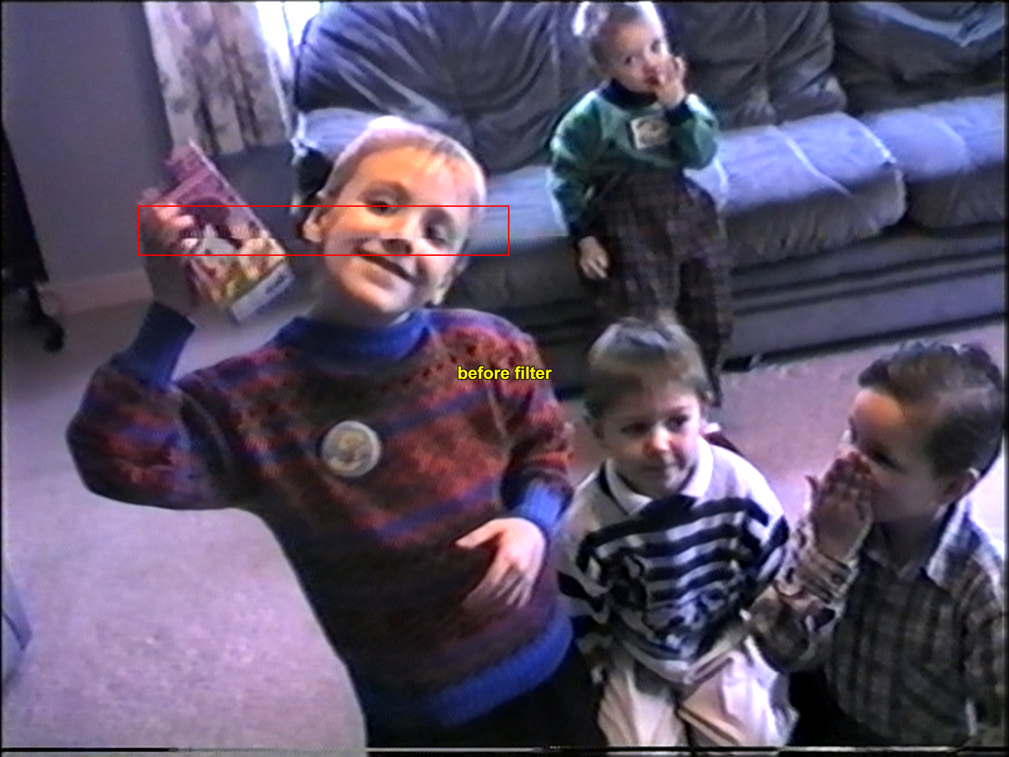

  6. ... and now stepping through it I discoverd some glitches, e.g. frames#139...142, frames#2826...2828, frames#3054... 3058 (is this what you meant by diagonal lines?).
    I think these glitches are tape errors rather than due to the capture process.
    [Attachment 90347 - Click to enlarge]

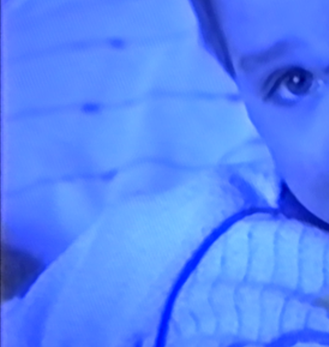

    Here's those diagonal lines up close. They only appear when I perform any kind of QTGMC (tried with just one setting, and tried with my current settings, still there. And they are not in every scene, seems to be no pattern, e.g. I thought they might only be in bright areas but they are not in every bright area. It's something I can live with tbh, as it's better than my raw capture. Just thought it'd be a common problem with an easy fix.

    Not a common problem.
    You could try adding after the resizing
    KNLMeansCL(d=1,a=2,s=4,h=0.8)  #play with the settings

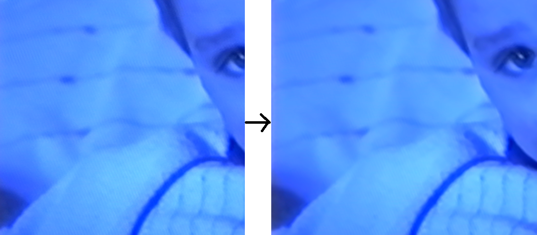

    I tried these settings which actually worked really well and has now done a good job at reducing those lines - they wouldn't be obvious at all now unless you put your eyes up to the screen
    KNLMeansCL(d=3,a=2,s=4,h=1.6) #Denoiser that fixes diagonal stripes on some areas
    Before and after:
    [Attachment 90349 - Click to enlarge]
    EDIT: The pic shows the denoise strength setting h=1.8 but I've since changed it to 1.6 as it was overblurring a tiny bit in some scenes.
    In fact, doing that has meant I was able to turn down the grainLevel of TemporalDegrain2 to it's lowest setting (from 1 to 0). So yes, I am essentially using 2 denoisers now, since I have now added KNLMeansCL after the upscale (but before the ConverttoYV12() which must be at the end right?). Is it normal to use 2 de-noisers like that?

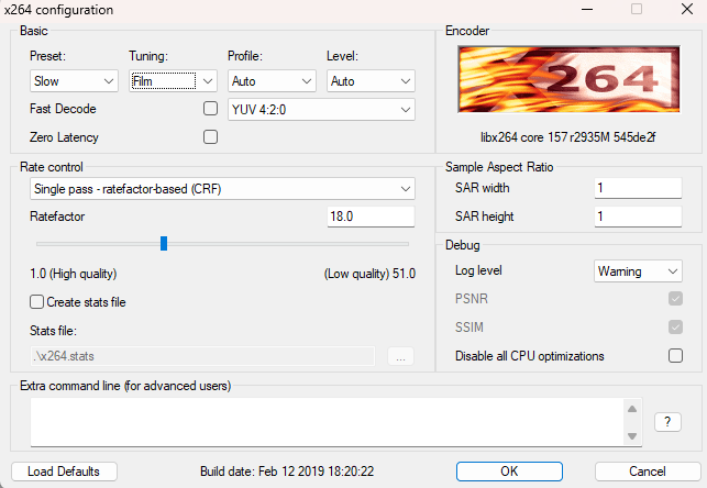

    I'll then save as a compressed MP4 using x264... unsure whether I should do that straight from my capture file + script processing again, or if I can save time and not run the script again and just re-encode that 'processed master' file?

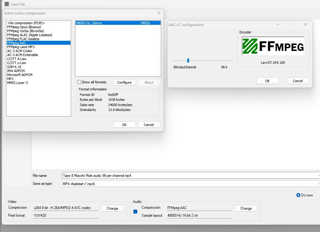

    Also with the final audio compression, is AAC 128Kbps bit rate and 48KHz sample rate pretty standard/acceptable?

    I would directly encode the script using x264 in .mp4 container, using a crf 18 for example as a reasonable compression compromise.

    AAC 128kbps is fine.

    Sorry for triple post but, are these settings ok for the video compression? Starting with CR18, and I chose 'Film' for tuning as per some google recommendations. My video is currently processing - this time with 1hour 40 mins estimated time instead of 10h!
    [Attachment 90419 - Click to enlarge]

    Also, was 'film' the right tuning option for x264?
  22. Originally Posted by WhiteboyUltima View Post
    There is no right or wrong here. Same with many other optimizations. I would probably set it to none.
    For info see the "tune" section in the x264 wiki which also lists and explains all the other x264 settings.
    http://www.chaneru.com/Roku/HLS/X264_Settings.htm

    I compared the x264 encoder with tuning set to 'film' and also set to 'none', and the difference is incredibly small. 'Film' seems to retain a microscopic amount more unwanted grain during encoding, including a tiny bit more of the unwanted diagonal lines. Not sure if it's keeping more genuine detail. It's such an insignificant difference that I'm second guessing myself. The resulting video bitrate is about 400kbps lower in the file with no tuning applied (I assume because it's keeping less grain/detail).
    I'm going to stick with no tuning for that ever so slightly smoother look in areas where you can see those diagonal lines, but it's really not much diff. In either case I've been using the 'veryslow' preset and CRF16. Very happy with the overall results.
    I still can't figure the audio bitrate out though. It keeps the 48000 KHz I specify just fine. But no matter what I set the bitrate, the final result is not what I set it to according to MediaInfo and Windows Properties. e.g. if I set 128Kbps, the result is 258Kbps, and if I set 192Kbps, the result is 257Kbps... strange.

    Thanks Alwyn - appreciate you replying on Christmas! I reckon the audio bitrate being 257kbps in my final file doesn't really matter, unless for some reason it won't play on some devices/software? And setting it to 96k doesn't guarantee a result of something 'standard' like 128kbps. Seems like there's no way to actually set it to something where you'd get a reliable desired output number - it's a bit random. I'd have to experiment for quite a while and wait 2-4 hours in-between each attempt, which isn't the best use of my time!
    That's my way of saying I think I'm actually done now with this tape (assuming my 257kbps file can still play on most devices)

  27. Member WhiteboyUltima's Avatar
    Nov 2025
    New Zealand
    No it's not. 96 per channel will give you exactly 192 total every time, unless your source file is corrupted or something is awry with your system. Merry Christmas!
    If that's the case then why did it result in 257kbps when I set it at 192kbps per channel? That's not double.
    I will try setting it to 96 per channel and see what happens...
  28. Member
    May 2005
    Australia-PAL Land
    Did another test, setting 192 per channel. I got:
    Bit rate mode : Variable
    Bit rate : 265 kb/s
    Maximum bit rate : 384 kb/s
    Channel(s) : 2 channels
    Setting 96 per channel, I got this:
    Bit rate mode : Constant
    Bit rate : 192 kb/s
    Must be a changeover at some point from Constant to Variable. That'd be why you're getting the "odd" bit rate.
    I've read anything over 192 total for VHS is overkill.
  29. Member WhiteboyUltima's Avatar
    Nov 2025
    New Zealand
    Bit rate : 265 kb/s
    Bit rate : 192 kb/s
    I can't find any way to change it to CBR or VBR, looks like it's doing VBR by itself and the final bitrate just depends on the audio of the tape in question. No worries, as long as it plays on most devices that's the important part!
  30. My best guessing is that Vdub uses the "native" FFmpeg AAC Encoder.
    Excerpt from the ffmpeg wiki:
    The native FFmpeg AAC encoder. This is currently the second highest-quality AAC encoder available in FFmpeg and does not require an external library like the other AAC encoders described here. This is the default AAC encoder.
    By default, the native encoder produces AAC-LC, which is a "low complexity" profile of baseline AAC. It actually supports the more powerful "main" and "long-term prediction" profiles (documentation), but these are less tested.
    This VBR is experimental and not guaranteed to give better results than the CBR. Native FFmpeg AAC Encoder does not really do CBR audio encoding. For Bluetooth Headphones an option was added to force CBR but that instead makes quality subpar (-bit_rate_tolerance 0).
    => If you want full control over the encoder parameters (CBR, VBR etc.) you would have to use commandlines or a script.
    In practice one most probably won't notice any quality difference for 1 or 2 channel VHS audio sources though.
    P.S. Device/playback compatibility: What "most devices" are and accept I don't know. Depends on the time axis as well. In general, the lower the profiles (settings) the more devices (including ancient) will support it......
