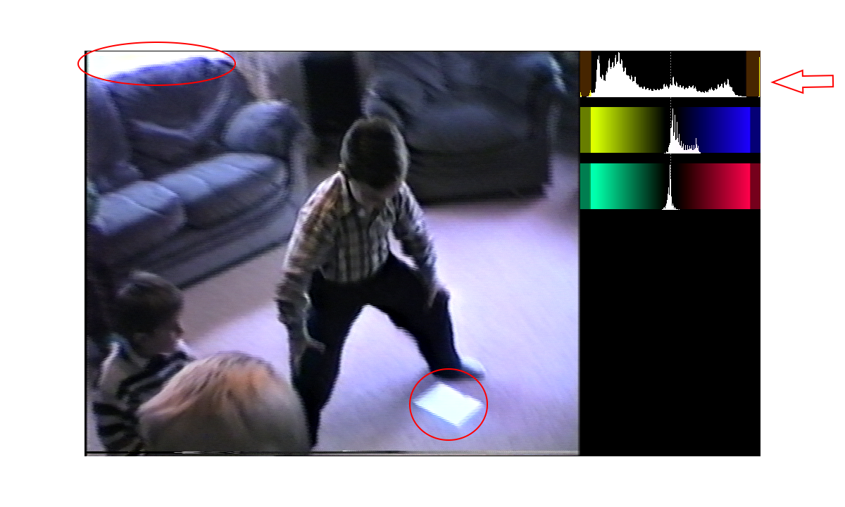

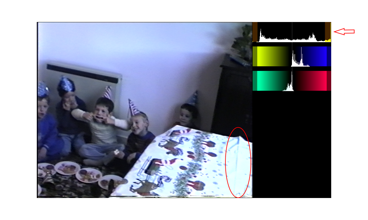

  5. The capture is correct interlaced YUV 4:2:2, TFF. So that's good. Congratulation. Your script is ok. You could add as last line at the end ConvertToYV12() for best encoder and playback compatibility. It converts YUV 4:2:2 to YUV 4:2:0 which is used by DVD's and BluRays.
    These indoor shots have difficult lighting conditions. Your capture has clipped/crushed brights where all details are lost and can't be recovered in post processing. I don't know how much this is due to the camera's overexposure or how much is due to the capture setup/settings. In a next step you may want to learn about your capture devices (GV-USB2, AFAIK) proc-amp settings and see if you can recover some of the brights. If the clipping is due to camera overexposure and burned onto the tape there is nothing you can do.
    Capture levels adjustment is another topic of its own. There are plenty of posts in the forum about it. I do it via AmarecTV and Avisynth's histogram and waveform monitor functions. However, user Alwyn has a guide how to do it in Vdub which you may find more convenient. Check it out. At this stage it's more important than fiddling with QTGMC settings or worrying about 5 digit 4:3 accuracy, IMO. No critism, just a hint. Keep an eye on it.

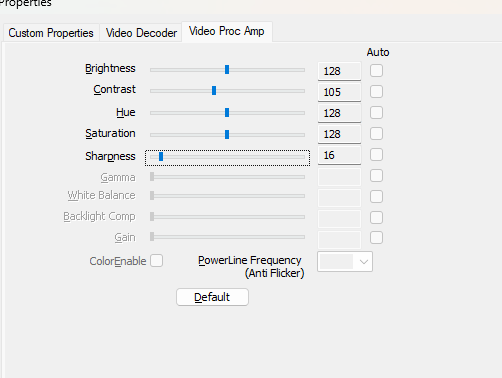

    ... then I will consider playing with proc amp settings (I just had them on default)
    Usually I have to reduce the proc-amp contrast by a few notches for the GV-USB2 to prevent clipping or having "too much" in the 236....255 luma range.
    These are the defaults - not sure what yours defaulted to (might vary by date, firmware, version etc.). As you can see (if I'm interpreting it correctly and 128 is the 'middle' value for most attributes), the contrast comes already slightly reduced, and a slight amount of sharpening is applied. Perhaps if I ever capture tapes again, I'll reduce contrast little more.
    [Attachment 90293 - Click to enlarge]

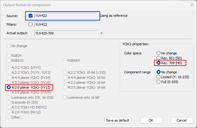

  14. Originally Posted by WhiteboyUltima View Post
    I'm leaning towards just doing both the colourspace conversion (to 709) and converting from YUV 4:2:2 to YUV 4:2:0 in VDub's Pixel settings, as per your screenshot earlier.
    That's fine. I would just check the "Source..." setting as well. It should be YUV422 for your script. I think Vdub sets it automatically though.
    [Attachment 90301 - Click to enlarge]
    Edit1:
    Hmmm.... now thinking about it, I am not sure whether Vdub really converts to 709 or only flags it as 709. If it just flags it should be left at 601, otherwise it gets wrongly flagged - or do the conversion to 709 in the script.
    Maybe someone more knowledgeable with Vdub may clarify this.
    Anyway, if it is wrong it is usually not catastrophic (for homemade VHS videos).
    Edit2:
    Doing a colorbar test indicated that it converts and flags correctly. So yes, select Rec. 709 (HD) as per screenshot if you upscale.

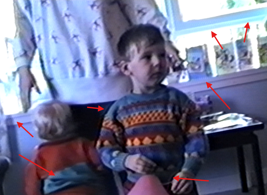

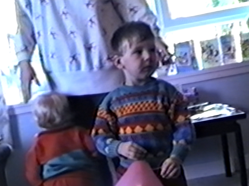

    I've been playing with the Sharpness= v.s. EzDenoise= settings in my QTGMC line for a while now, finding a good balance. Nothing is quite perfect, but I've found something that works a lot better than the default QTGMC settings. Are these 2 settings alone fine to play with or should I be doing more e.g. Alwyn's suggestions (TemporalDegrain2 to remove noise and LSFMOD to sharpen)? Really getting to the point where I feel out of my depth with so many plugins and fine tuning etc.
    The main issue to me right now is, there's some kind of 'signal' present on certain areas that I can smooth away (EzDenoise) at the cost of facial details etc. so I've just lightly smoothed it away to find a balance (see pic which has just a default 'Slower' preset, no other settings). There's also a few edge artifacts that the pic shows, on the child's hand and shoulder. Changing the preset to 'Slower' actually makes this signal worse - 'Fast' somewhat blurs it away so I've stuck with that. Is this the right approach?
    [Attachment 90329 - Click to enlarge]
    Here is my current QTGMC script for ref:
    QTGMC(Preset="Fast", SourceMatch=3, Lossless=2, Sharpness=0.2, MatchEnhance=0.75, EzDenoise=2, DenoiseMC=true)
    And here's the same frame with that script applied. Notice the 'signal' I'm talking about is reduced.
    [Attachment 90330 - Click to enlarge]
