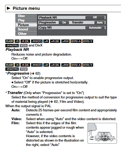

  1. Originally Posted by WhiteboyUltima View Post
    Thank you, I will try the Display button on the remote for DNR. If it does nothing I'll assume my unit doesn't do DNR (which is good).
    I don't have your model, but see the manual page 35 about Playback NR and Copy NR (NR=noise reduction) settings. (I would just set them to OFF.)
Name:	Screenshot 2025-12-02 203345.png
