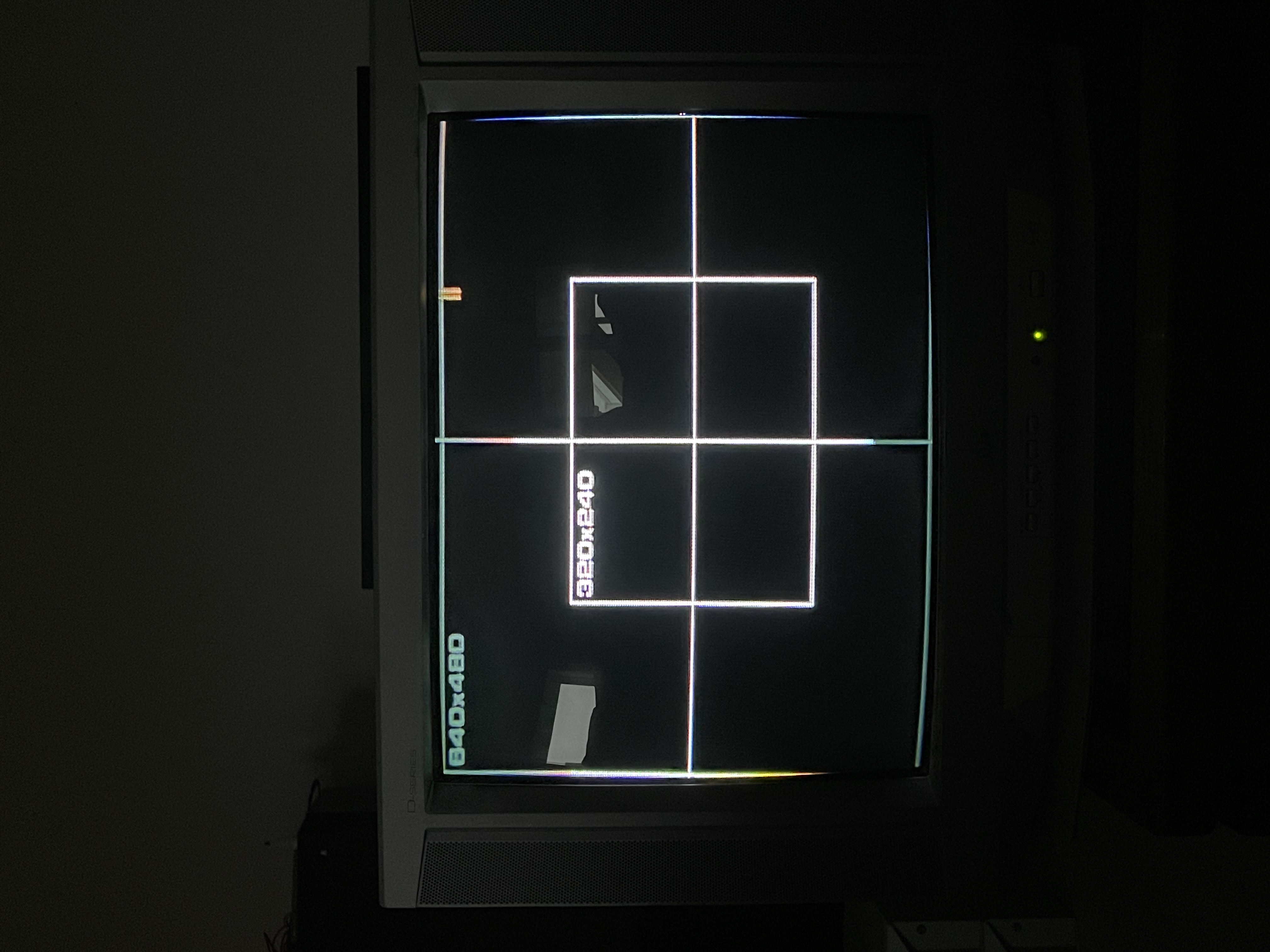

So I've dug out a device that does have the ability to playback USB videos and connect via composite (Mediasonic Homeworx HW180STB). I've connected that to my VCR, and the VCR to my CRT. So far everything works, except for the test video I've made. It consists of three boxes at 720x540, 640x480, and 320x240. The video does play, but the video seems to be cropped to 640x480. This is after I've set the Homeworx to 4:3 full at 480p. This raises the question, where is the weak link in this chain? I'm aware the Homeworx is rather garbage, but could anything else be the issue?
CRT TVs overscan the picture.
https://en.wikipedia.org/wiki/Overscan
The 720x540 source is probably being output as full screen (720x480 NTSC or 720x576 PAL) but the CRT is only showing the inner 640x480. -

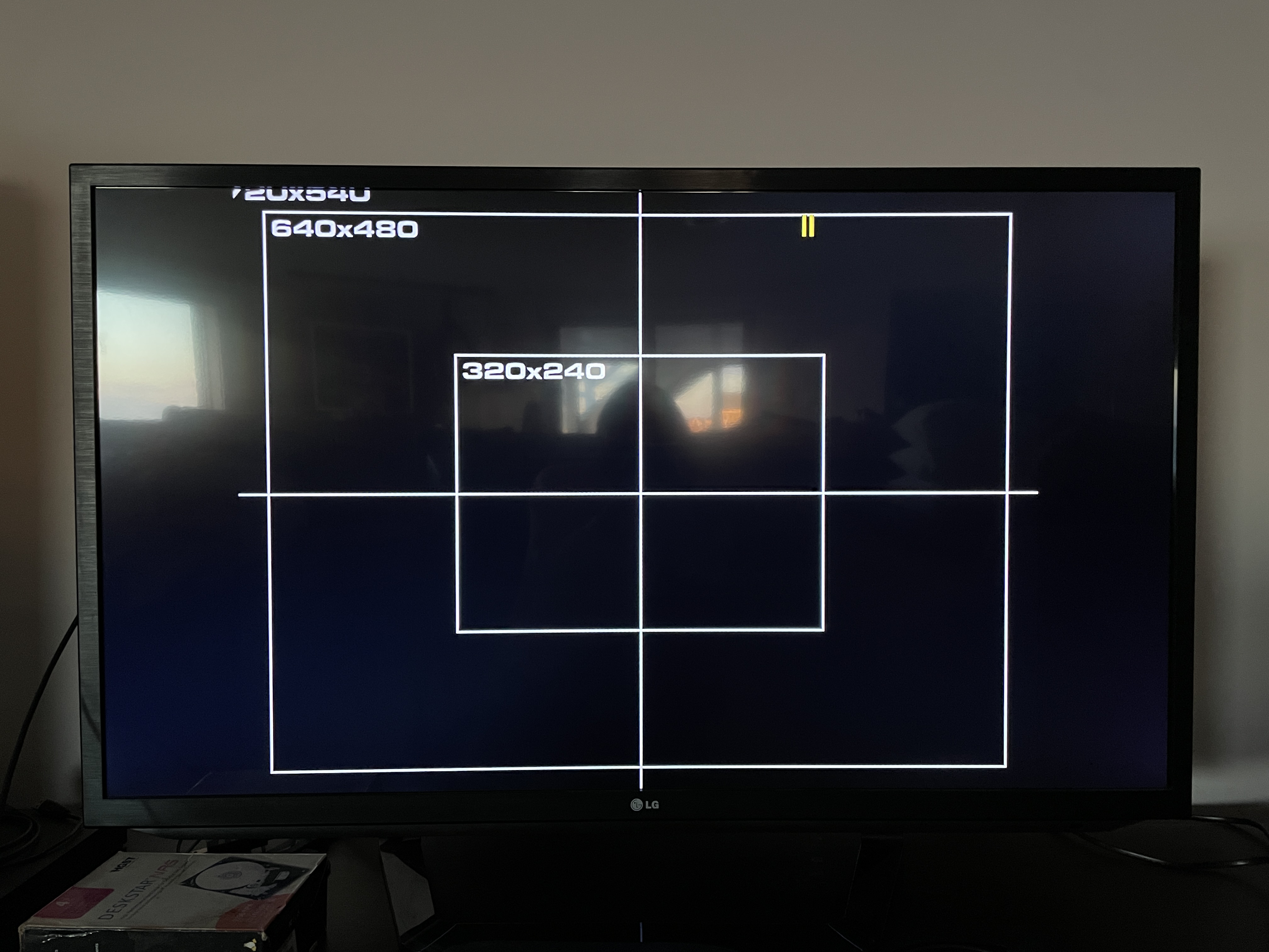

Would anything change if I said displaying on an average 1080p screen also does a similar thing? I set the LG to 4:3 and the Homeworx to 4:3 full, 1080p.
Modern panels have over scan too, unless it has the option "just scan" in the menu which disables over scan.
That changes nothing. Your player outputs all 4:3 source files as full screen 4:3 analog video. Your TV is hiding the outer edges of the frame -- just as all 4:3 analog CRT TVs did in the past.
As was pointed out by dellsam34, many modern digital TVs overscan too, by default. You may need to turn the setting off to see the entire picture. Every manufacturer uses a different name for the feature, things like Just Scan, Perfect Scan, Full Frame, Pixel-for-Pixel...
