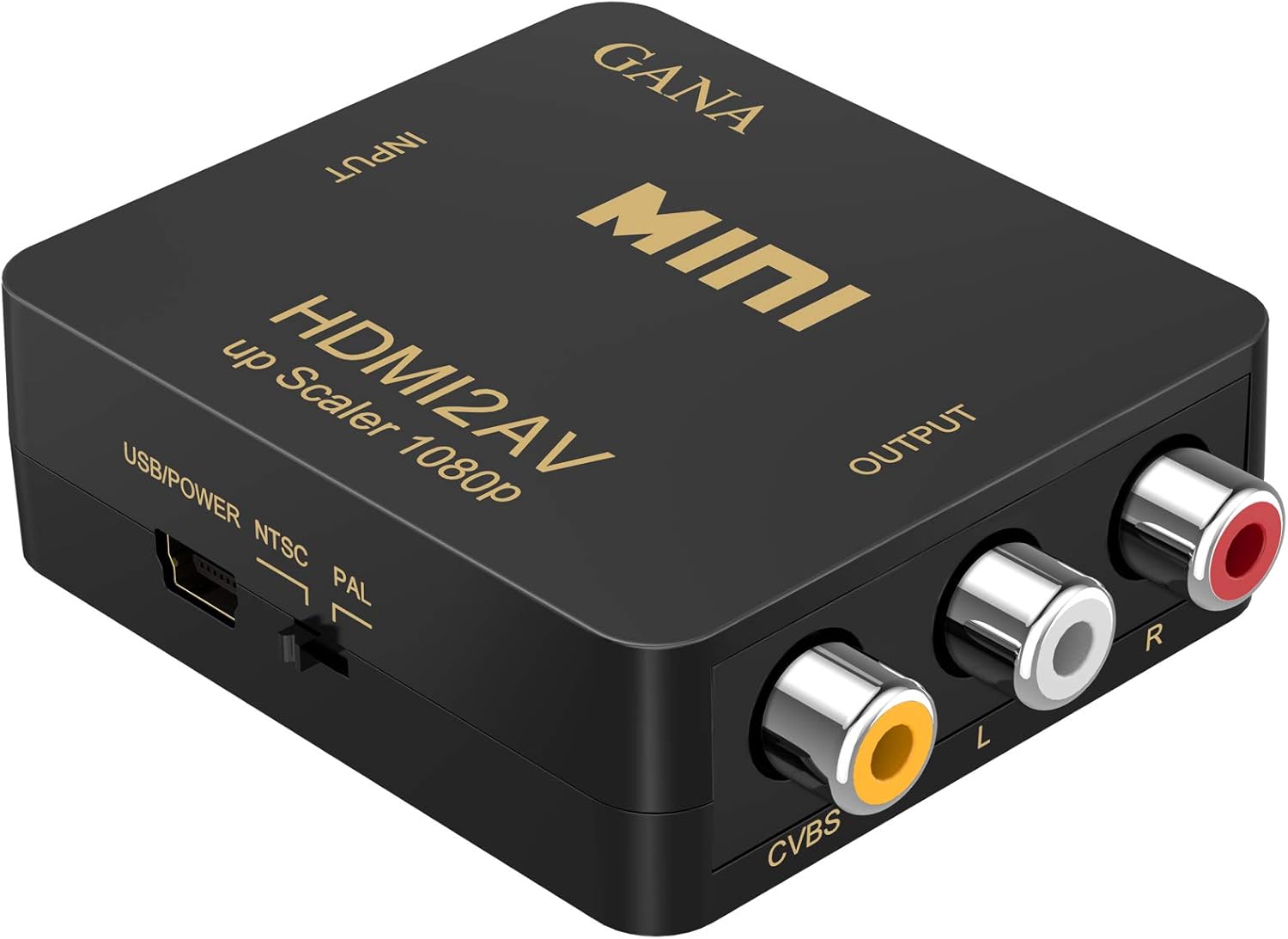

    I'd create a 640x480, 29.97 file, author it to a DVD with DVDStyler or your favourite DVD authoring program, then play the DVD to your VCR.
    or if top-quality isn't a major factor, use one of these to convert HDMI Out to Composite In to the VCR:
    [Attachment 87290 - Click to enlarge]
    Last edited by Alwyn; 4th Jun 2025 at 00:08. Reason: Posted while Dave was posting his! :)

    Stepping back to the start, if you're creating your own video content, you can avoid all this PAR stuff by building your content in a 4:3 frame that is 720x540. Then After Effects won't add any bars to fill it out. You won't have to worry about PARs DARs and SARs.
    Once you've built your content, export it as 720x540, add that to your DVD authoring program and burn it to a DVD. The files on the DVD will be DVD-spec, 720x480, but they will be displayed at the correct 4:3 DAR and should be sent to your VCR as, effectively, 720x540. If you're sending your video to your VCR via a gadget similar to the one I put above ie straight out of the computer, it would be safest to play the 720x540 file because the 4:3 flag might not get used by the converter and pass the video to the VCR incorrectly.
