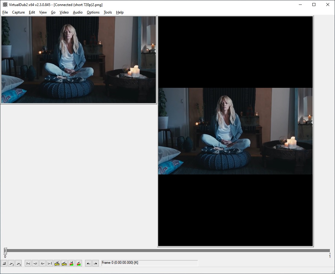

    You can pillar box top and bottom to satisfy the A/R,
    then you're left with a small image in the midde

    Dave, minor point, that's "letterboxing". The VDub filter uses that term too.
    Mar 2008
    touché !

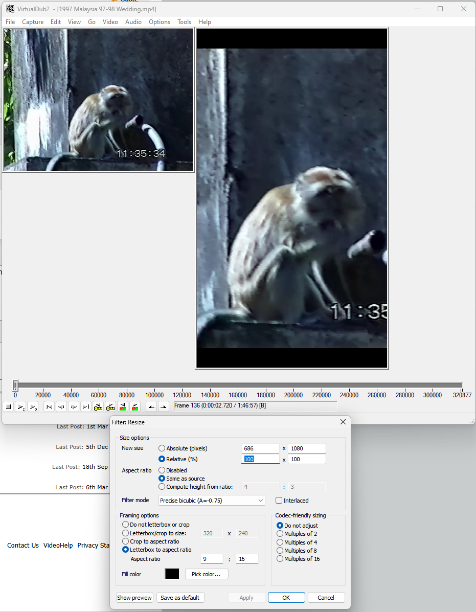

    @Muddy7, if you're familiar with VDub, use the Crop filter to crop the sides in (the more cropping, the "bigger" your video content will be). Crop to even numbers.
    Then, use the Resize filter to add top and bottom (letterbox) borders:
    [Attachment 87268 - Click to enlarge]
    If you don't want to crop at all, just go straight for the Resize filter as shown.
