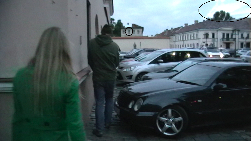

  1. After applying Levels through AviSynth on VirtualDub2, I’m seeing vertical stripes in my video. (These are not the same stripes I posted about on this forum five years ago.)
    Sometimes, in other processing videos, those lines do not appear. I’m also running several filters in a single AviSynth script: QTGMC, DeHalo, and Santiag. After Levels, I change the frame using SplineResize
    1 image: Captured with the camera lens cap closed.
    2 image: Enhanced so the vertical stripes are more visible.
    Any ideas on what could be causing this? Thanks in advance.

  2. Could be caused by:
    (Capture/GraphicCard) Driver issues.
    Improper luma-plane handling during resizing/sharpening/color conversion.
    You probably can get rid of them by lowering the luma resolution and then restore it.
    I'm pretty sure I saw this before somewhere on the forum.

  16. The script isn't causing the vertical stripes. It's just making existing stripes visible. Your VCR, cables, or capture device is causing them.
  17. Originally Posted by jagabo View Post
    Yes, I had stronger vertical stripes in my orig. footage before, and applied Santiag.
    But after Levels stripes seem to reappear, in a different form.
    Should I apply the same Santiag again?
    Those stripes are from my broken DV camera. I captured it directly from the DV camera using a FireWire cable with Windows Vista. I tried capturing with different DV cameras, but got the same result.

    vdub2 levels filter is not ideal because: does not work at higher bit depths , has no dithering options, and most importantly coring is permanently set to true - which can causing clipping of useful data
    For example, many DV recordings have usable overbrights in the 235-255 range. Typically they record 16-255. Clipping 0-15, 236-255 before you even do anything is a shame
    (A workaround for the clipping if you must use vdub2 levels filter is to interpret as full range in the decoding options ... but then the black point, gamma change more than they might need to. So you make counter adjustments and manipulations and that can cause more 8bit rounding errors and banding)
    Aug 2018
    Wrocław
    Because these lines are in the source file, you're only brightening the ones that slightly exceed the limit (luma=12). Use this instead of Levels:
    ApplyGradationCurves(lumapoints="0,0,12,16,255,235 ")
    http://avisynth.nl/index.php/GradationCurve
    Maybe it would be a good idea to denoise the source file as well.
    And once saved as a limited range file and played correctly, these lines wouldn't be visible. It's hard to judge without the source file.
    That won't work -- those lines are already in the compressed file you have on the miniDV cassette. It would probably be better to copy it through the AV output, but that would result in lower overall quality.

  23. Just to inform everybody and ask for more help:
    I tested a different camera - an HD rather than DV.
    After applying Levels, the same vertical stripes appears, even though that camera previously showed no defects.

    The data is correct, and using a different camera won't change anything, as it's digital data. I've described what can be done above.

    I gave it a try, but I’m not getting results comparable to Santiag.
    I’m attaching two screenshots and the two AviSynth+ scripts I used for reference.
    In my tests, I still noticed vertical stripes (most visible in the marked areas), whereas Santiag reduced them more.
    If you have any suggestions or tweaks I could try, I’d really appreciate it.

    yes santiag:
    FFMPEGSource2("1.avi", atrack=1)
    QTGMC(Preset="Very Slow", SourceMatch=3, Lossless=2, Sharpness=0, Sbb=0, MatchPreset="Very Slow", NoiseProcess=1, NoiseRestore=0, NoisePreset="slow", StabilizeNoise=true, NoiseTR=1, NoiseDeint="true", Sigma=2.0)
    santiag(strv=3, type="nnedi3", nns=4, threads=0, nsize=4, halfres=false, scaler_post="LanczosResize")
    Spline64Resize(1024,576)
Name:	rgr - Copy.00.jpeg
  26. Member
    Aug 2018
    Wrocław
    A trade-off. In the second one, however, you can't see the bars on the windows. Besides, the sky is overexposed, so you need to adjust the luma range.
    And on many edges things went wrong.
